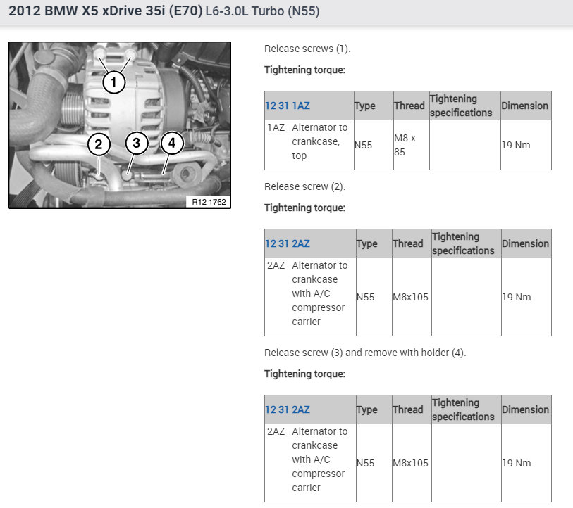

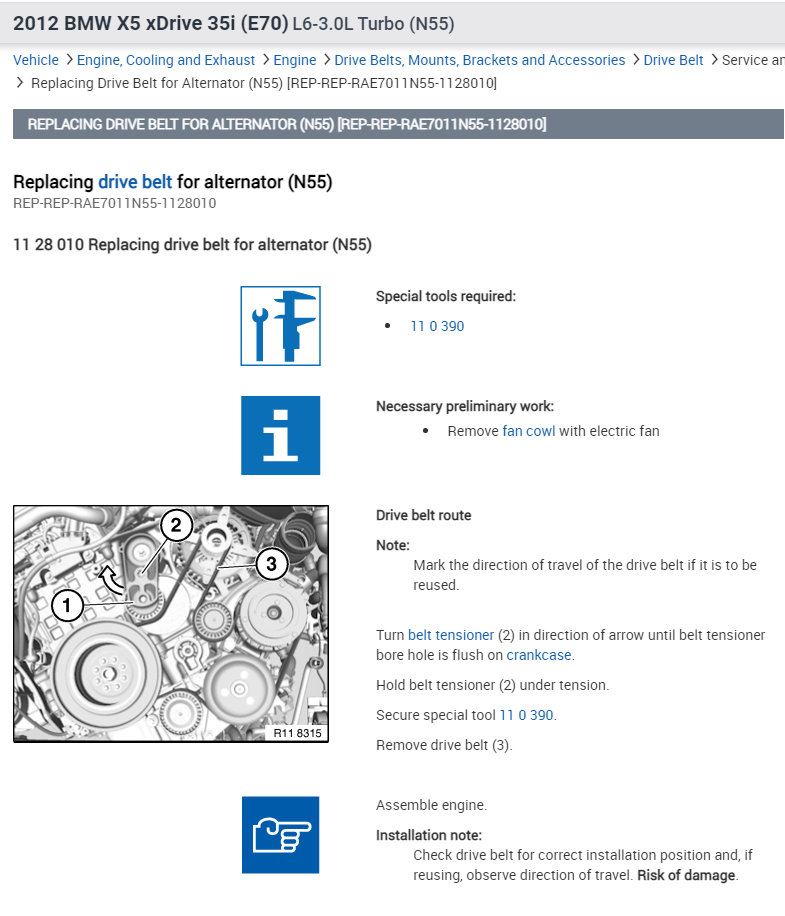

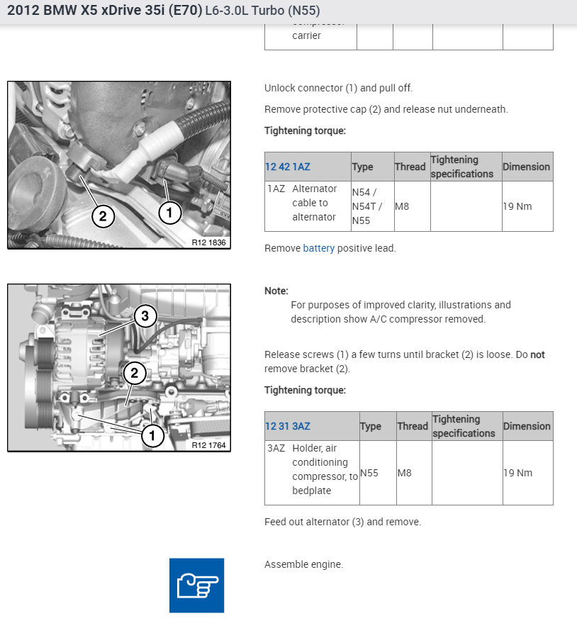

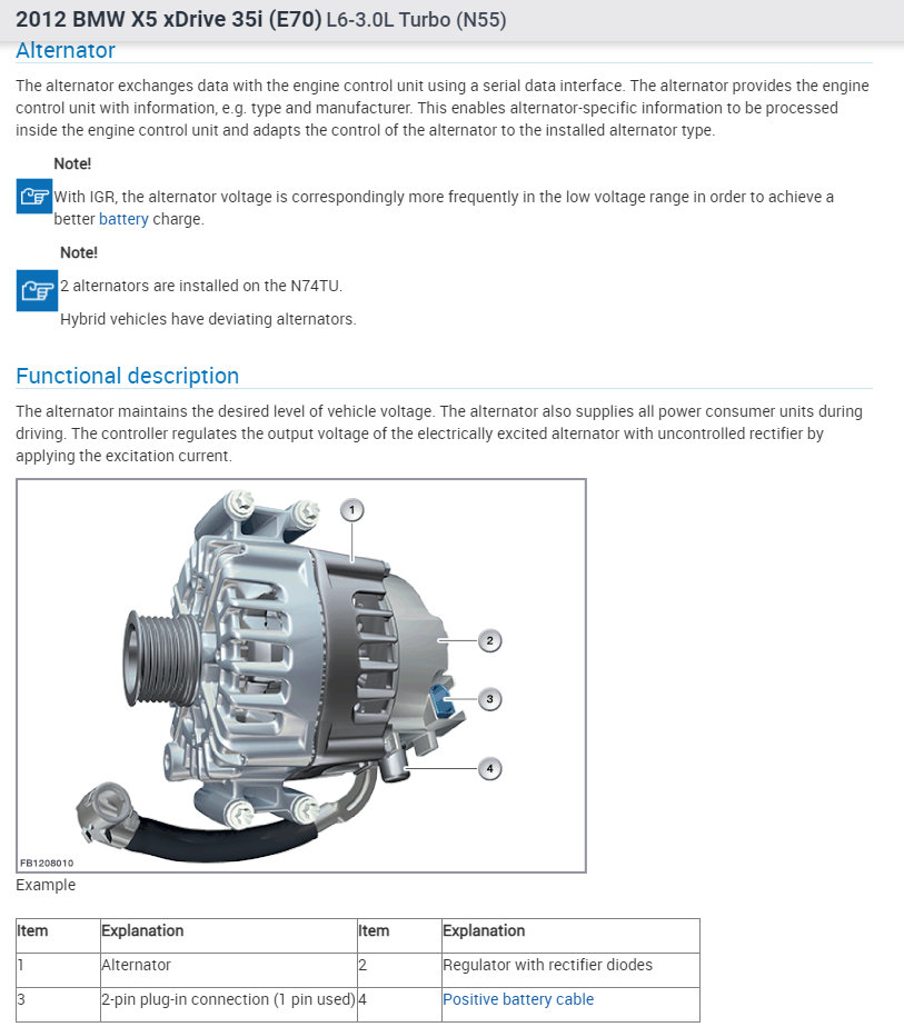

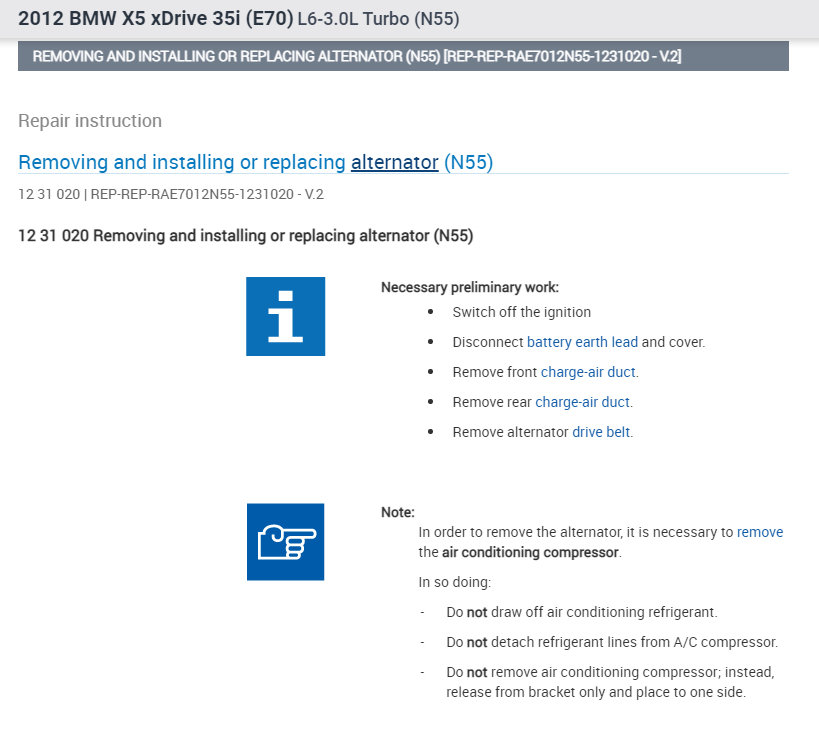

Replacing alternator and have had a hard time with this. It would be the best Christmas present if you could please give me the belt diagram. Thank you
Dec 25, 2021 at 4:05 AM
SQM
  • 6,383 POSTS
Look below for the belt replacement procedure and the diagram.
Also included the alternator replacement procedure just in case you are looking for that as well.
