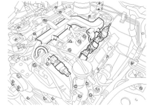

1. Remove the LH exhaust manifold assembly.
2. Supporting the engine with a safety jack, remove the LH side engine mounting bracket.
pic 1

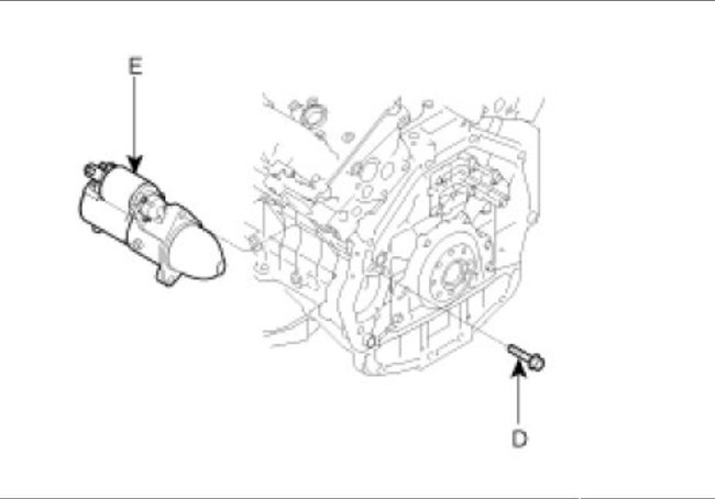

3. Disconnect the starter cable from the B terminal on the solenoid, and the connector from the S terminal.
4. Remove the 2 bolts (D) holding the starter, then remove the starter (E).
TORQUE :
49.0 - 63.7 Nm (5.0 - 6.5 kgf.m, 36.2 - 47.0 lb-ft) - starter mounting(D)
pic 2
5. Installation is the reverse of removal.
