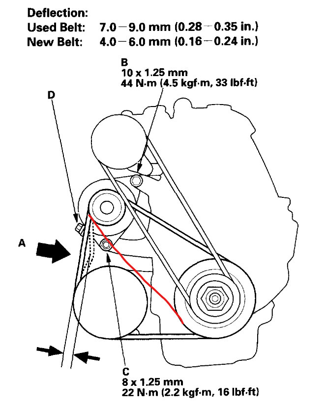

A/C compressor going out is there any way to bypass the A/C conversion with a shorter serpentine belt.
Nov 6, 2023 at 9:18 AM
  • 55,770 POSTS

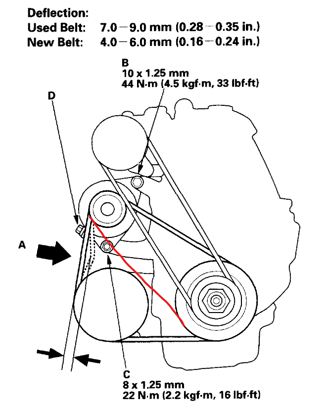

Yes, there is, I would get an alternator belt without A/C and install it. Please let us know the size of the belt that works so it will help others. Check out the images (below). Please let us know what happens.
