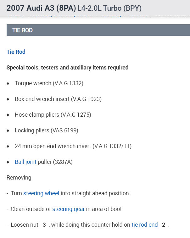

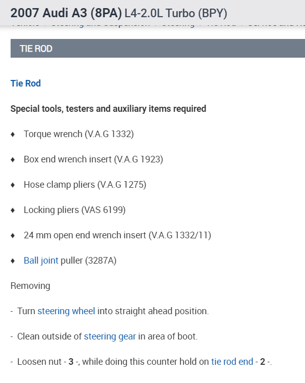

Play on steering, the MOT advisory was track rod end ball joint has slight play?
2007 AUDI A3
115,000 MILES • 2.0L • 2WD • AUTOMATIC
MIZZMAZZ
The track rod end has been replaced but still slight play on steering. Does the ball joint need replacing, also? Are track rod ends and ball joints 2 separate parts?

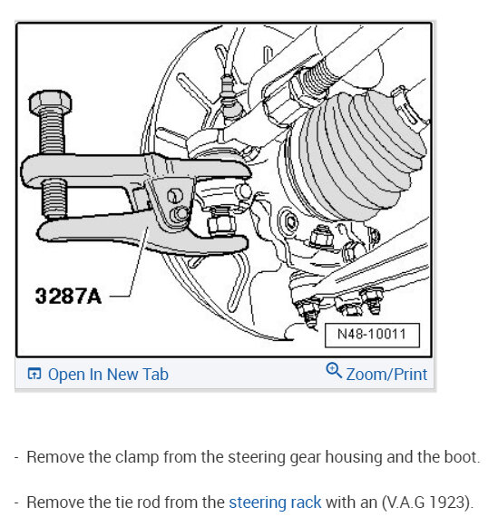

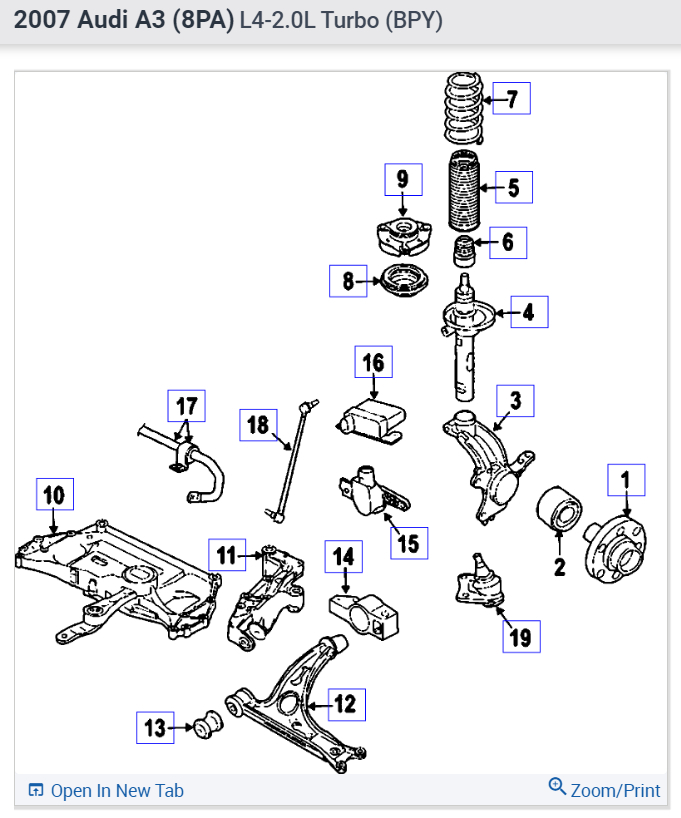

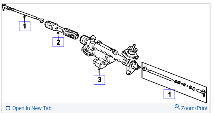

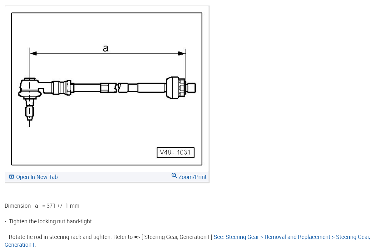

Track rod is throwing me off a little, I am not sure what you mean. here is an exploded view of the steering and suspension can you. please let me know what part they are talking about. Check out the images (below). Please let us know what you find.
Aug 16, 2023 at 5:23 AM
MIZZMAZZ
Tie rod end is another name for it. Sorry I don't have a clue from the images.

Sure, here is a guide and video which shows the job being done on a similar car with instructions for your car in the images below:
https://youtu.be/rBP2UKYtIl0
and
https://www.2carpros.com/articles/tie-rod-end-replacement
Check out the images (below). Please let us know if you need anything else to get the problem fixed.
