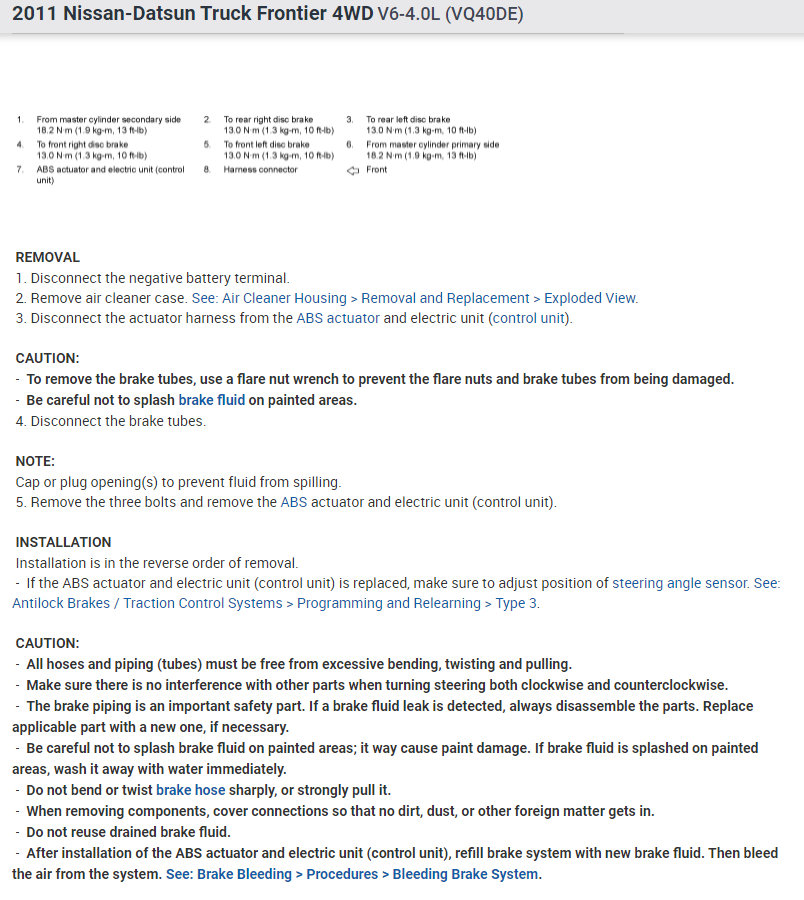

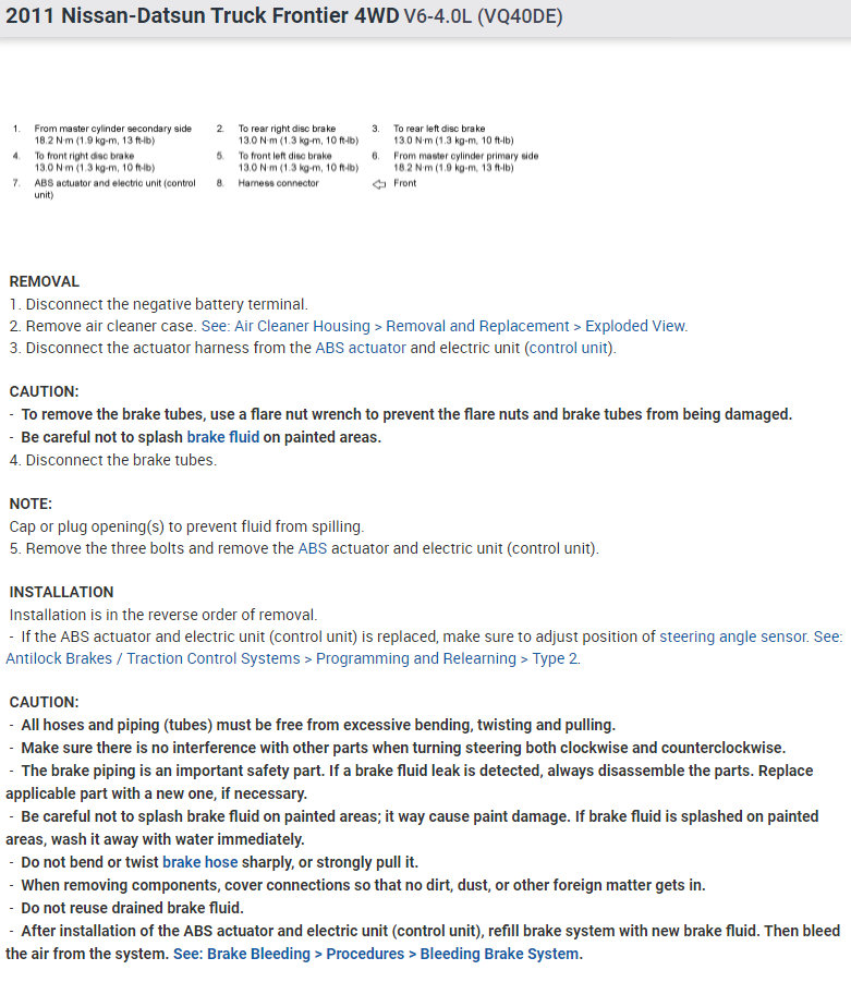

I noticed for the first time today that my ABS light is on I took it in they say I need a new ABS unit Thanks.
Nov 14, 2013 at 1:21 PM
SQM
Experienced Mechanic
6,383 POSTS

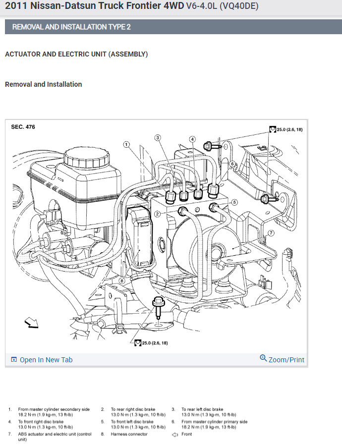

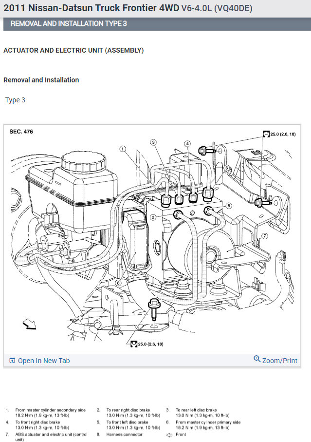

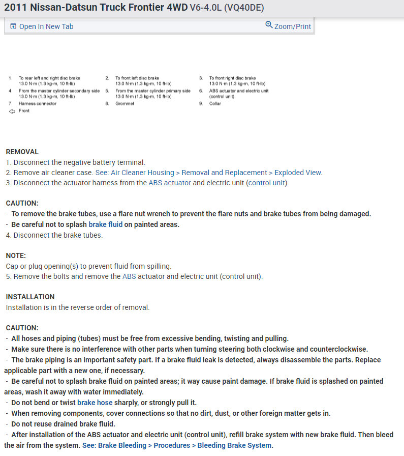

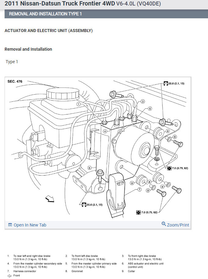

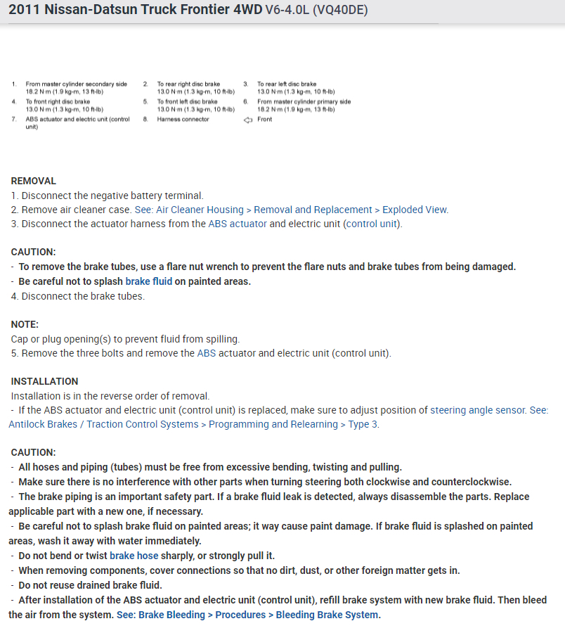

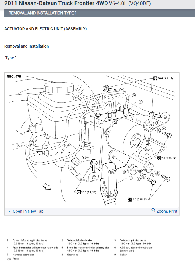

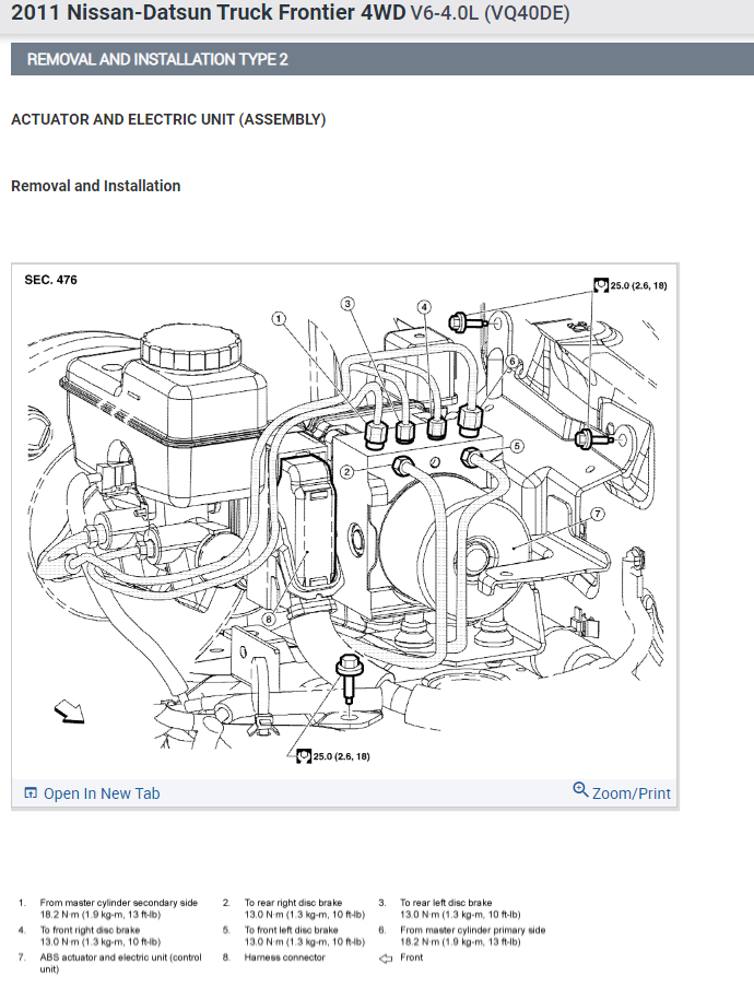

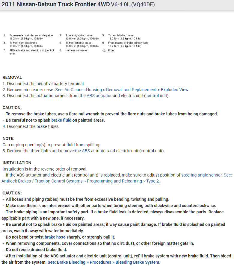

This style frontier could have had three different styles of ABS module. I have attached replacement instruction for all 3 (look below).
Here are couple of helpful articles:
https://www.2carpros.com/articles/how-to-replace-a-abs-controller
https://www.2carpros.com/articles/how-to-bleed-or-flush-a-car-brake-system
