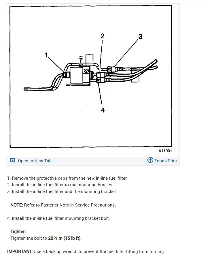

Placement of the feed line and return line on my three line in-line fuel filter?
277,450 MILES • 3.8L • V6 • 2WD • AUTOMATIC
ESTEVEN

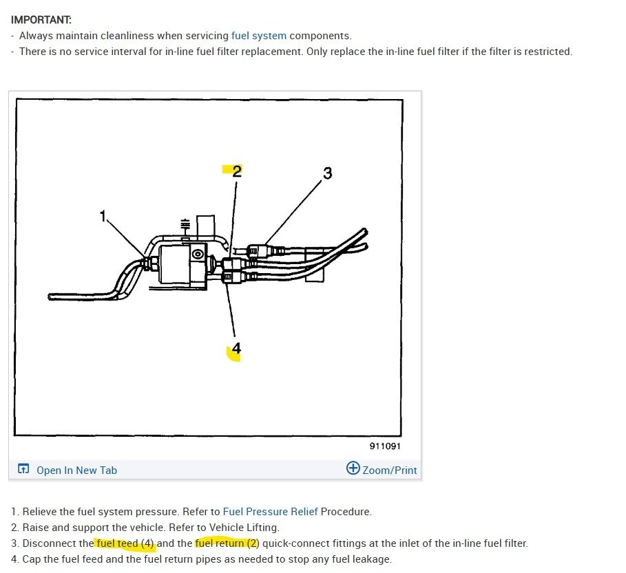

Just need to know what goes to wear on my three line in-line fuel filter which one is the feed, and which one is the return.
Jan 31, 2025 at 1:17 AM
AL514
  • 5,687 POSTS
Hello, there is a diagram showing which lines are the feed and return, Ill post that, as long as you know which lines each of those are. I'll post this diagram for you.
Jan 31, 2025 at 5:20 AM
AL514
  • 5,687 POSTS
Hopefully this will help.
