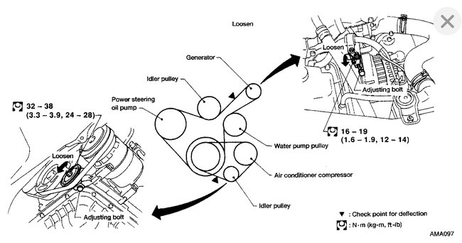

top belt placement.....does it go on top of water pump pulley.... or bottom?
Aug 21, 2019 at 7:32 AM
SCGRANTURISMO
  • 4,897 POSTS
In the diagrams down below I have included a diagram of the drive belt for your vehicle. Please go through this diagram and get back to us with how everything turns out with your installation of the drive belt on your vehicle.
