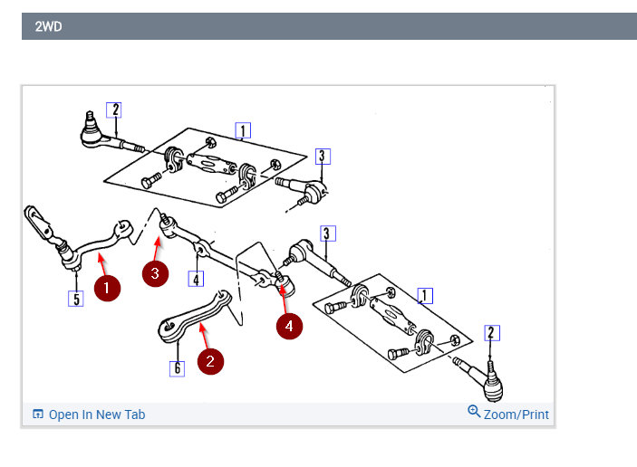

Here in Texas, you have to have an inspection done on your vehicle every year. My pickup has always passed every year until this week. I was told that i need to replace the pitman arm and the idler arm before it can pass this year. Can you tell me step-by-step how to do these repair? Thank you.
May 21, 2020 at 11:40 AM
It is not too bad but we actually don't have a manual on this. They just don't list the step by step in the manual which is not uncommon on older vehicles like this.
Keep in mind you need an alignment after you do these arms.
Here is a video of the idler arm. He shows how to unhook the the pitman arm but not replace it. To replace it, you need to use a two jaw puller and pull it off the steering gear.
https://youtu.be/gn8WHGR3mhs
Let us know if you need more info and we can dig deeper. You can find some more DIY videos online for this but I didn't link them because they are pretty amateur. Thanks
