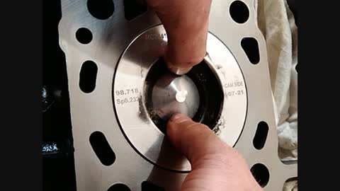

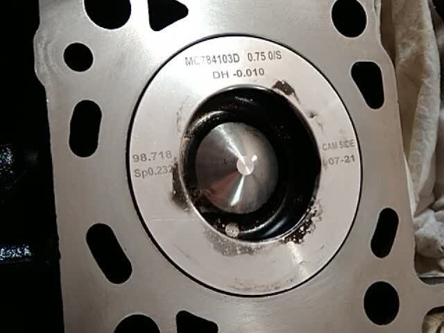

I bought a remanufactured long block to replace the existing engine because of a broken piston. The new engine had several valve train issues, and I went round and round with the warranty company and they decided to send 2 new heads and claimed they would reimburse me on gaskets and valve train parts If I purchase them and send them the bad parts. While I was cleaning the block for the new gaskets, I wiped off the pistons and noticed they move. I don't know what the acceptable movement is, but it looks excessive. I checked the bore at the top of the cylinder and IF the pistons are new and I am reading the numbers right they should be fine. I only drove the truck about 26 miles with the new engine and the warranty company is giving me trouble and I don't know if removing the piston to measure the skirt would void the warranty but maybe you can tell from this video if it's an acceptable amount of wiggle.

Trouble sending video I think. Here it is.

I'm not sure how I would get a feeler gauge past the piston rings but if .03 inches of side-to-side movement looks normal for the crown then I guess it's not an indication of excessive clearance at the skirt?

In other words, is it normal for the piston wiggle/clearance at the crown to be 10 times greater than the clearance at the skirt?

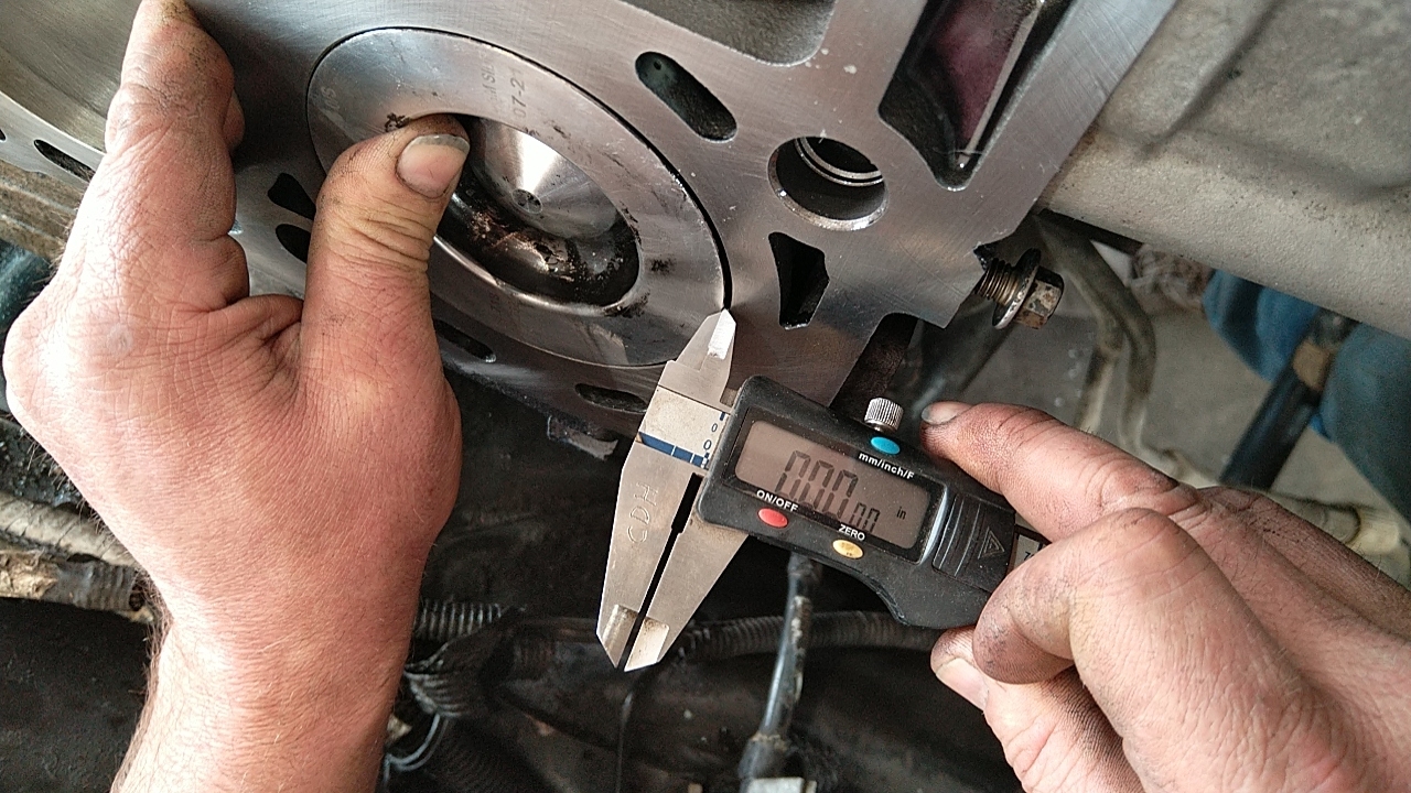

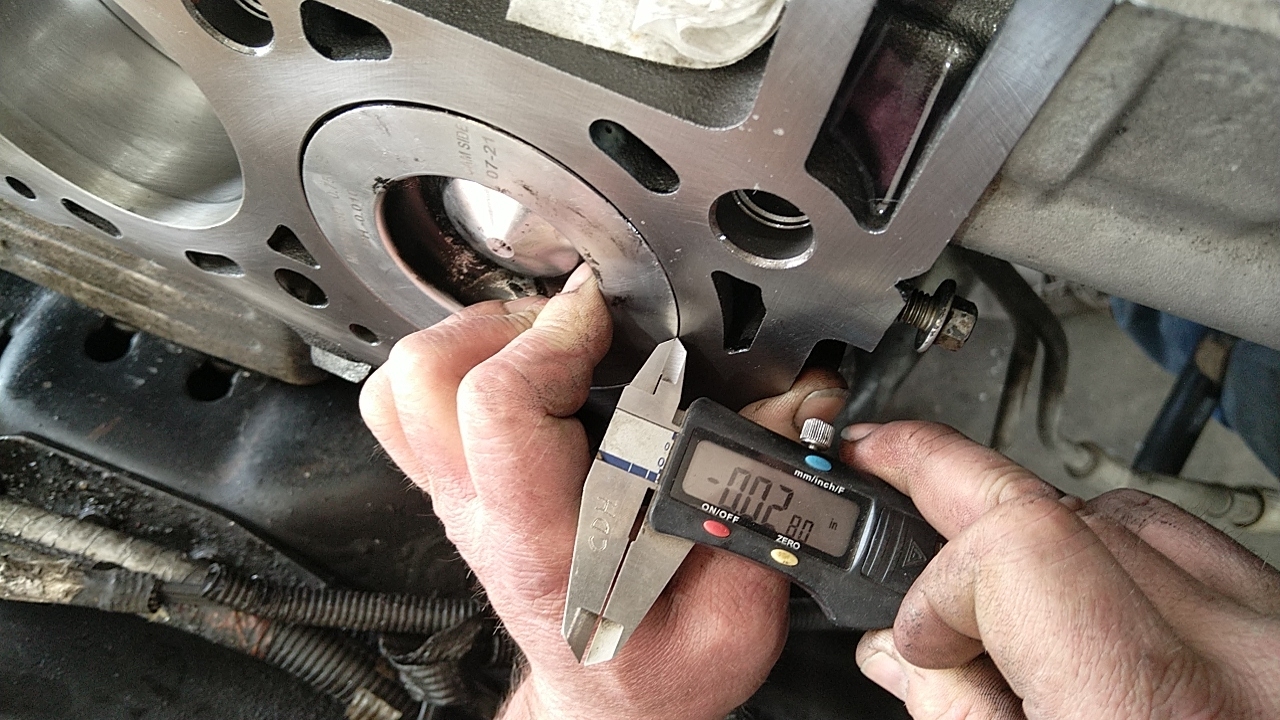

In picture 1 I slid the piston to one side and zeroed the caliper.
In picture 2 I slid the piston to the other side for a negative measurement.

  • 55,214 POSTS
Yep, that is within spec, to be sure you can call the engine manufacturer and they can help confirm the issue as well.

Thank you for your help. I did remove the piston and measure it, the ring gap and the bore and found that it was just outside of spec. but I had a mechanic who has worked on lots of 6.4l engines look at it and he said it is normal to go a little over spec. on piston clearance when rebuilding these.
