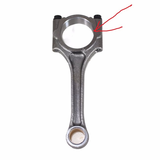

Unfortunately when I search on car-parts . com nothing would come up. I search the areas you recommended as well. What I need now is just a single piston for my vehicle because the connecting rod were damaged. I got a good one the other day from scrap which just leaves one more.

This is what i actually need. The rings of two pistons were damaged. I like i mentioned i got a good one the other from scrap with only leaves on piston left and im good to go but the problem is finding a matching one in the country. Sorry for all the back and forth guys.
Sep 30, 2017 at 9:08 AM
  • 55,402 POSTS
No problem, you cannot get just a rod cap because they are matched to one another, even if you find one it wont work because the cap will be off from the rod. If I am understanding you correctly.

Good to know. So then I will need to get the entire piston and not just the rod. Thanks
