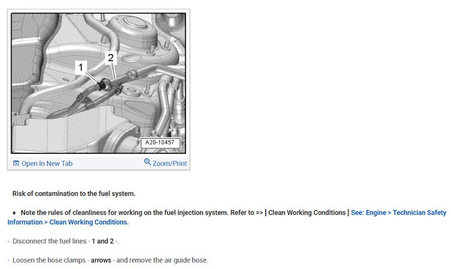

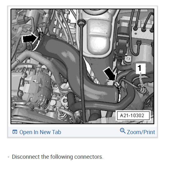

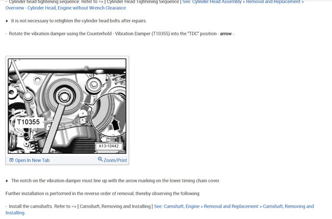

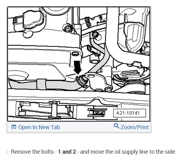

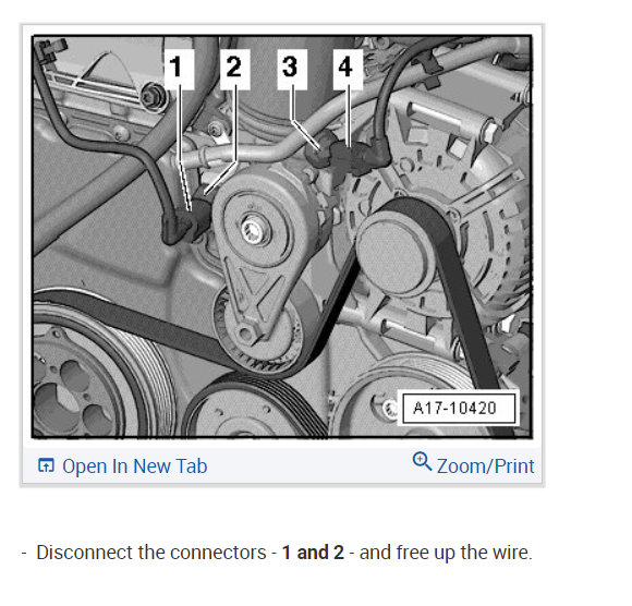

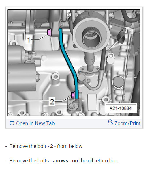

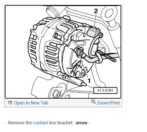

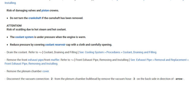

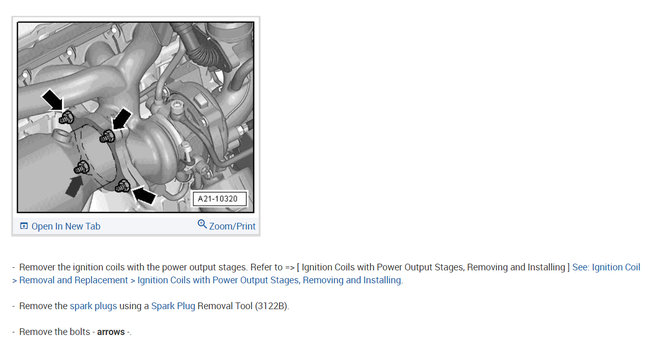

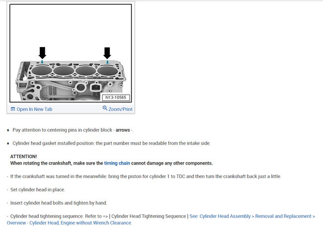

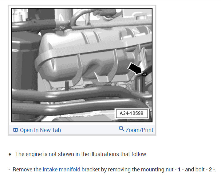

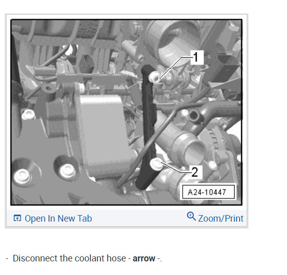

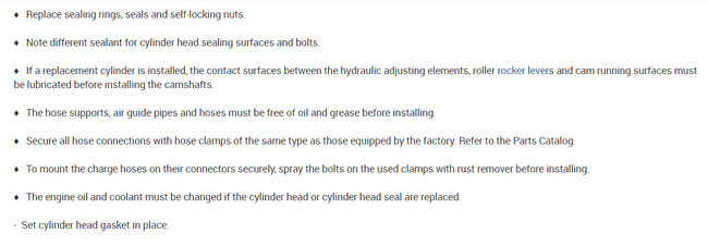

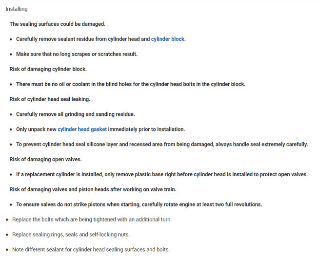

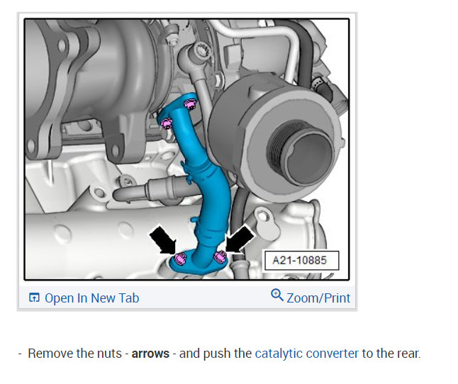

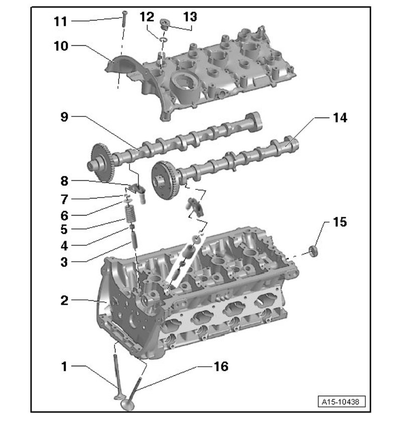

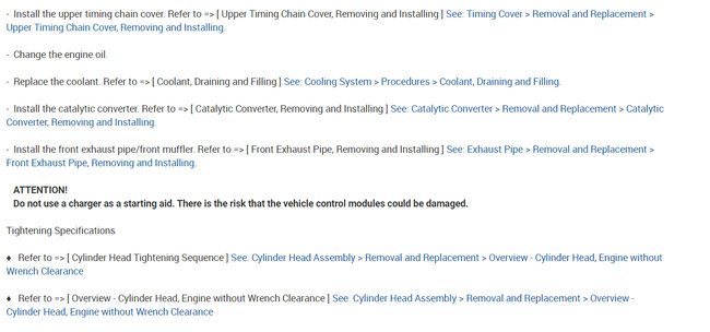

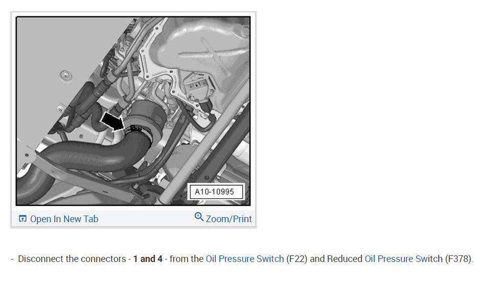

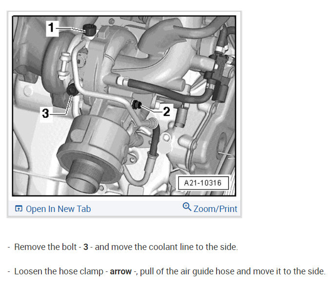

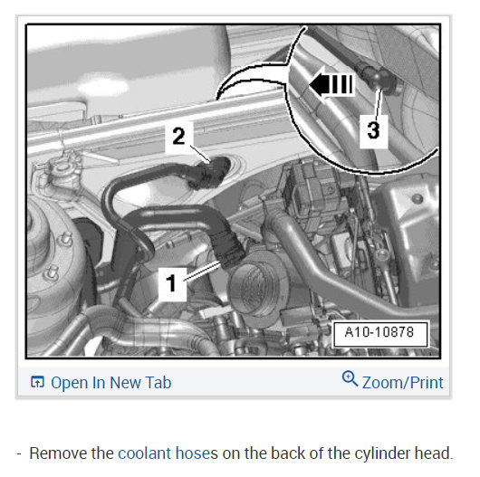

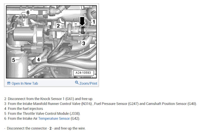

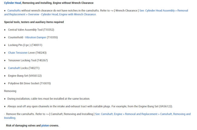

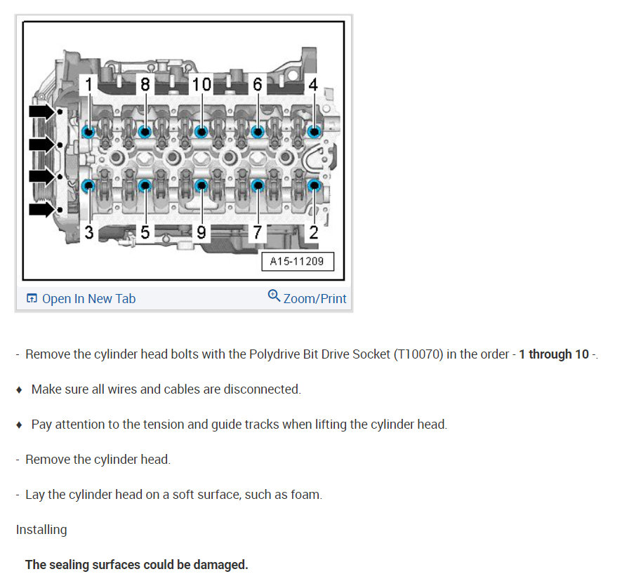

Is it only has 100,000 on it I would start by removing the cylinder head to see if any of the valves are leaking, you can also find out more by having a leak down test done which puts pressure into the cylinder to see where it is going. A valve job may fix it. Here is how to remove the cylinder head in the diagrams below. Check out the diagrams (below). Let us know what happens and please upload pictures or videos of the problem.
