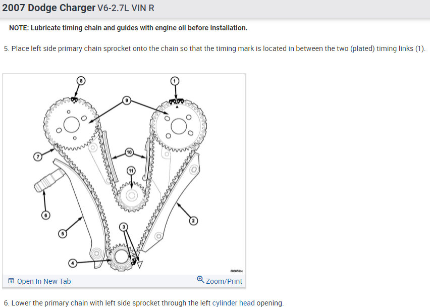

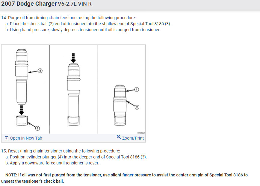

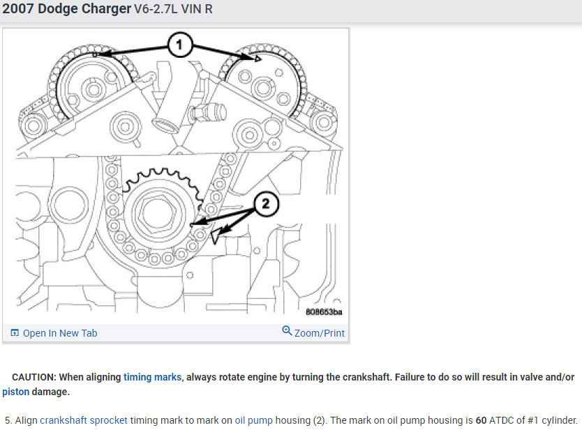

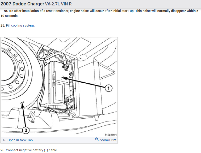

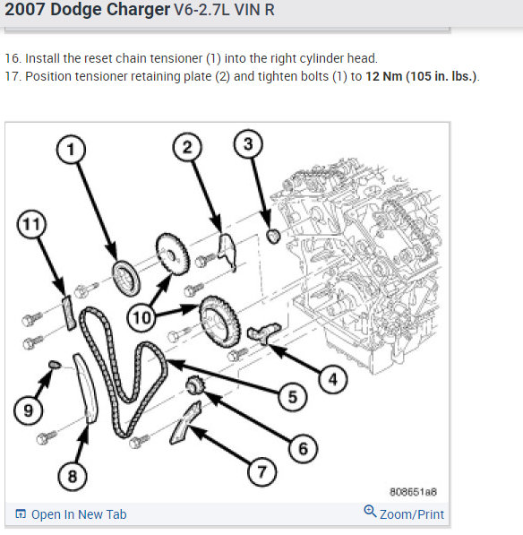

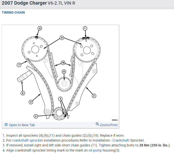

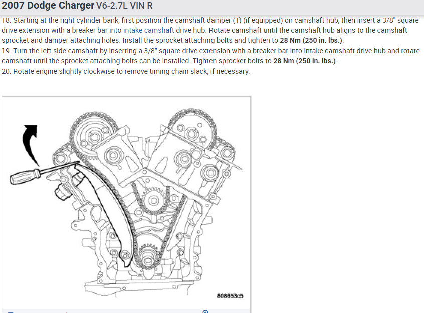

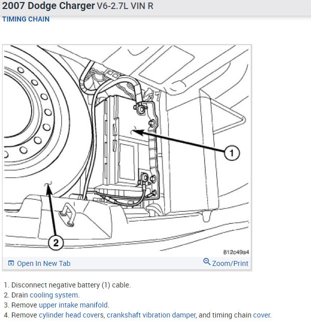

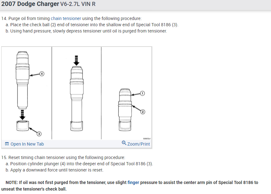

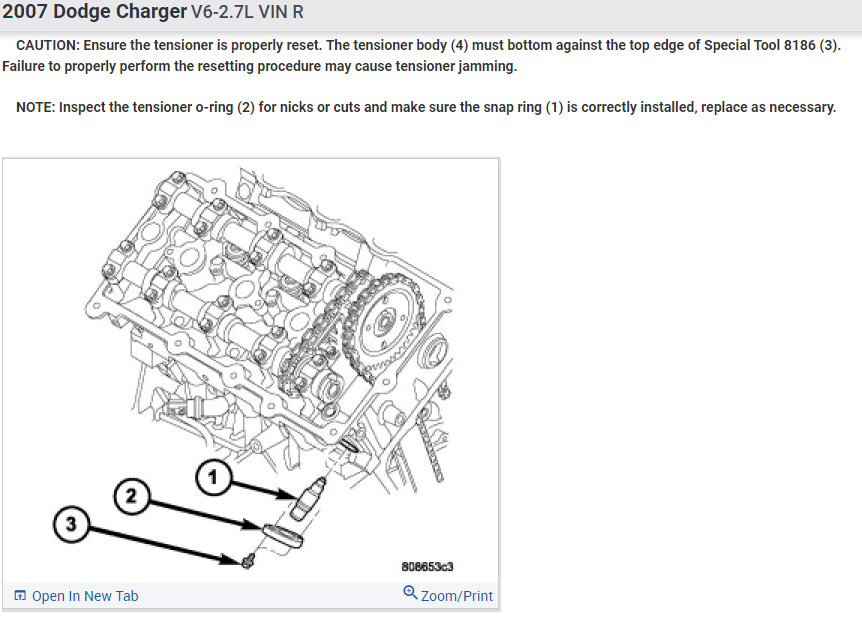

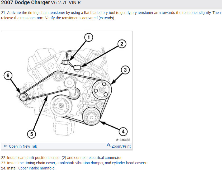

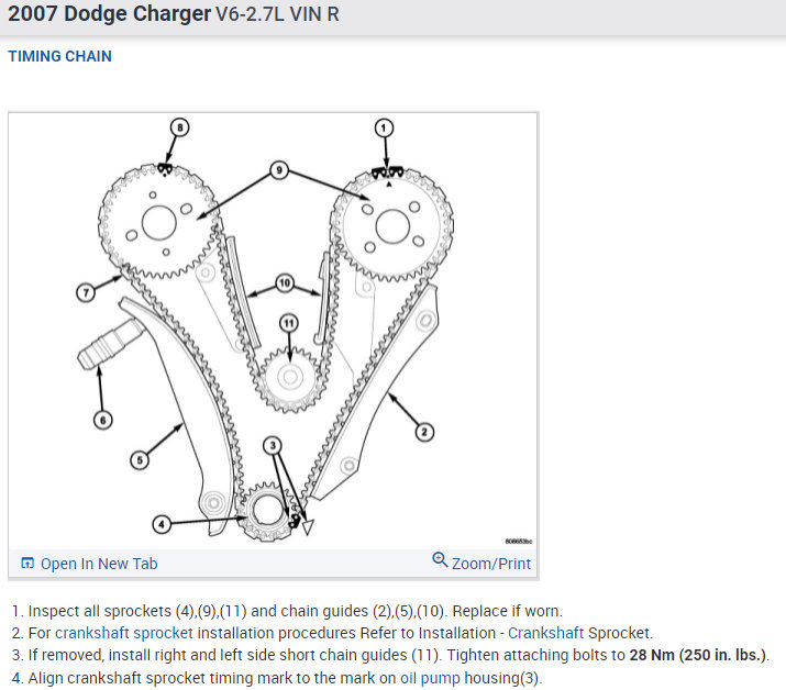

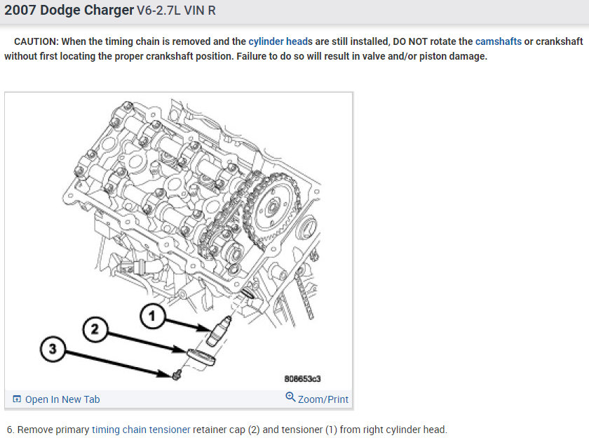

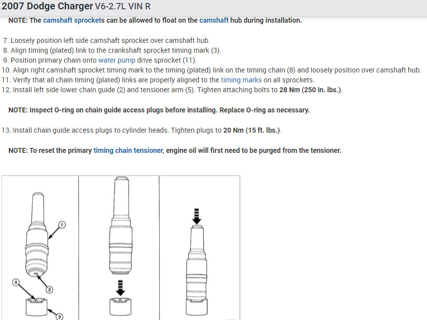

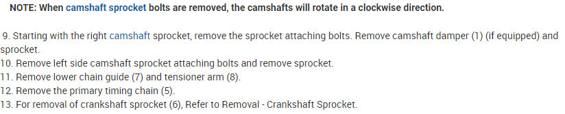

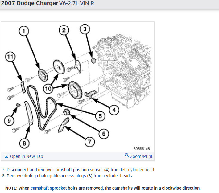

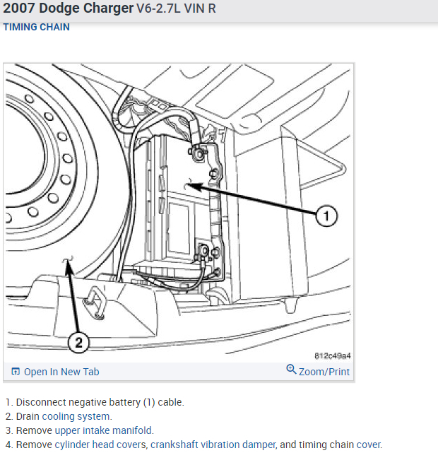

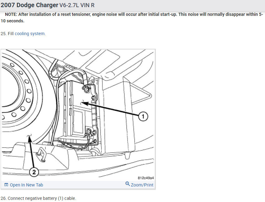

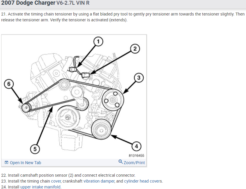

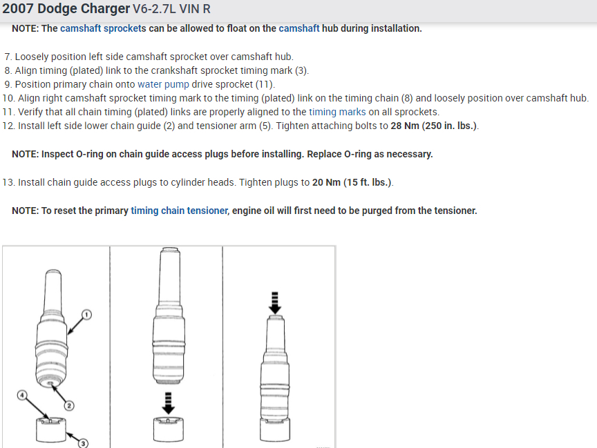

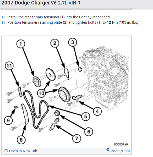

Are you trying to replace the timing chain?
I have attached the instructions for that as well.
