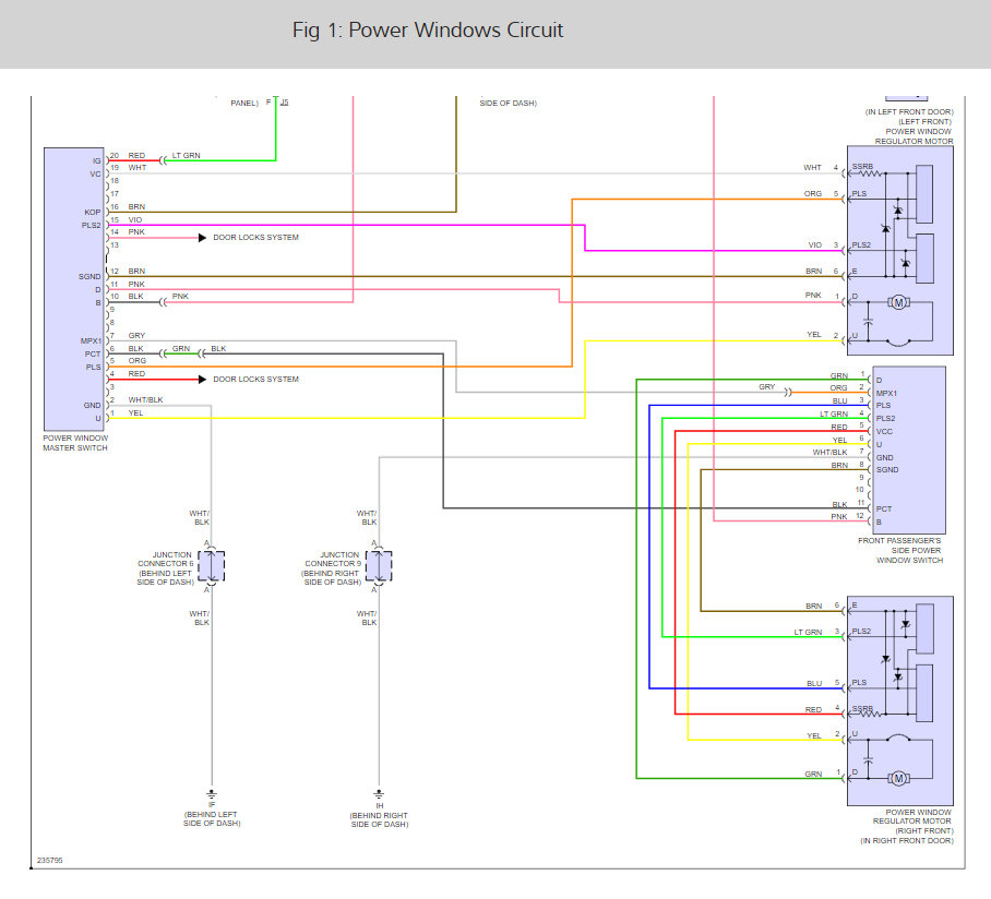

I cannot get my windows to roll up. Does the polarity change on the window switches when it is working?
Aug 2, 2018 at 9:40 AM
  • 55,433 POSTS
Yes, the polarity changes when the switch is activated. Here is a guide that will show you how to test the switch:
https://www.2carpros.com/articles/electric-window-repair

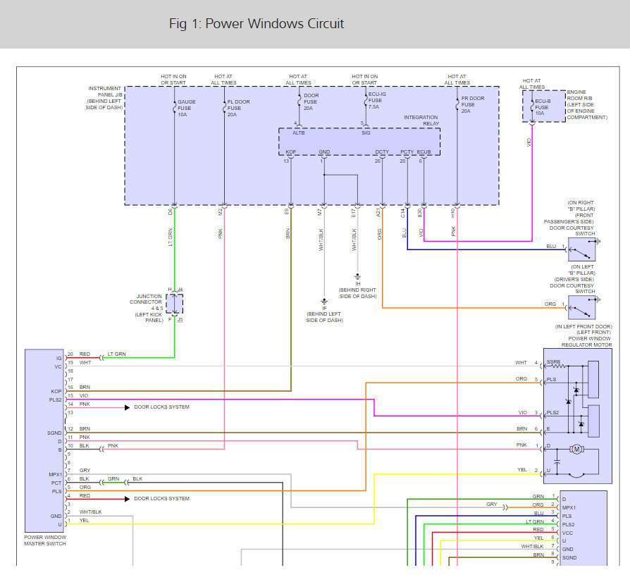

Here is the power window wiring diagrams so you can see how the system works.
Check the fuses as well there is an integration relay as well.
