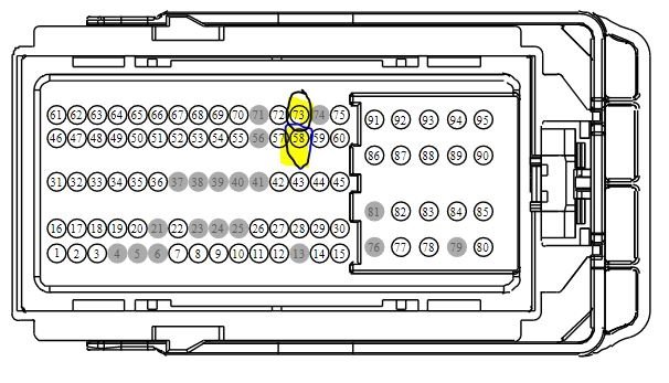

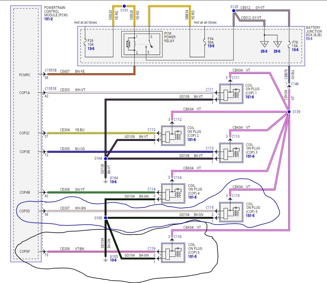

I have coil 5 and 6 that are grounded at all times. I would like to know the PCM diagram to check if it is bad for I have bad wiring.
Dec 17, 2020 at 12:44 AM
STEVE W.
  • 15,409 POSTS
This is the ignition coil wiring. You should have battery voltage on the violet wire, the black with green stripe is a ground and the white with brown stripe is the number 5 coil control wire and the violet with brown wire is the control for number 6. On the PCM it is connector C1551E and the control pins are pins 58 (5) and 73 (6) With the connector off and looking at it the pins are as shown in the second image. An easy way to tell if the issue is the PCM or the wiring would be to connect a meter or test light to the control wires at the coils, then unplug the connector from the PCM, if the ground goes away then the wires are not the problem.
