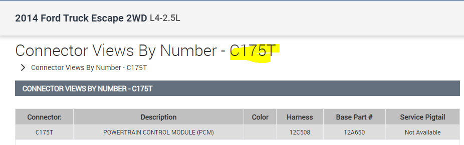

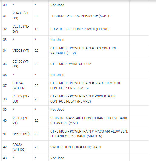

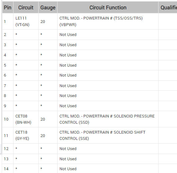

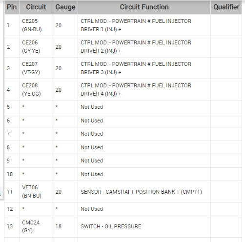

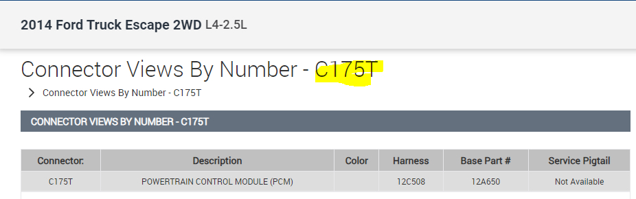

pinout from PCM and OBD?
2014 FORD ESCAPE
90,000 MILES • 2.5L • 4 CYL • 2WD • AUTOMATIC
DSPANN1250
troubleshooting.
Mar 5, 2024 at 6:30 AM
  • 110,241 POSTS

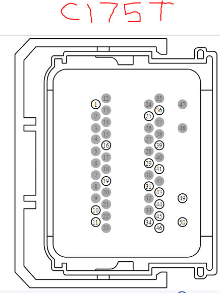

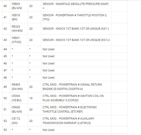

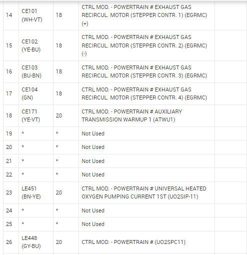

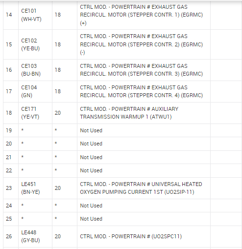

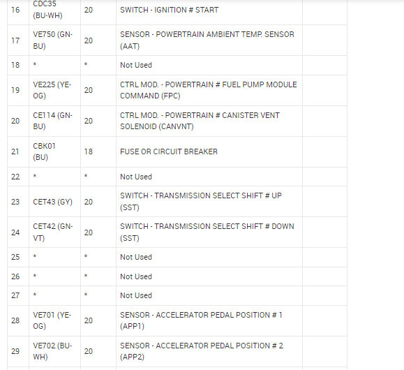

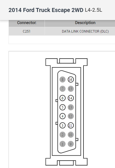

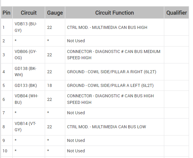

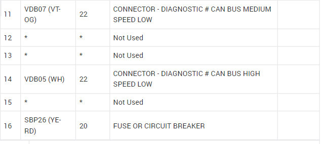

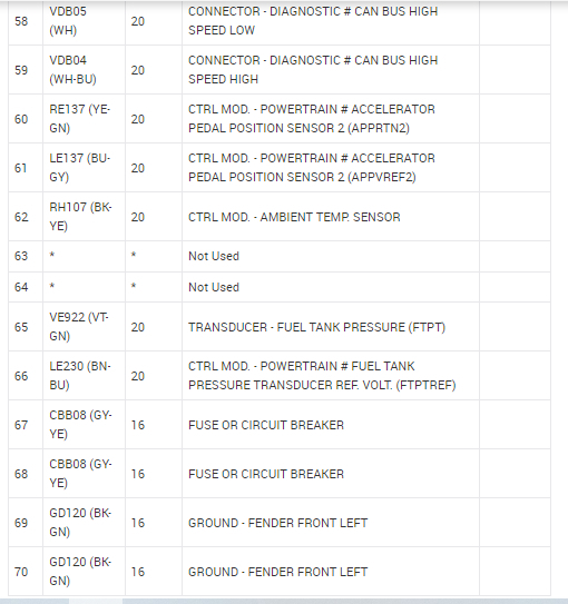

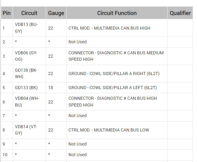

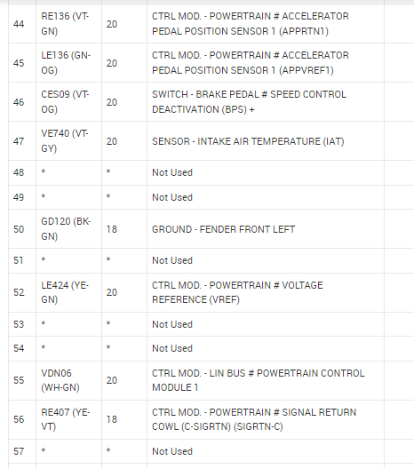

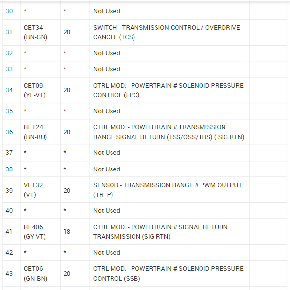

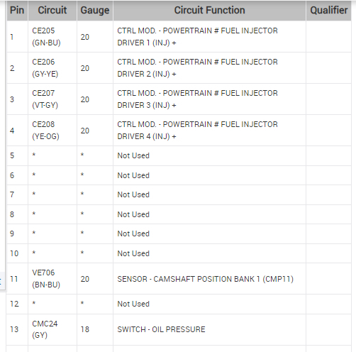

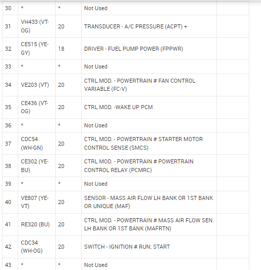

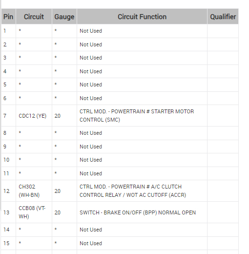

It sounds like you have a headache on your hands. As far as the connector views, I attached them below. Pics 1-3 are the data link connector.

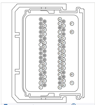

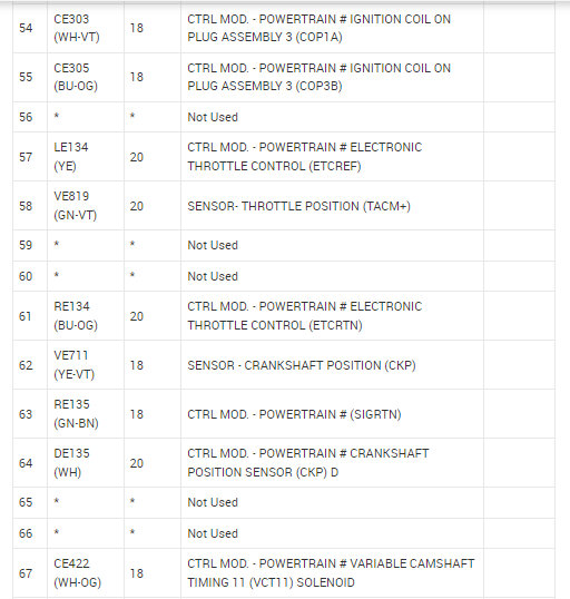

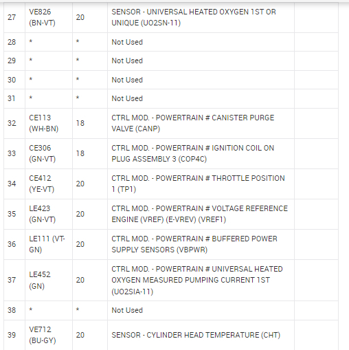

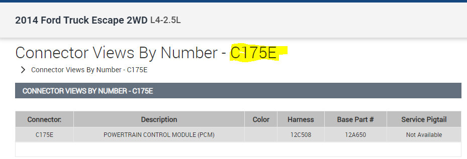

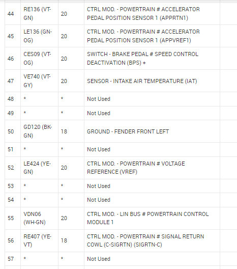

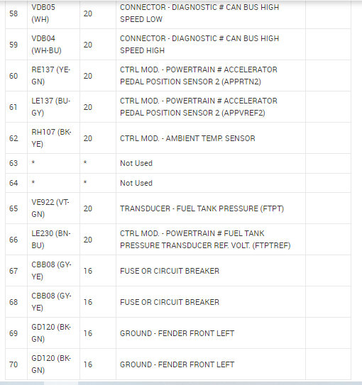

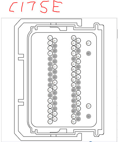

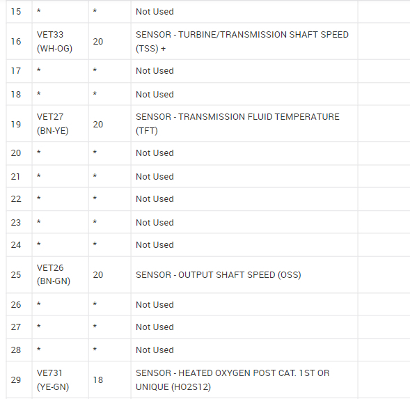

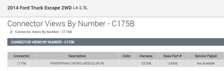

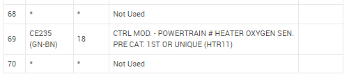

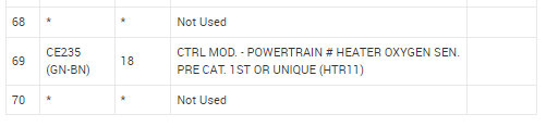

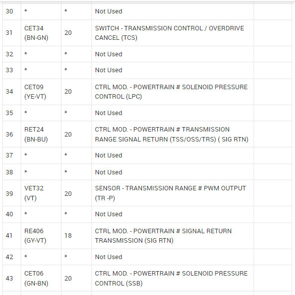

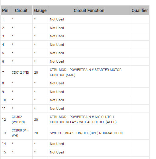

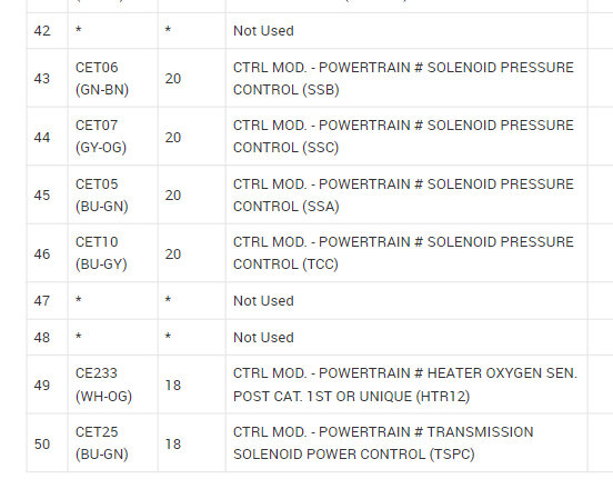

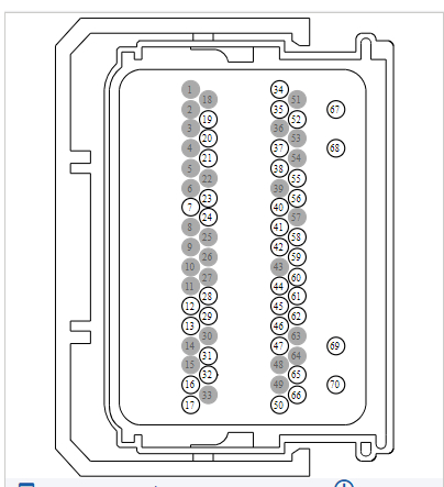

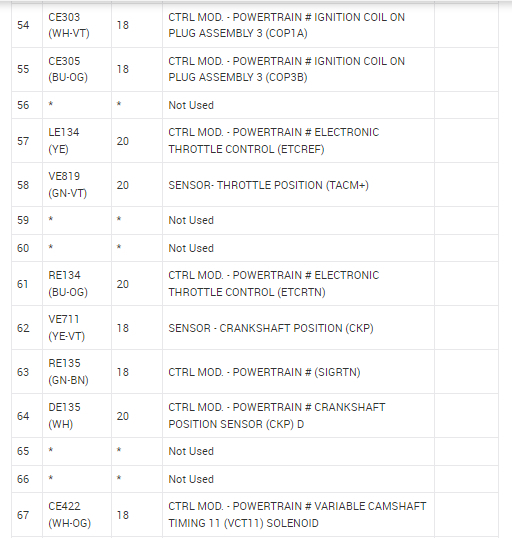

There are three connectors at the PCM. I first put the connector view and then the function of each pin. So, each time you come to a new connector, the following pics are the functions.
Let me know if this is what you need.
