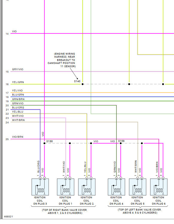

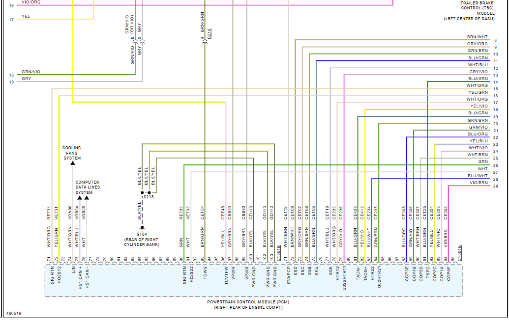

Low voltage on E and F coil. Need to check all the wiring
Jul 18, 2025 at 5:30 AM
  • 55,694 POSTS
I sounds like the coils need to be replaced, here is the wiring diagrams for the coils to the PCM. Check out the images (below). Let us know how it goes
