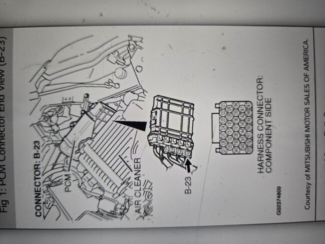

Injector circuit cylinder 2 fault (p0202) noid test shows no light emitted .test injector for ohms and has 14.2 ohms test at injector connector red wire has battery voltage and the yellow with red strip no reading when back probe at injector red wire has battery voltage but yellow red wire also shows voltage next step want to check ecm output at yellow-red pin need pinout diagram

Pin 146 yellow/red. Measure reistance injector to that pin
