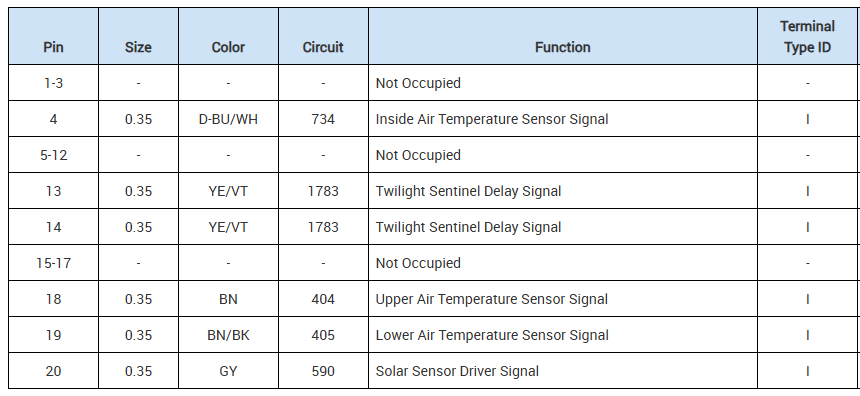

Need pinout for climate control?
2015 CHEVROLET SILVERADO
150,000 MILES
CECE STITES
Pinout for climate control needed.
Jan 3, 2025 at 2:49 PM
  • 110,193 POSTS

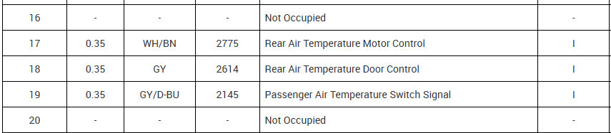

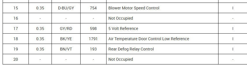

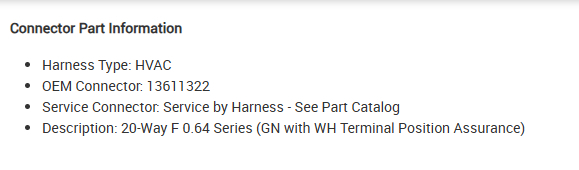

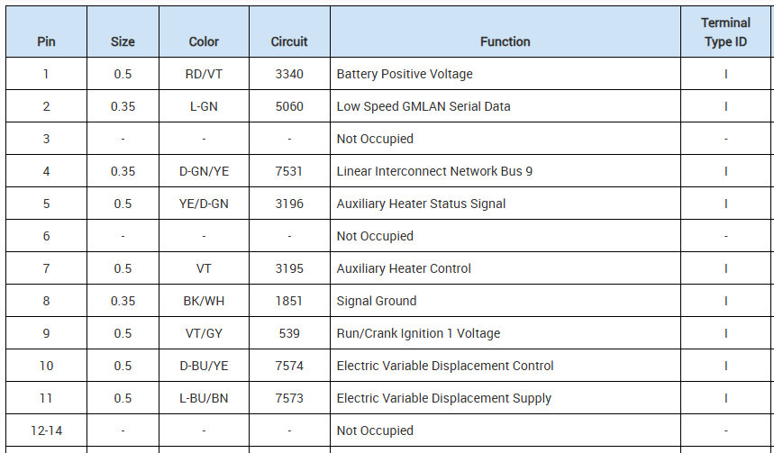

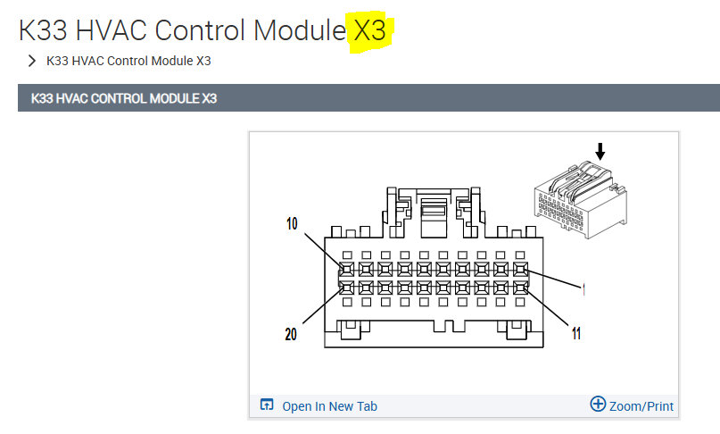

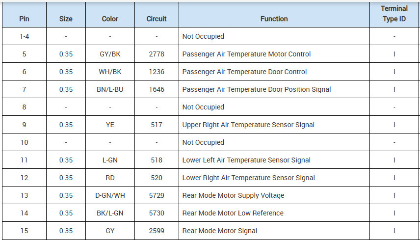

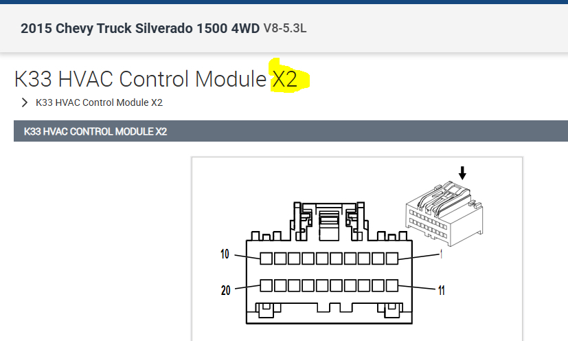

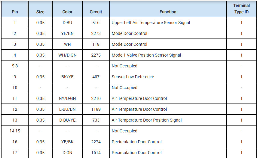

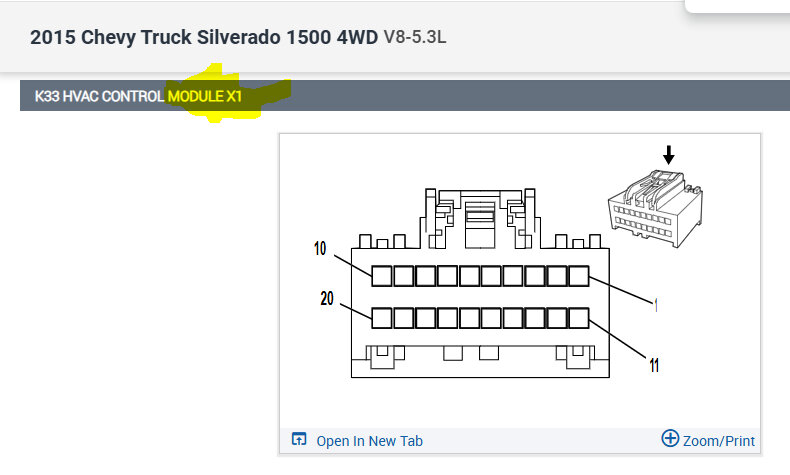

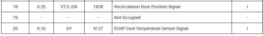

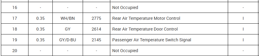

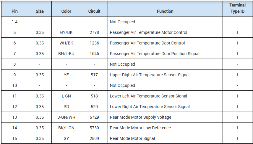

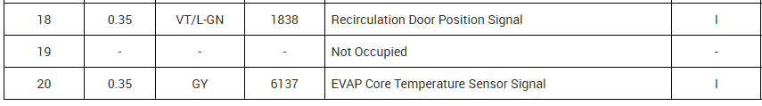

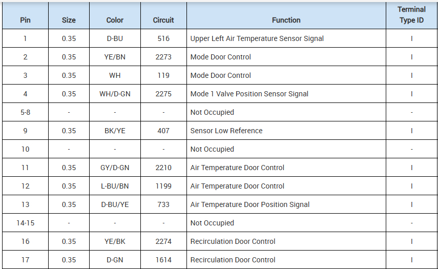

I suspect you are looking for automatic climate control. If that is incorrect, let me know.

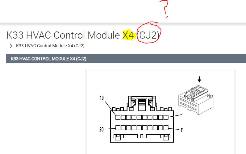

If you look below, I attached each of the four connector pinouts. Note, connector four is only relevant if the truck came with RPO, CJ2. I believe the RPO codes are located in the glove box.
Let me know if this helps or if you have other questions.,
