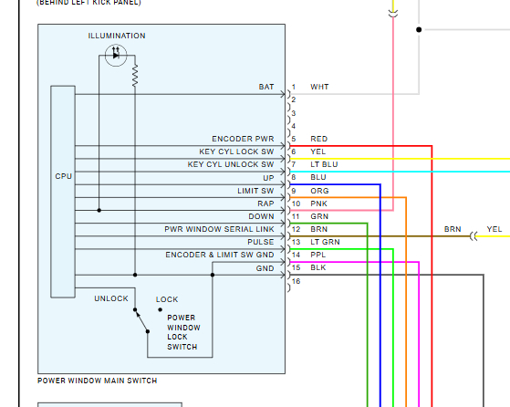

I need the pin out hole number and wire color for the master window switch. Its a 16 pin connector and its for the 2006 g35 coupe.

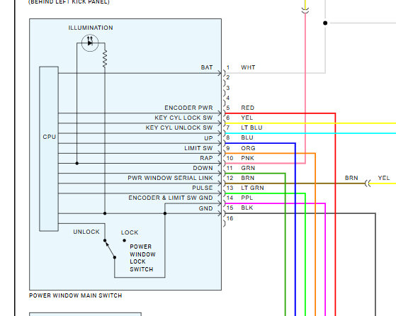

Hello Dangell,
They don't give a connector pin out but here is the wiring diagrams at the connector which show the wiring colors, you should be able to make the repair from this. Check out the images (below). Let us know if you need anything else.

How do I determine what row is top and bottom?
Jul 14, 2025 at 8:39 AM
  • 55,710 POSTS
If you look close at the connector it is numbered,
