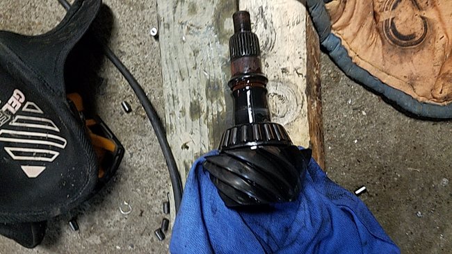

I am replacing bearings racers and so forth, basically everything but ring gear and pinion. everything came apart as normal other than the pinion gear will not come out even under 8000lbs from a hydrologic press and 40lbs sledge hammer. it will not budge the bearing still spins greatly and was not going to replace those but after the beating and pressure i am worried it will fail. so short if heating the case (which i do not want to do) or trying to cut the bearing and race out i am at a loss as to what to do to remove it.

Bearing is still in and holding the pinion in the case. But yes everything else is removed.
Feb 19, 2018 at 7:59 AM
Okay, it sounds like you need to remove the cage and bearings for the outer bearing. the race left on the pinion should fit through the hole of the race for the bearing.
Feb 19, 2018 at 8:01 AM
BERCHEL HELTON
  • 7 POSTS
How can i remove it? no way to grab a hold of it with any tool to remove it.
Feb 19, 2018 at 8:07 AM
You will need to break away the cage and bearings from the race on the pinion. Use an air hammer to bust them up. you are replacing the bearing and race anyway.
Feb 19, 2018 at 8:09 AM
BERCHEL HELTON
  • 7 POSTS
Okay, that is what my next move was but wanted to double check before hand.
Feb 19, 2018 at 8:11 AM
Yep, hope the pinion is okay after all this.
Feb 19, 2018 at 8:14 AM
BERCHEL HELTON
  • 7 POSTS
Me too, but worse case replace it and ring gear. truthfully i am more worried about damaging the differential case than anything.
Feb 19, 2018 at 9:15 AM
By breaking the cage and bearing, you will only damage the race while in there, not the case.
Feb 19, 2018 at 5:44 PM
BERCHEL HELTON
  • 7 POSTS

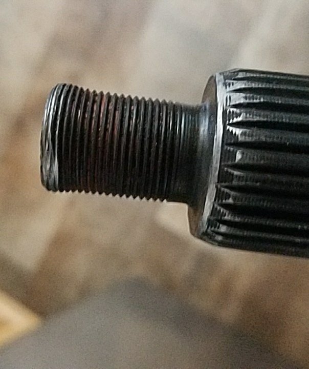

Thought i would give you an update. i got it out with a little heat in the bearing every thing is ready to go back together fresh and clean. just working on the pinion gear threads my helper mushroomed the first three threads and no where close to me has a die that size, but other than that every thing is going great and surprisingly for 220,000 miles. the gears are in great shape all wear patterns almost perfectly.
Feb 22, 2018 at 4:06 AM
Glad to hear it. You may want to consider replacing the ring and pinion. If he mushroomed the pinion, he may have damaged the shaft so it is not completely straight.
Feb 22, 2018 at 4:40 AM
BERCHEL HELTON
  • 7 POSTS
I am considering it, i was hoping on how stuck it was that it did not bend it a millwright. buddy is taking it in to shop tomorrow to see if it is bent and to fix the threads for me. with any luck it is straight, especially since nothing about the rear end showed and signs of bad wear even the drive shaft came out at.002 and .003 when we put the dial indicator on them for shaft play.
Feb 22, 2018 at 5:21 AM
Sounds good replacement will be necessary if it cannot be fixed.
