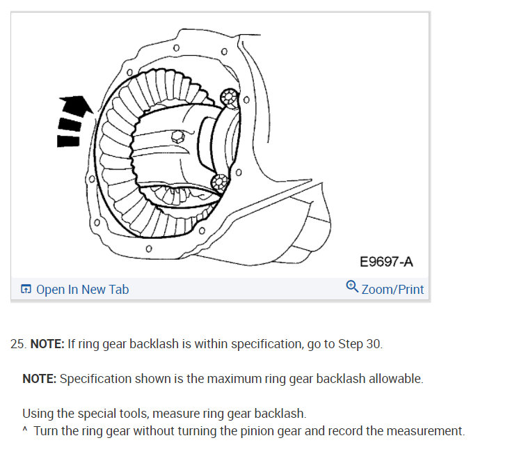

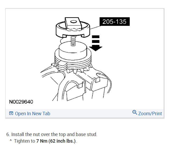

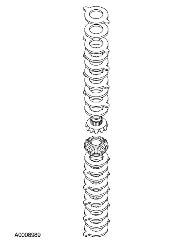

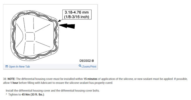

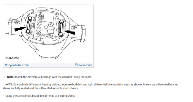

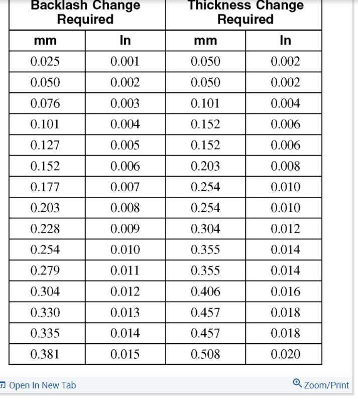

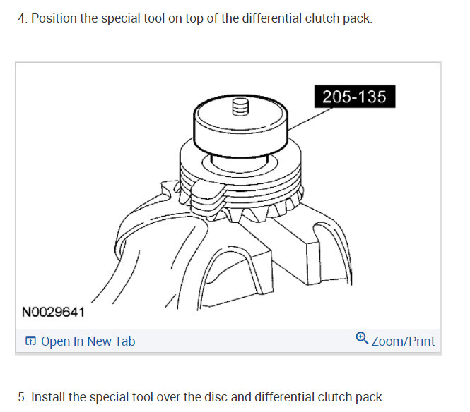

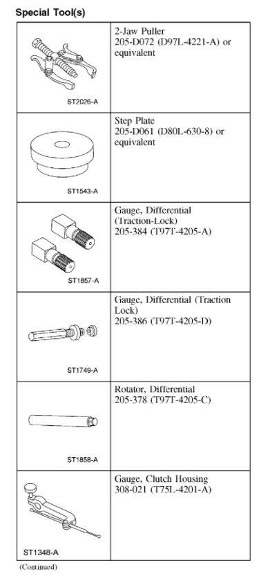

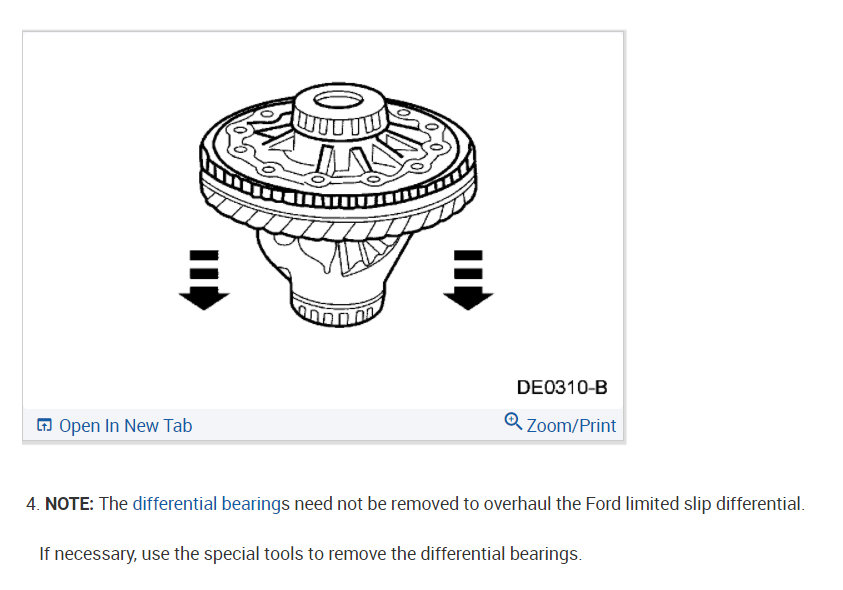

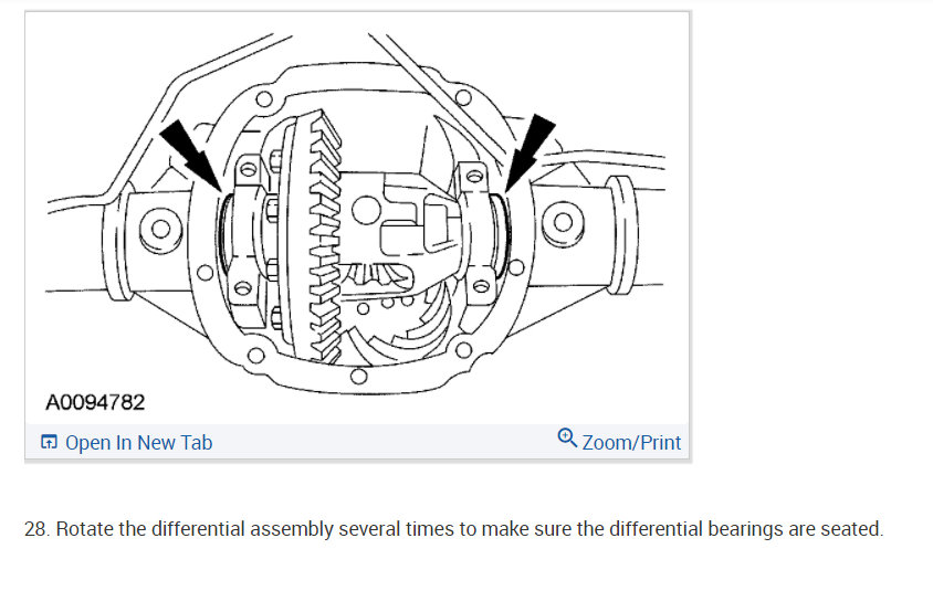

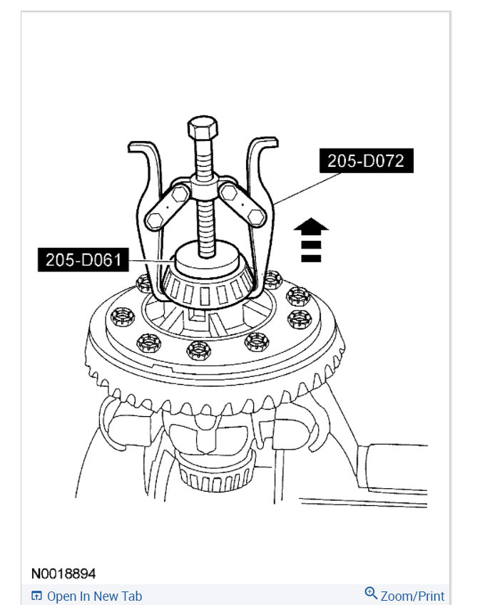

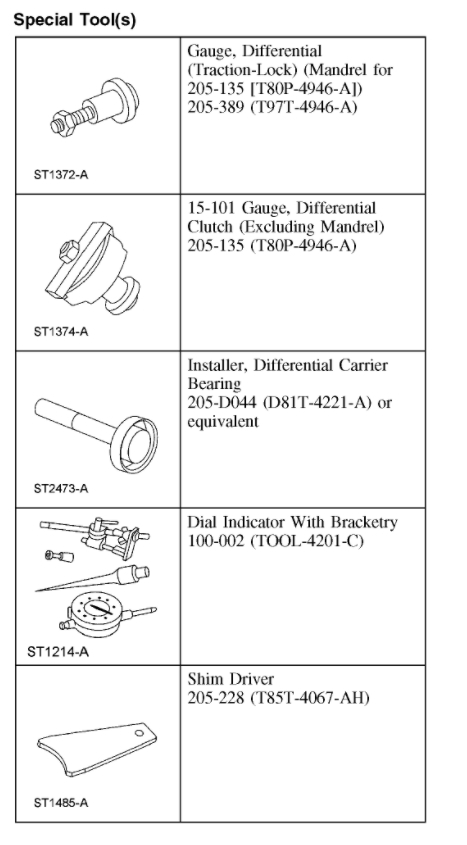

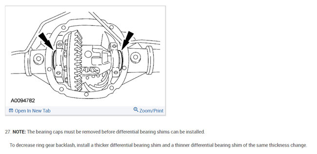

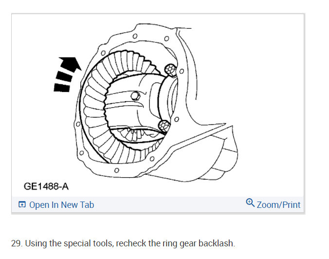

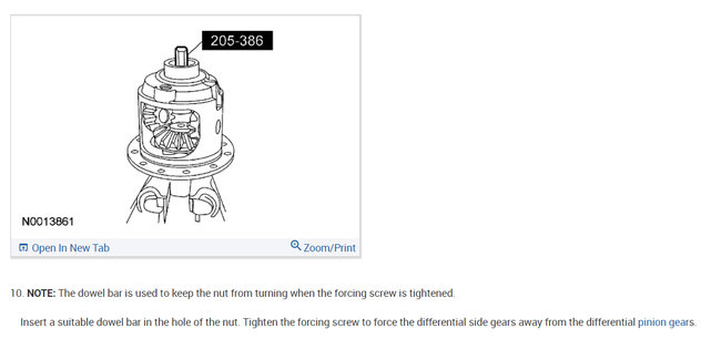

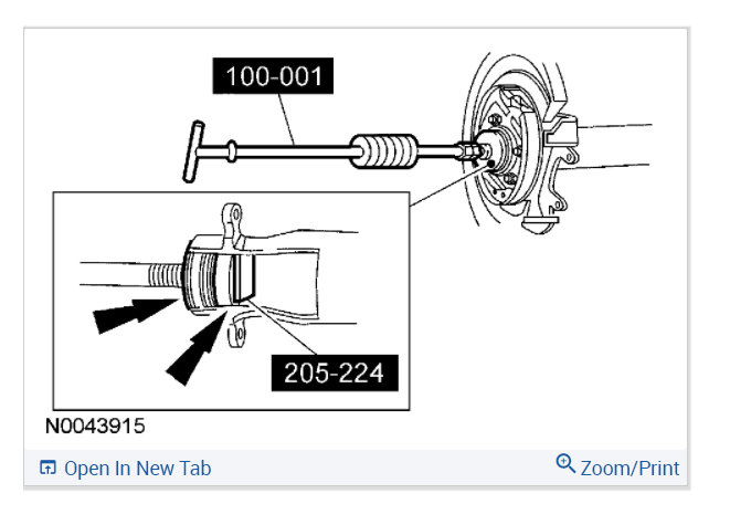

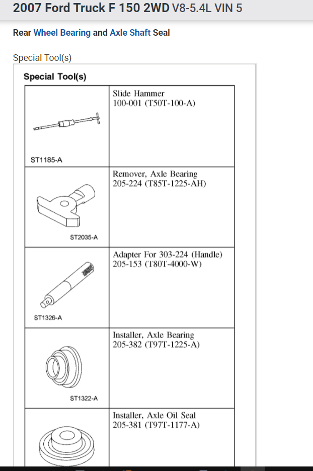

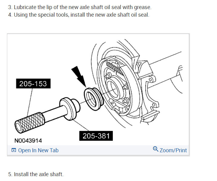

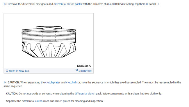

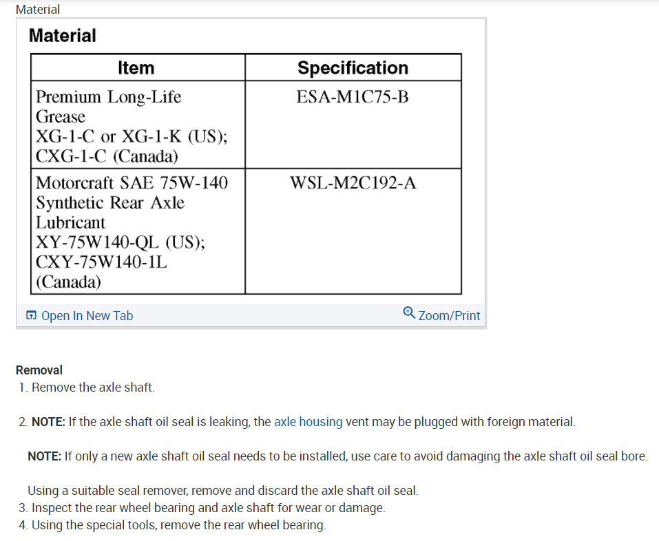

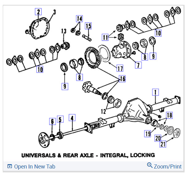

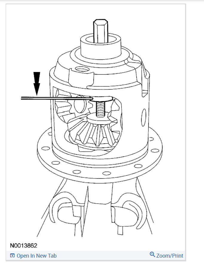

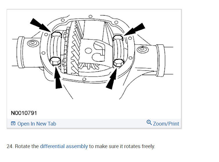

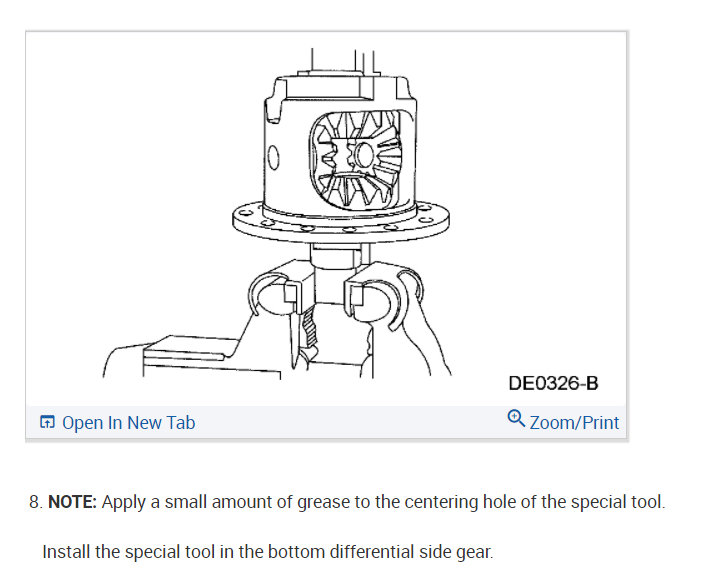

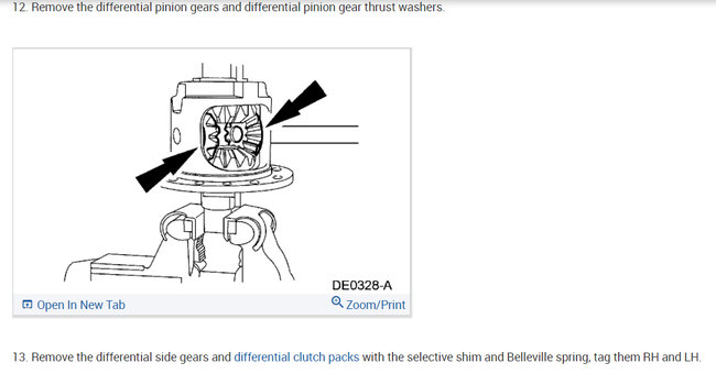

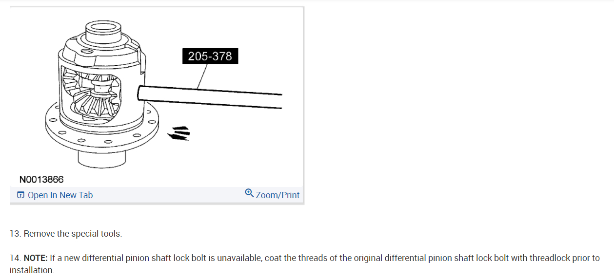

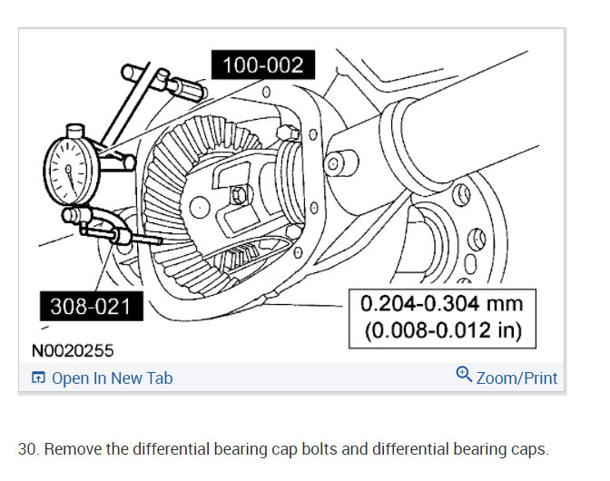

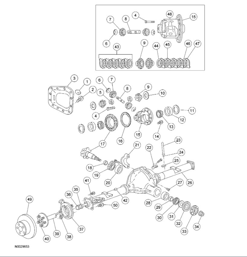

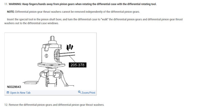

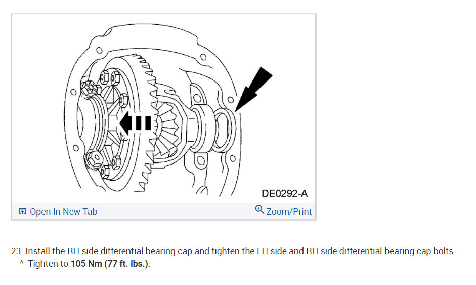

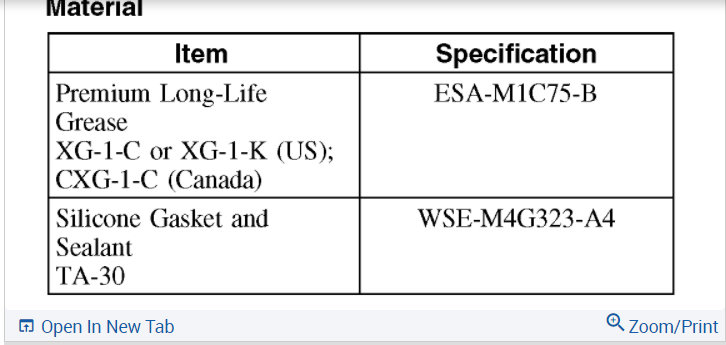

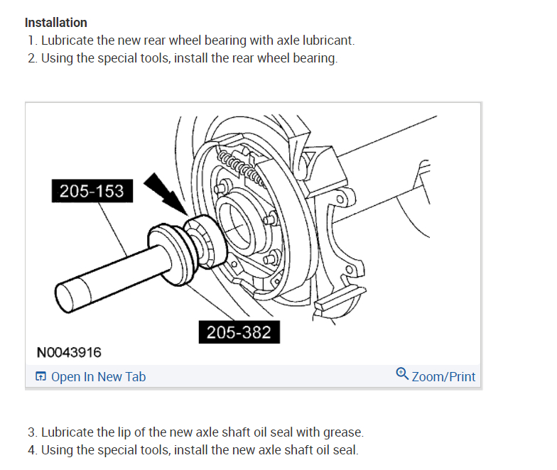

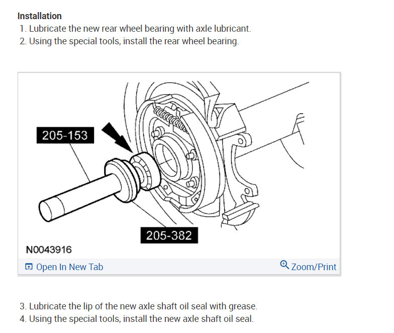

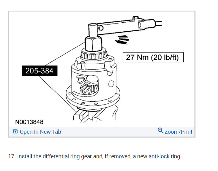

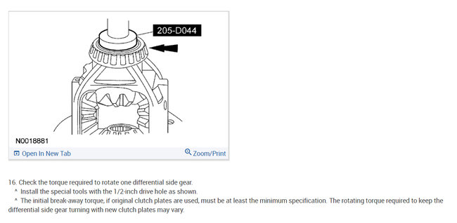

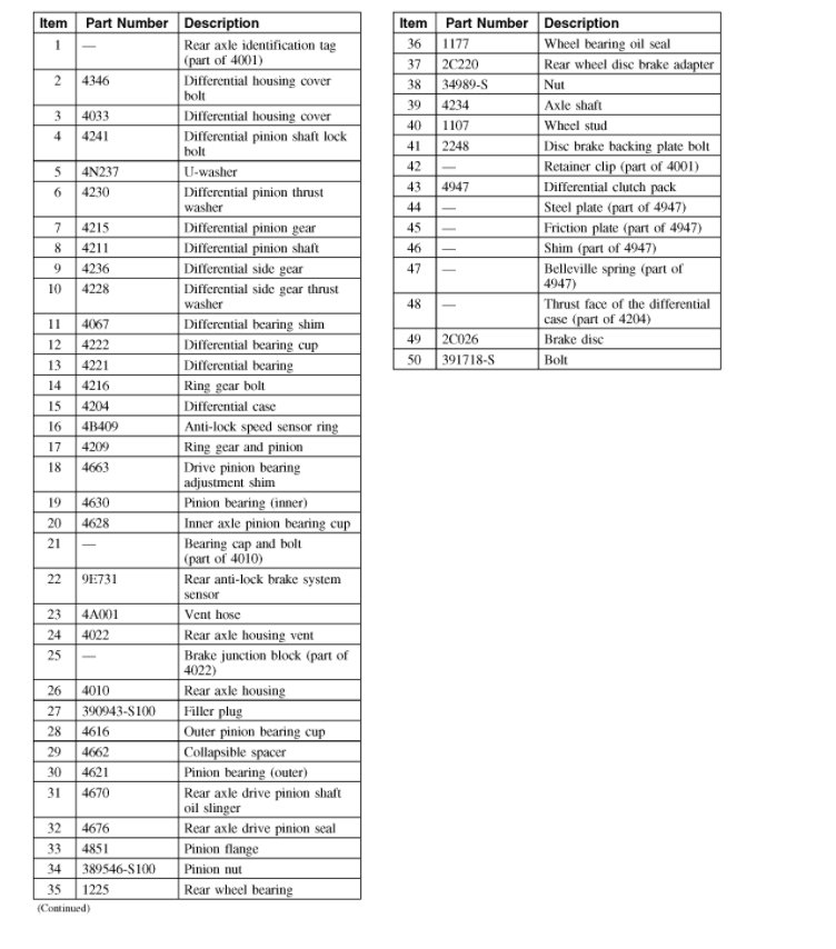

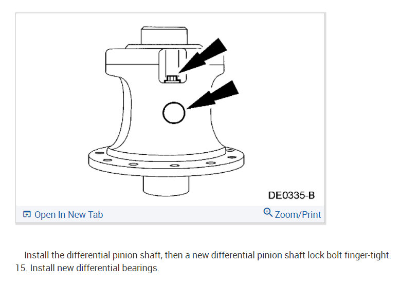

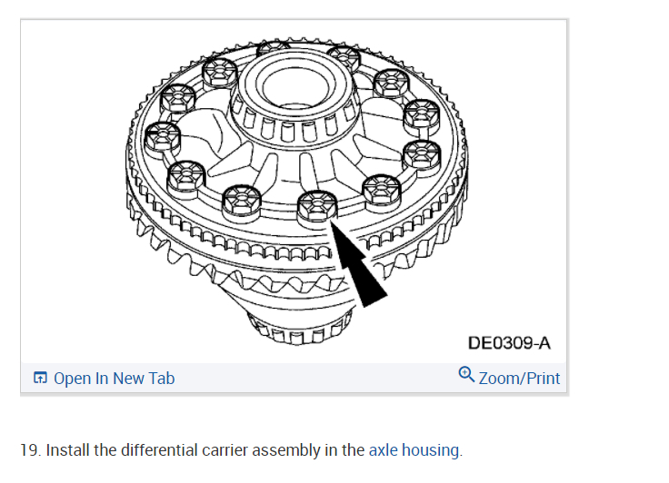

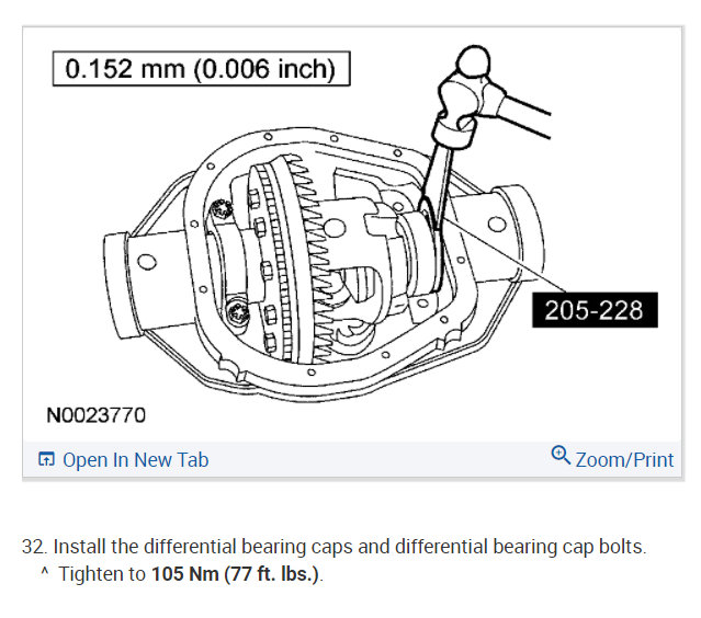

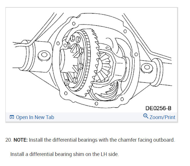

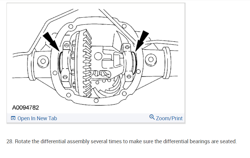

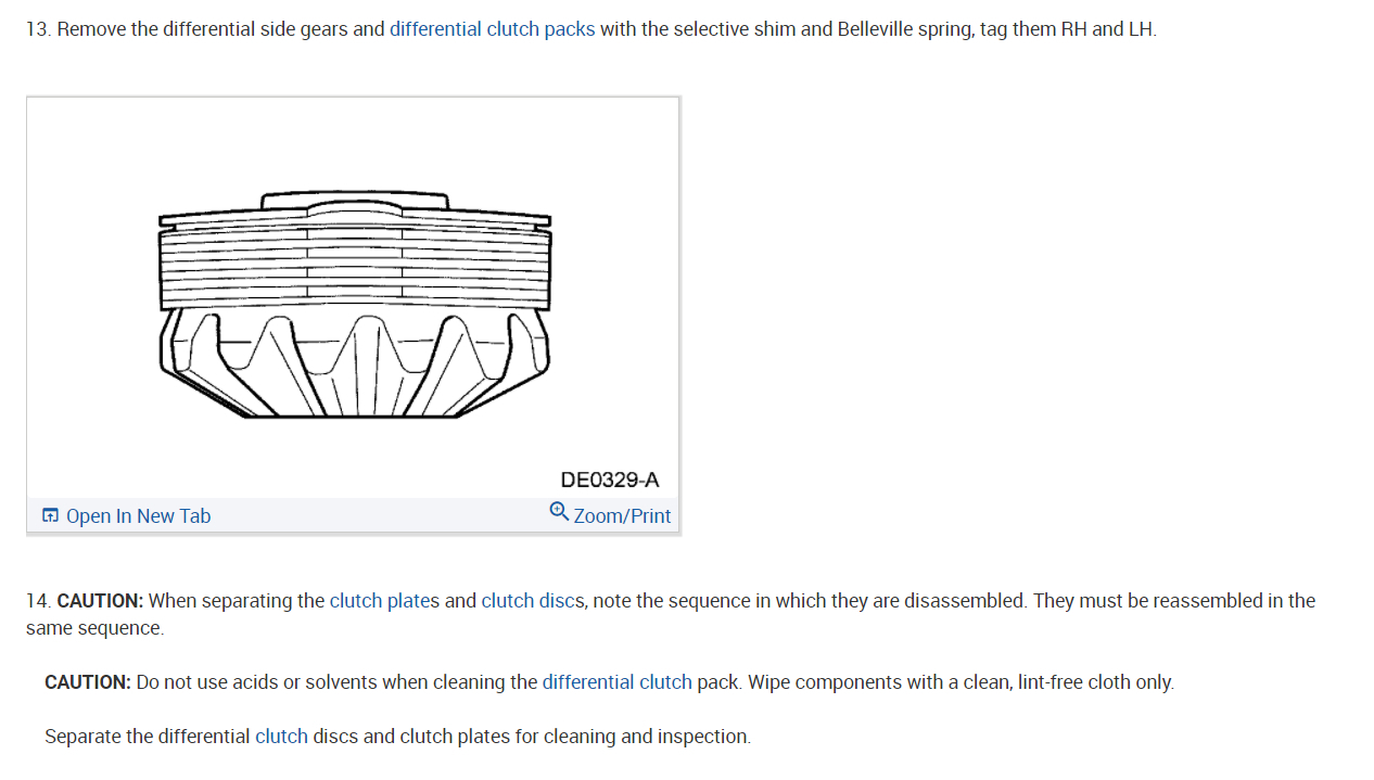

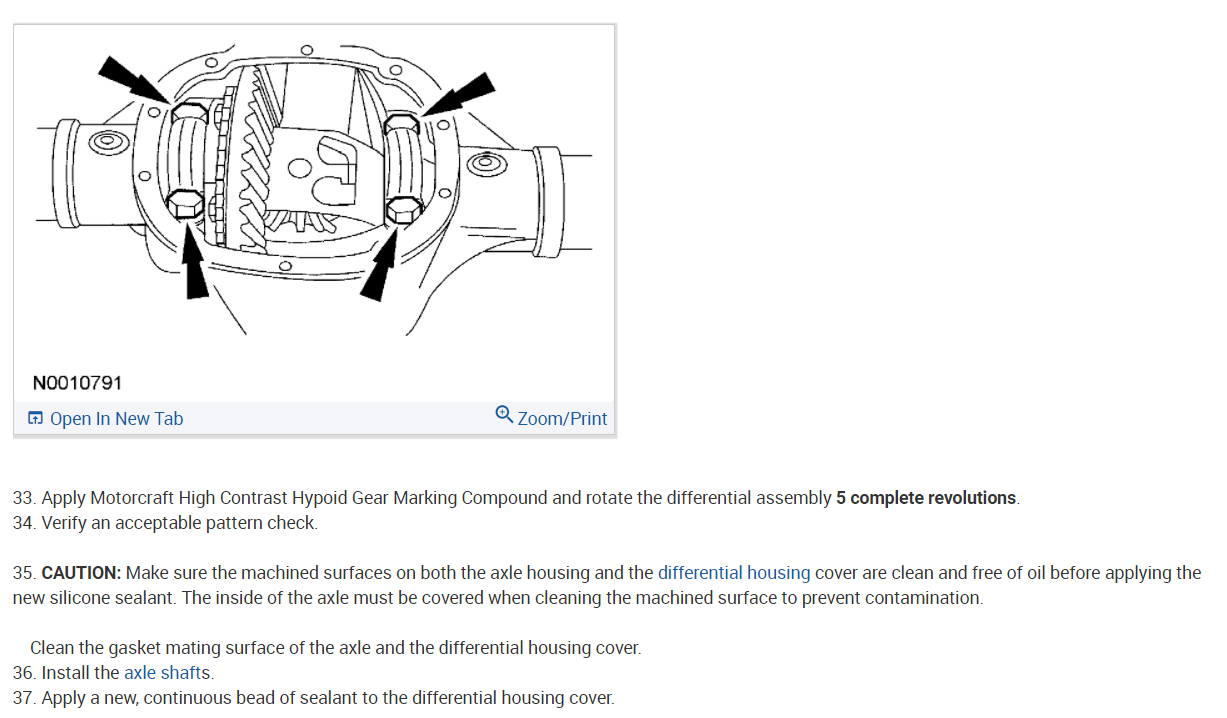

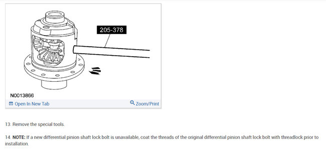

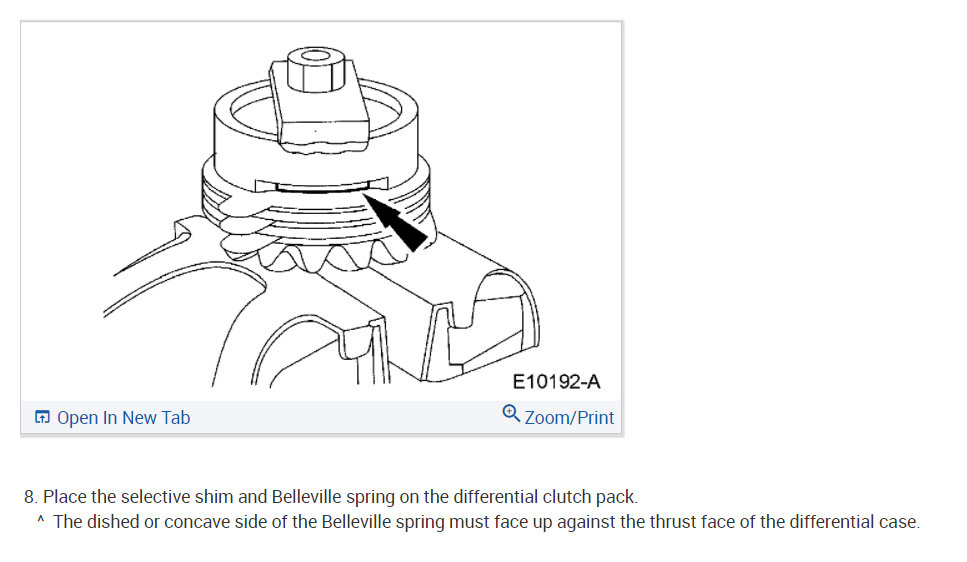

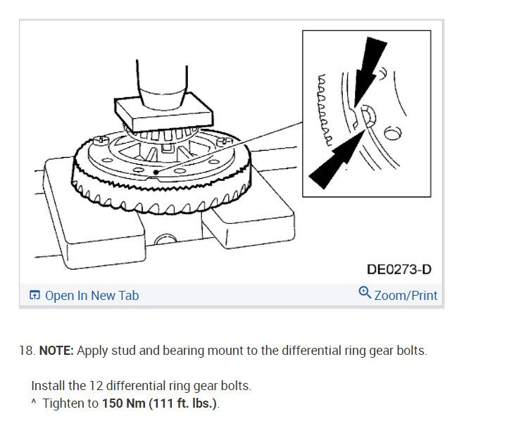

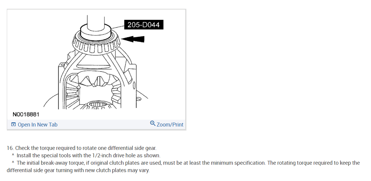

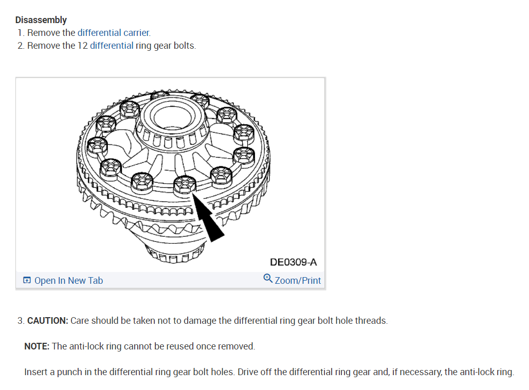

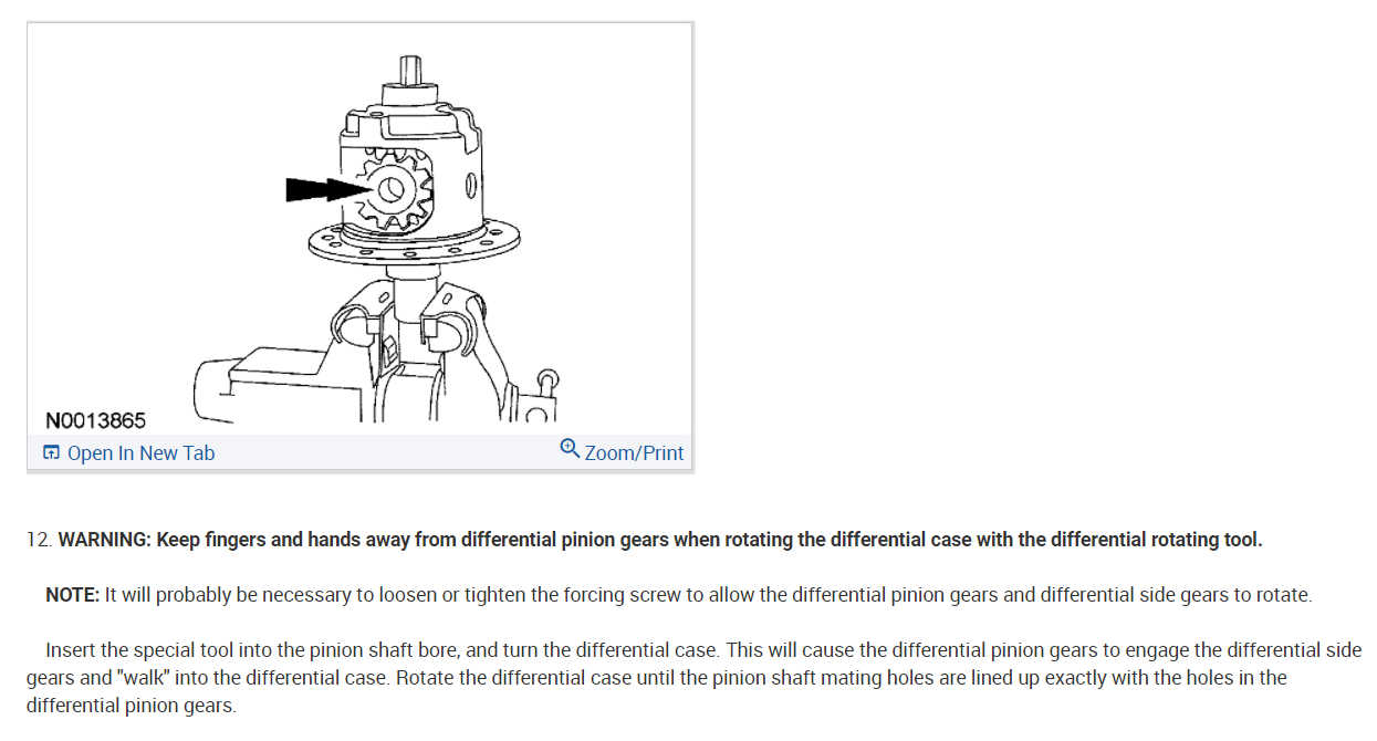

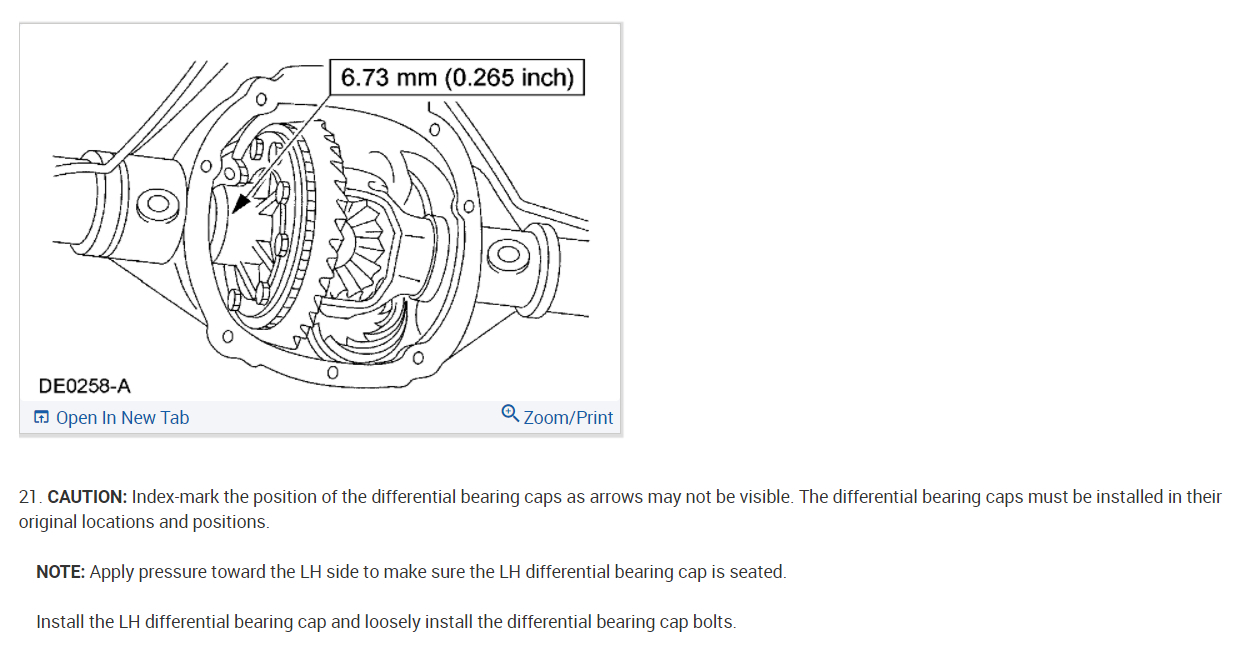

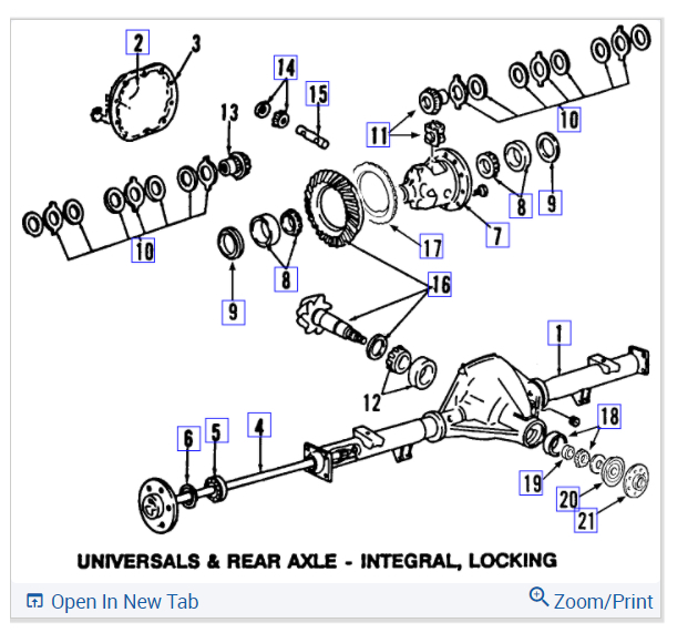

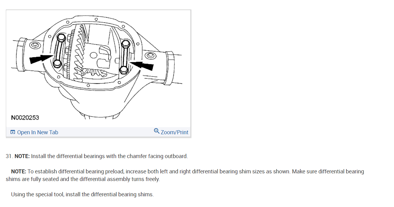

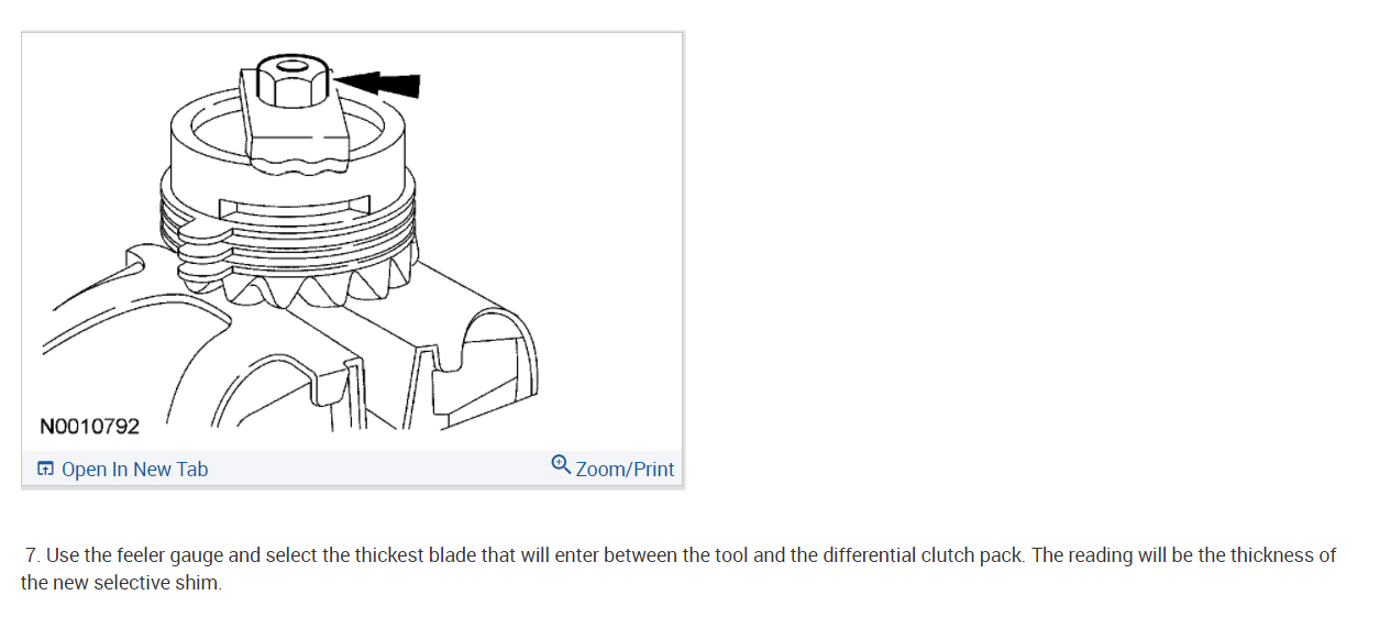

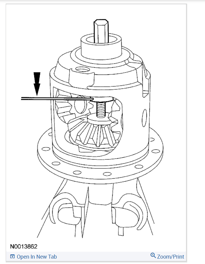

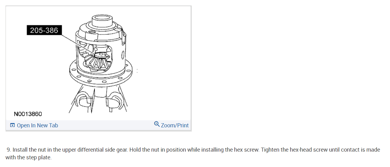

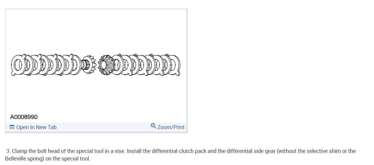

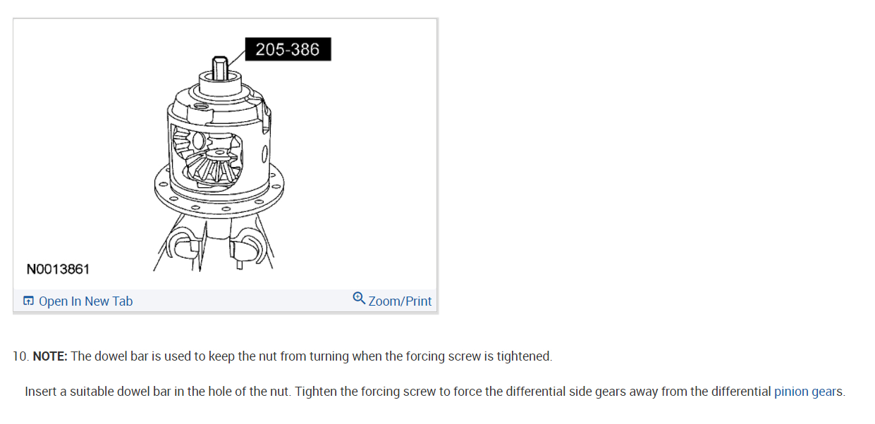

I have to ask this. Did you remove the flange and nut? did the outer bearing come out okay? The inner bearing is pressed to the pinion so it should slide out. It sounds like the outer bearing is the one that is frozen. worse case is that you will have to cut the bearing apart to remove it from the case. Here are the differential rebuild instructions (locker) a non locker is easier fyi. Check out the diagrams (Below). Please let us know what happens. Also further in this post will show you how to do the axle bearing and pinion gear and bearing.
Feb 19, 2018 at 7:11 AM

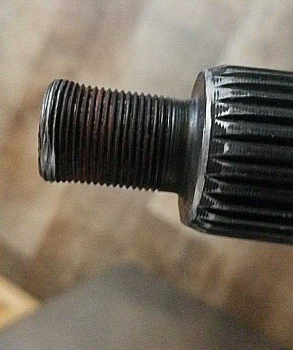

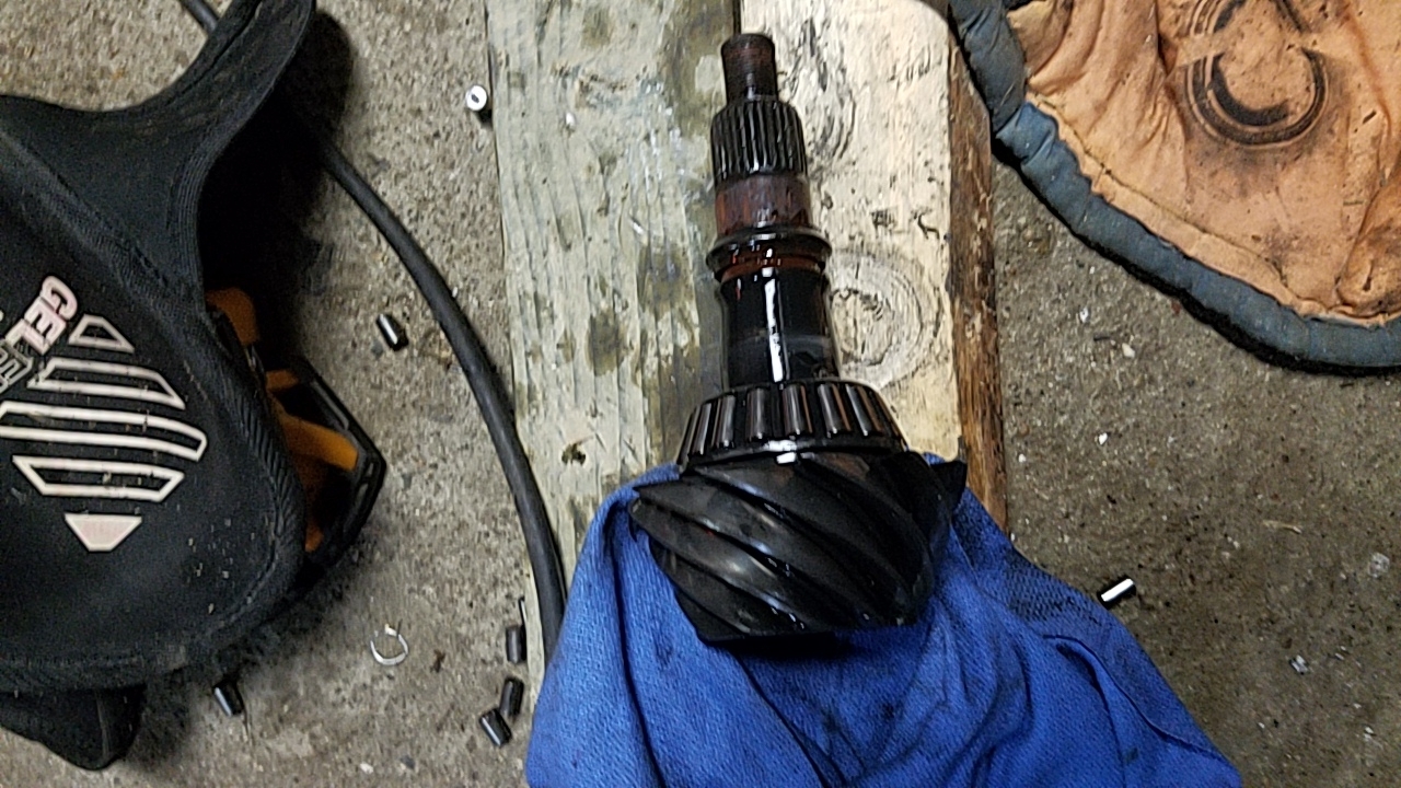

Thought i would give you an update. i got it out with a little heat in the bearing every thing is ready to go back together fresh and clean. just working on the pinion gear threads my helper mushroomed the first three threads and no where close to me has a die that size, but other than that every thing is going great and surprisingly for 220,000 miles. the gears are in great shape all wear patterns almost perfectly.

Glad to hear it. You may want to consider replacing the ring and pinion. If he mushroomed the pinion, he may have damaged the shaft so it is not completely straight.

I am considering it, i was hoping on how stuck it was that it did not bend it a millwright. buddy is taking it in to shop tomorrow to see if it is bent and to fix the threads for me. with any luck it is straight, especially since nothing about the rear end showed and signs of bad wear even the drive shaft came out at.002 and .003 when we put the dial indicator on them for shaft play.

Sounds good replacement will be necessary if it cannot be fixed.
