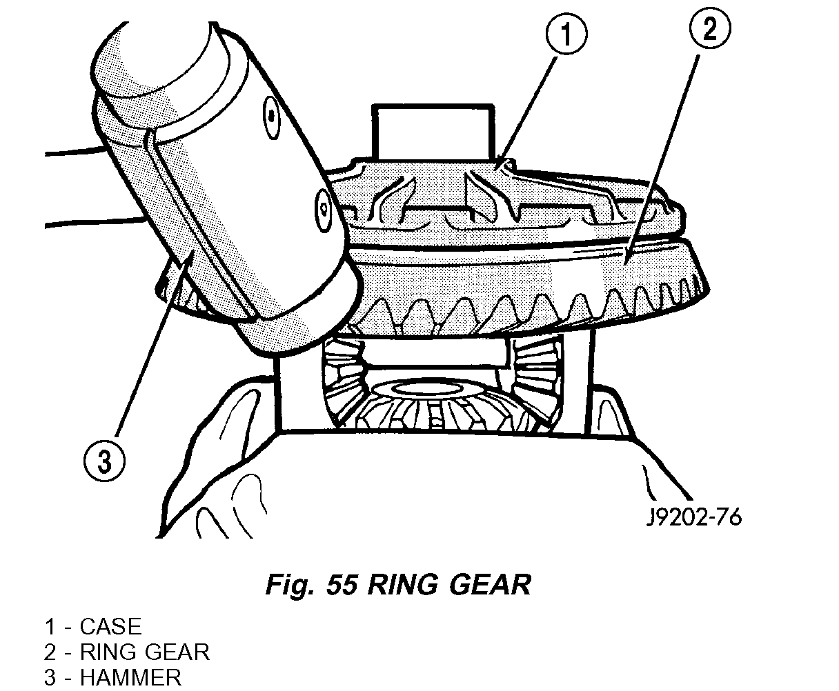

2. Place differential case (1) in a vise with soft metal jaw.
3. Remove bolts holding ring gear (2) to differential case.
pic 1
4. Drive ring gear from differential case with a dead-blow hammer (3) (Fig. 55).

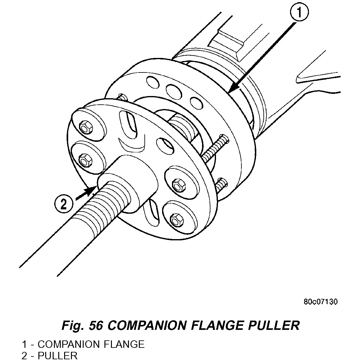

6. Remove flange yoke from pinion shaft with Remover C-452 (2) (Fig. 56).

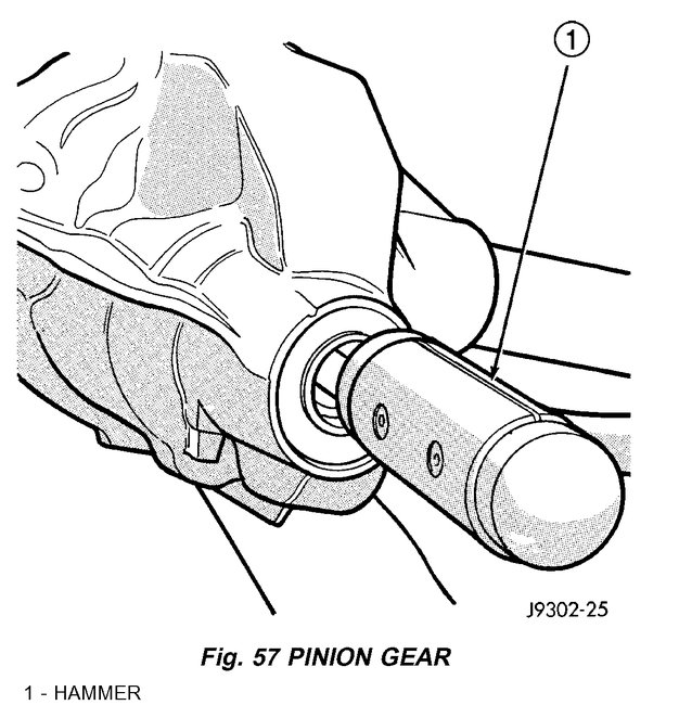

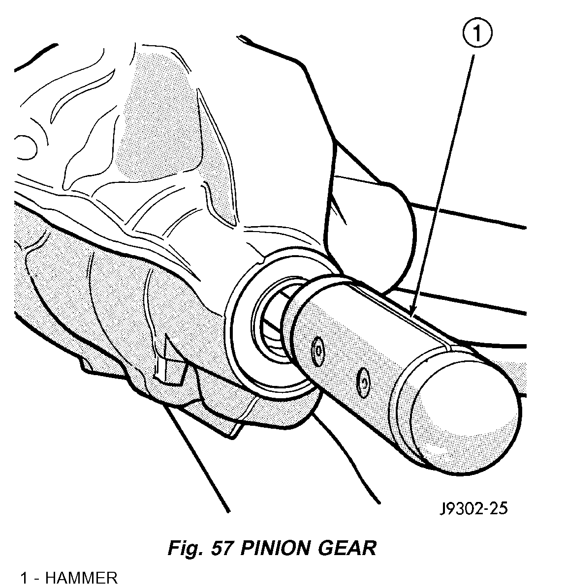

7. Remove pinion from the housing with deadblow hammer (1) (Fig. 57).

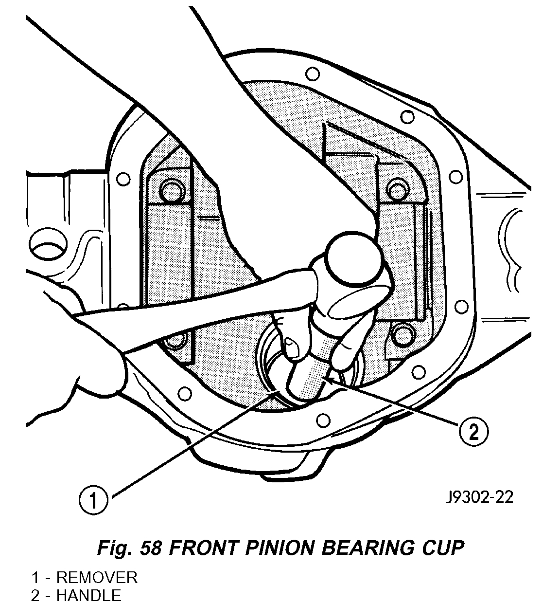

10. Remove front pinion bearing cup with Remover C-4345 (1) and Handle C-4171 (2) (Fig. 58).

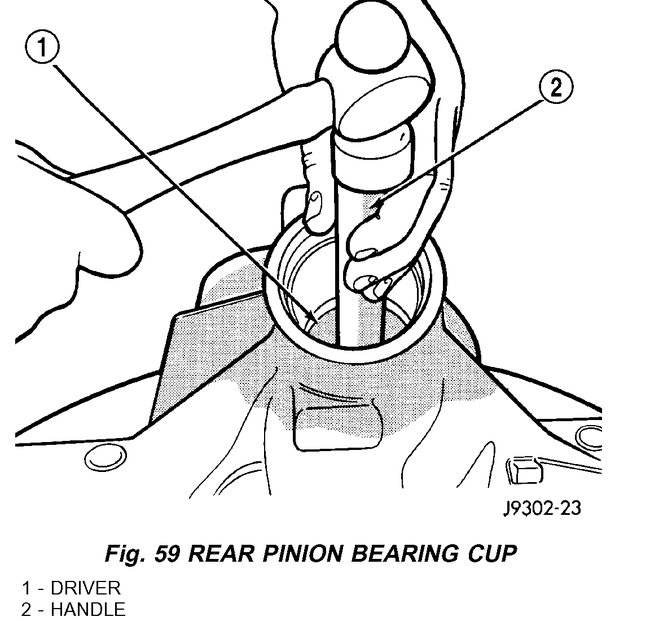

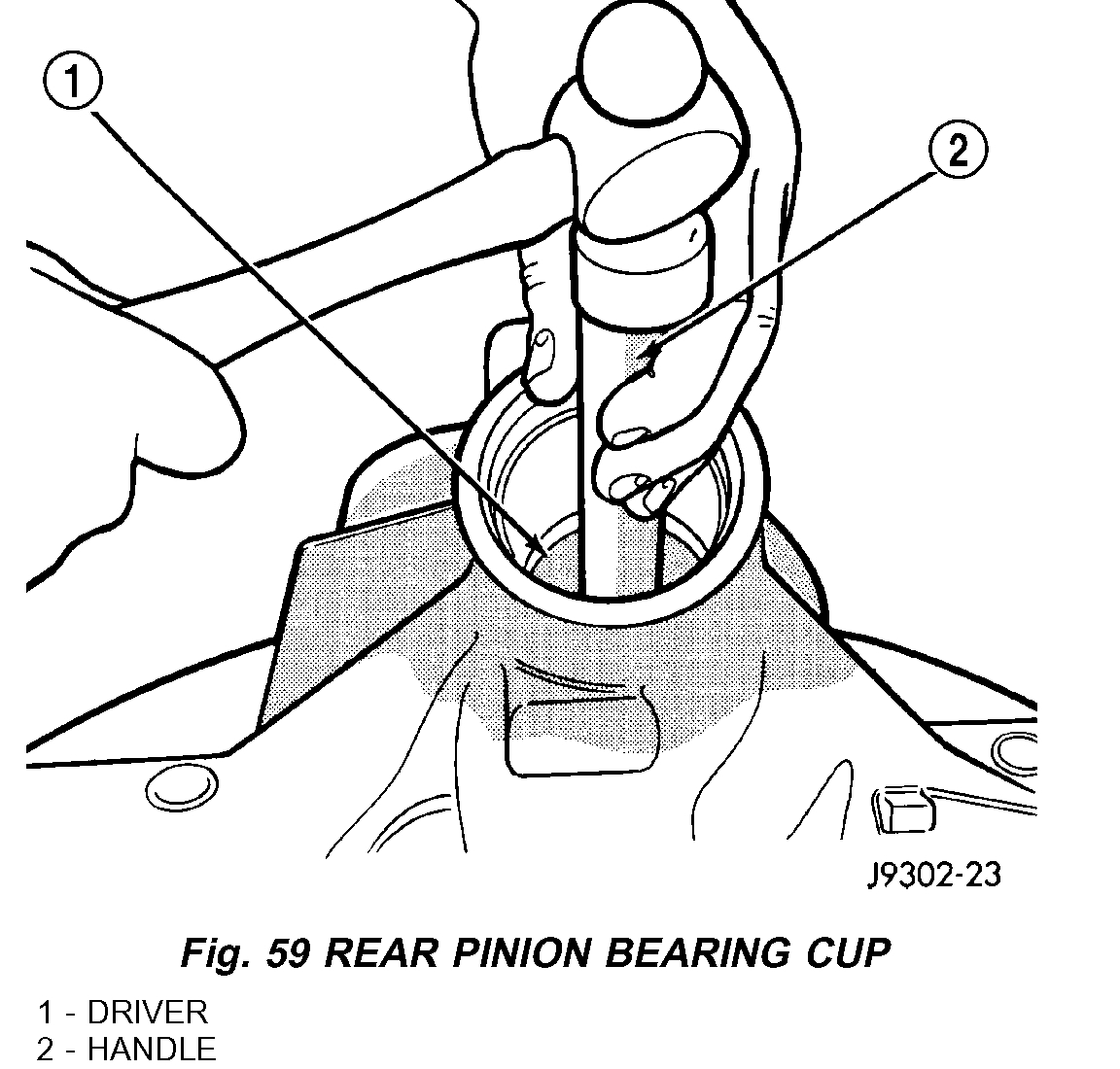

11. Remove rear bearing cup with Remover C-4307 (1) and Handle C-4171 (2) (Fig. 59).
pic 6

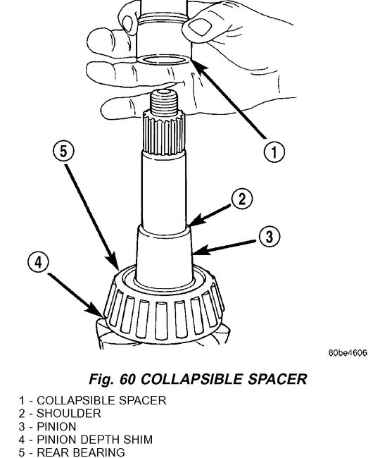

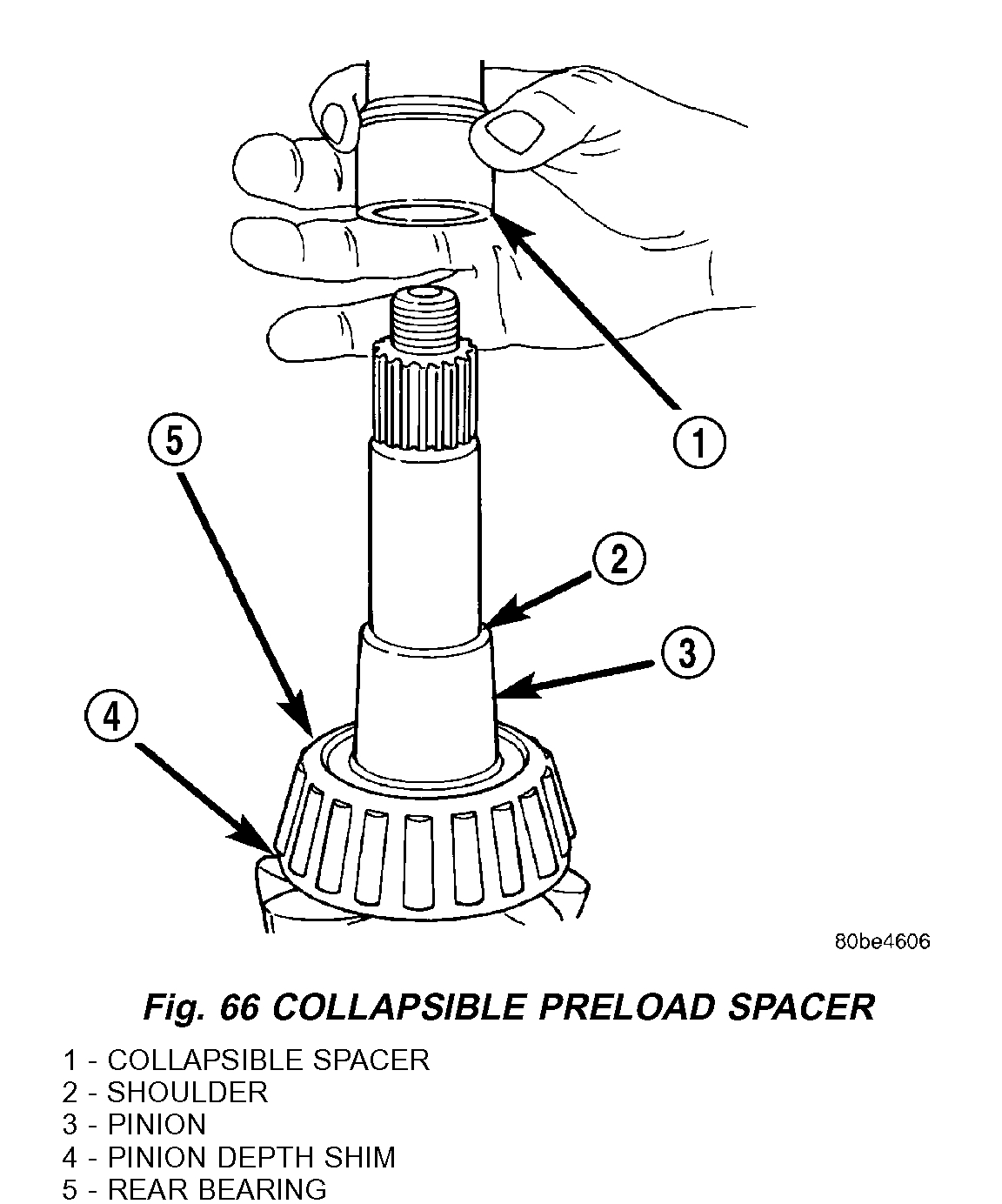

12. Remove collapsible spacer (1) from pinion (3) (Fig. 60).

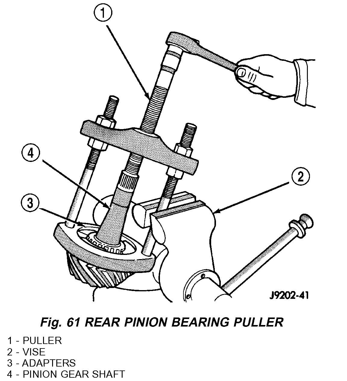

13. Remove rear pinion bearing with Puller/Press C-293-PA (1) and Adapters C-293-47 (3) (Fig. 61).

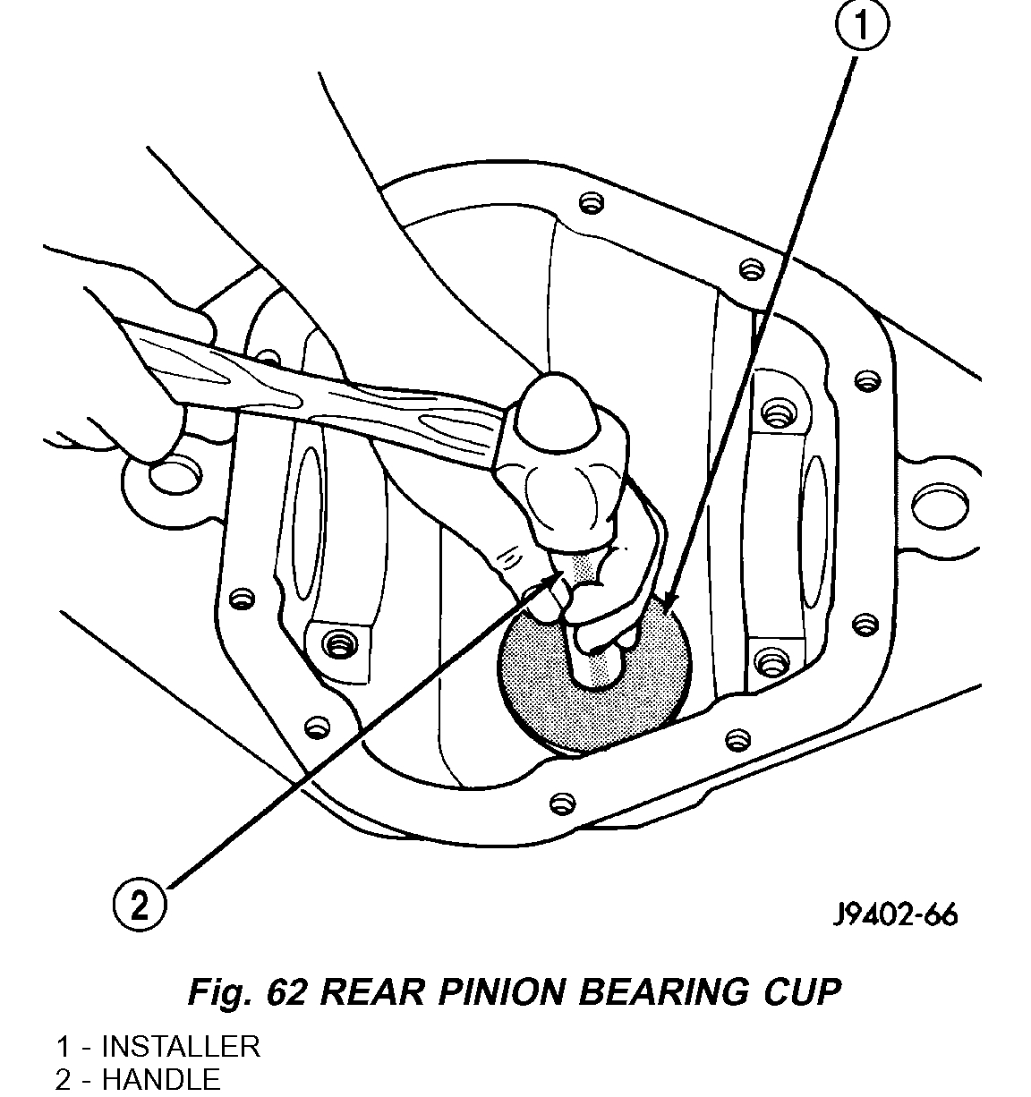

pic 8
2. Install rear pinion bearing cup with Installer C-4308 (1) and Handle C-4171 (2) (Fig. 62).

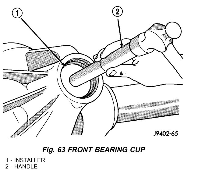

pic 9

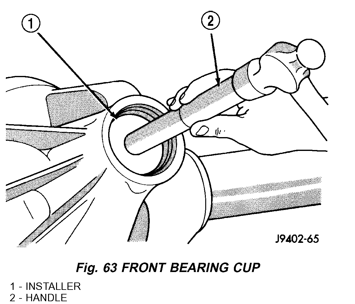

3. Install front pinion bearing cup with Installer D-130 (1) and Handle C-4171 (2) (Fig. 63).

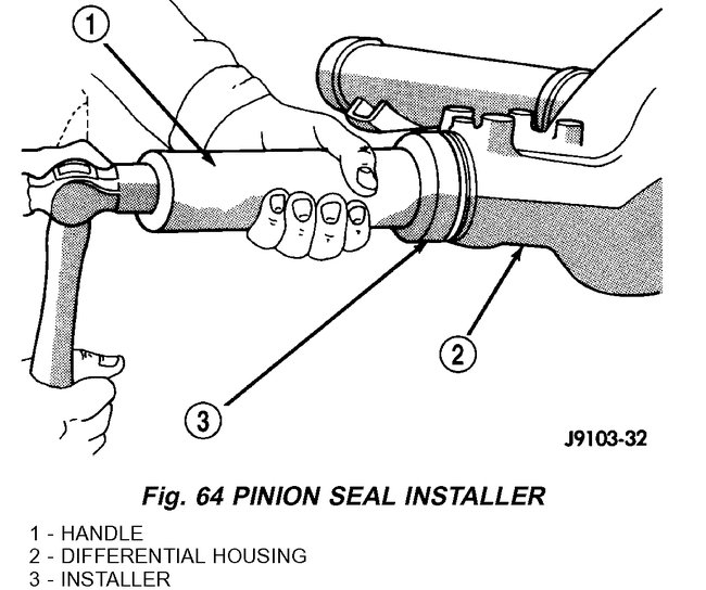

5. Apply a light coating of gear lubricant on the lip of pinion seal and install seal (Fig. 64) with Installer C-4076-B (3) and Handle C-4735 (1).

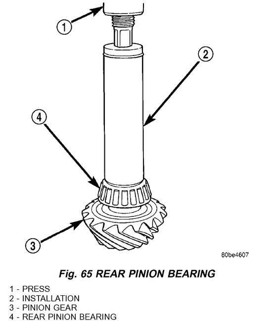

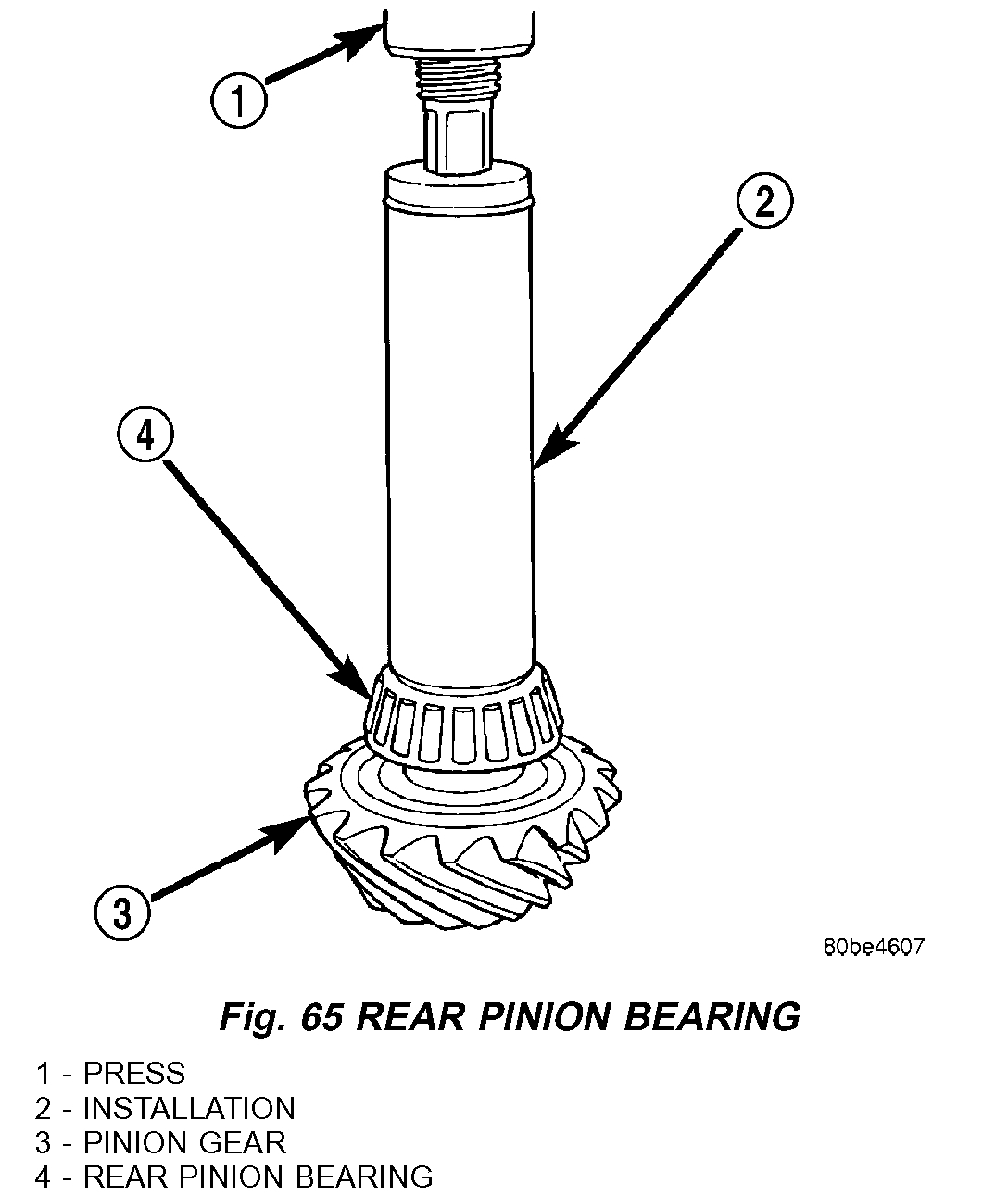

pic 11
7. Install rear bearing (4) on pinion gear (3) and slinger if equipped, with Installer 6448 (2) and a press (1) (Fig. 65).

8. Install a new collapsible spacer (1) on pinion shaft (3) and install pinion in housing (Fig. 66).

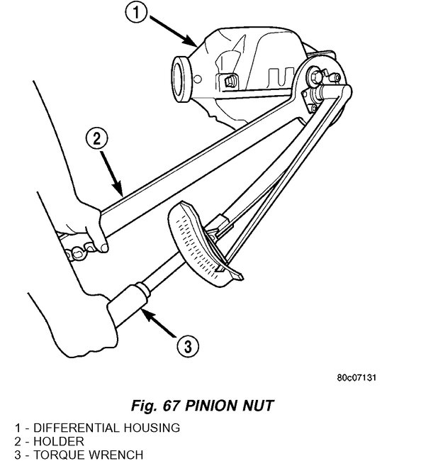

11. Holding flange with Holder 6719A (2) and tighten nut with torque wrench (3) to 285 Nm (210 ft. lbs.) (Fig. 67).
CAUTION: Never loosen pinion nut to decrease pinion rotating torque and never exceed specified preload torque. Failure to heed caution may result in damage.
12. Hold yoke with Holder 6719A and slowly tighten the nut in 6.8 Nm (5 ft. lbs.) increments until the desired rotating torque is achieved. Measure rotating torque frequently to avoid over crushing the spacer.

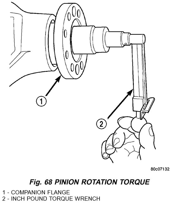

13. Check pinion (1) rotating torque with an inch pound torque wrench (2) (Fig. 68). The pinion gear rotating torque should be:
^ Original Bearings: 1 to 2 Nm (10 to 20 inch lbs.).
^ New Bearings: 1 to 5 Nm (10 to 30 inch lbs.).

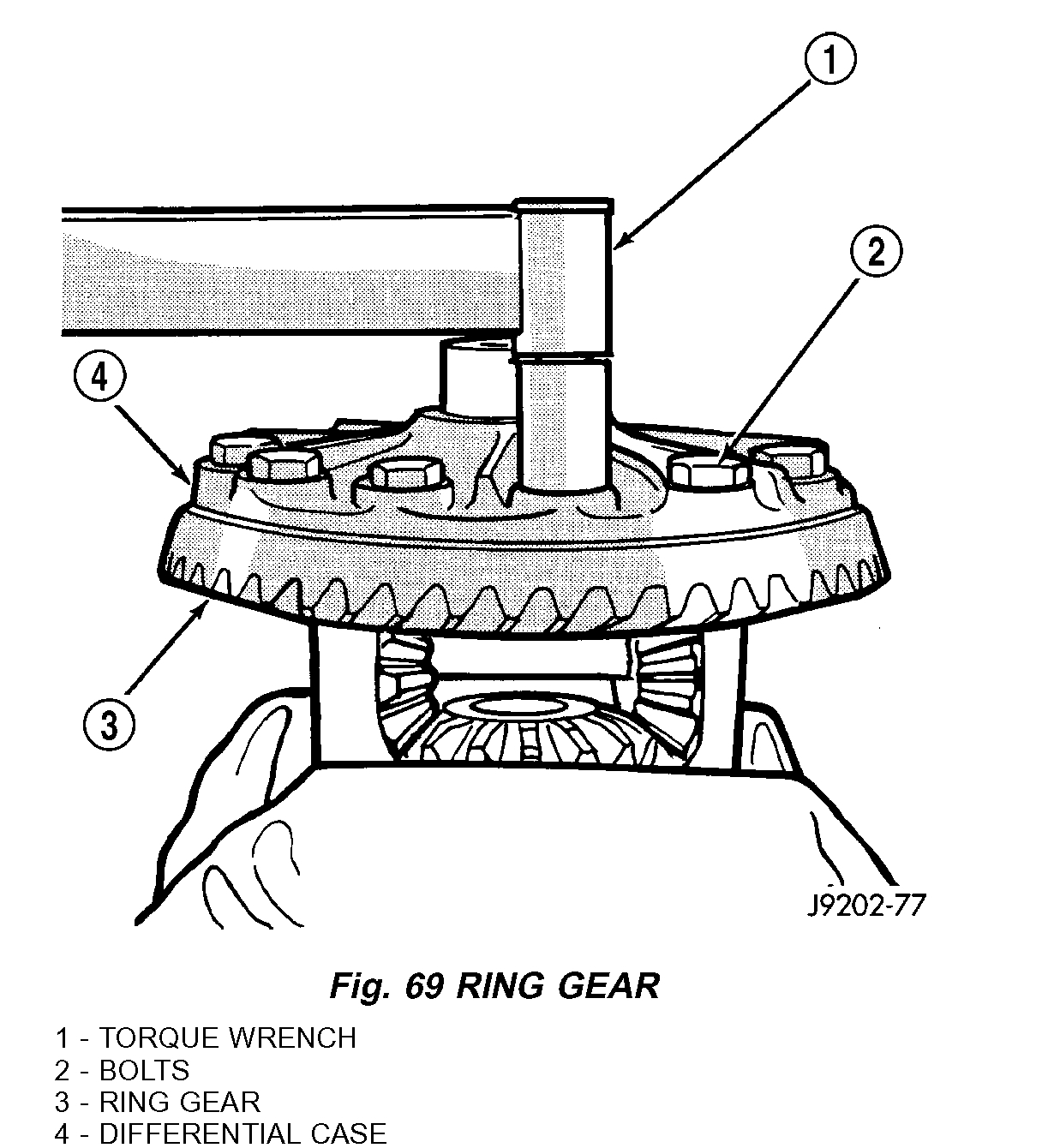

pic 15
14. Install ring gear (3) on differential case (4) and start two ring gear bolts (2) (Fig. 69).
15. Invert differential case in the vise.
16. Install new ring gear bolts and alternately tighten to 102 Nm (75 ft. lbs.).

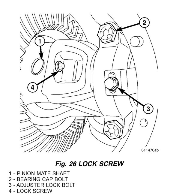

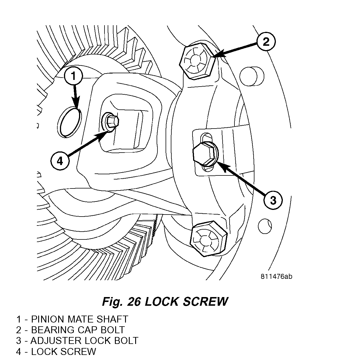

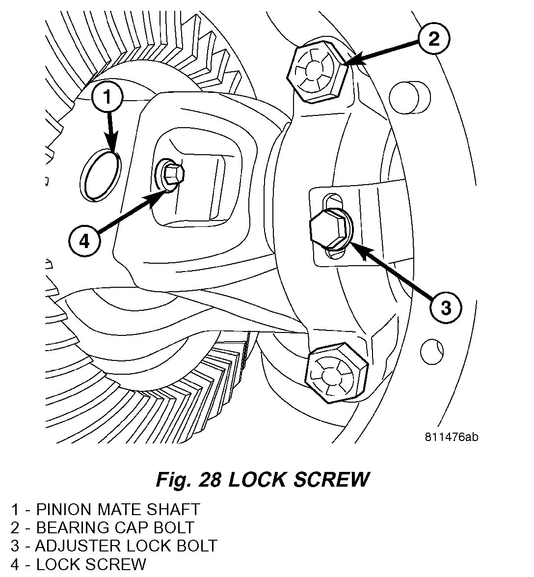

3. Rotate differential case so pinion mate shaft (1) lock screw
PIC 16
4. is accessible (Fig. 26). Remove lock screw and pinion mate shaft from differential case.
PIC 17

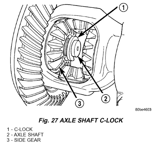

4. Push axle shaft (Fig. 27) inward and remove axle shaft C-lock (1) from the axle shaft (2).
5. Remove axle shaft from side gear (3) and axle tube.

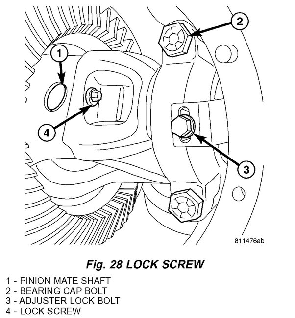

PIC 18
4. Install pinion mate shaft (1) into differential case and through thrust washers and differential pinions (Fig. 28).
5. Align hole in shaft with hole in the differential case and install lock screw (4) with Loctite on the threads. Tighten lock screw to 11 Nm (8 ft. lbs.).

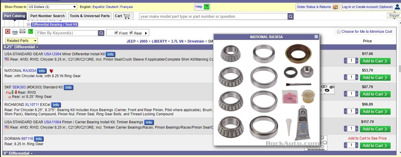

Let me know what you find. Also, I looked at the link you purchased. If the pinion bearings are the issue, you got way more than you need. You ordered everything.

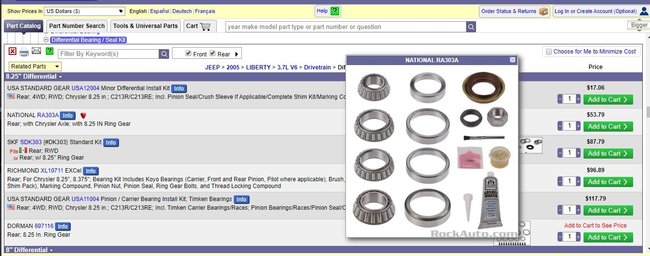

Can you show me a link of just the pinion bearing and the exact part i would need? When i search pinion bearing i see things like slinger as cheap as 5 and other bearing and cup things for 55, just trying to figure out exactly what i need. Thank you
Feb 27, 2020 at 10:11 PM
CASMIHOK
  • 205 POSTS
https://shop.advanceautoparts.com/p/driveworks-taper-bearing-set-s-a-36/5050731-P
Is this what i need? Aren't there two bearings or am i incorrect?
Feb 27, 2020 at 10:28 PM
I attached a bearing kit for you. It has races, bearings, crush collar, seal and all you need for this procedure. Since you will need to remove the carrier, those bearings and races are there as well.
Feb 28, 2020 at 4:27 AM
CASMIHOK
  • 205 POSTS
Okay thank you, so I will use all of that?
Feb 28, 2020 at 11:03 AM
Yes, you will use all of that.
That is a good price for all those parts.
