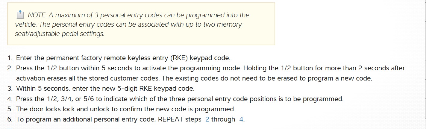

I have the keyless pin pad on the side of my trucks driver door I wasn't given the pin for it I was wondering where I could get the pin without having to pay for it

try ford with your registration to show proof of ownership. 3 separate codes can be entered so try what is in the pic. Check out the images (below). Let us know if you need anything else.
