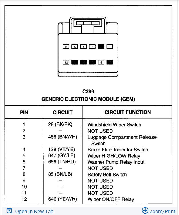

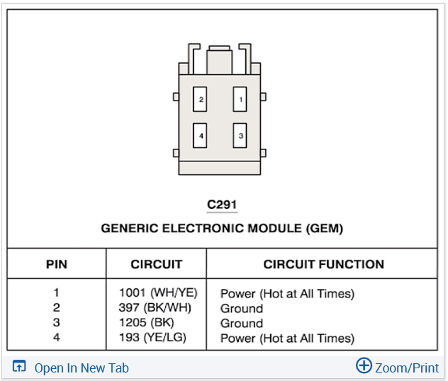

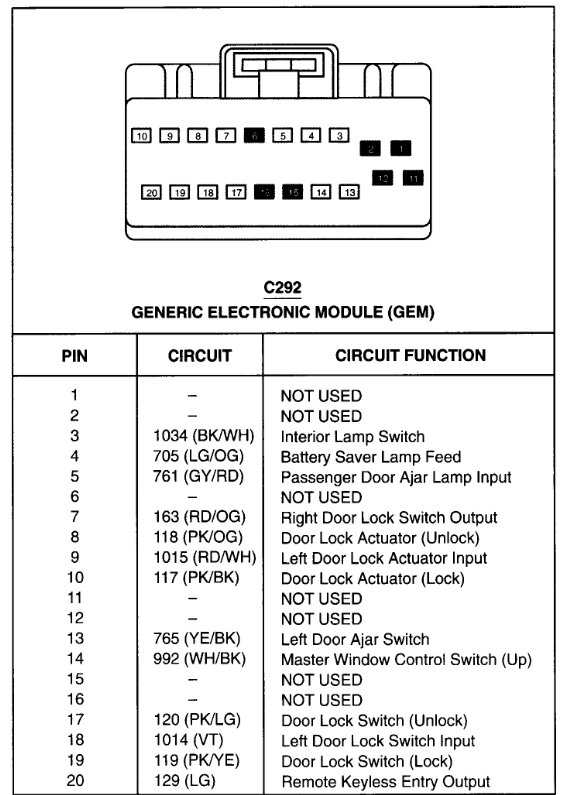

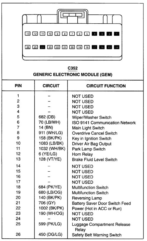

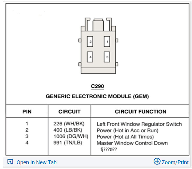

my gem module is having a parasitic draw. it would help me if I had a pin out for it and know what is controls. thank you
Jul 19, 2025 at 7:09 AM
  • 55,588 POSTS
Usually it is the GEM itself that goes bad and draws the battery down, FYI. Here are the pinouts for the GEM. Check out the images (below). Please let us know what happens.
