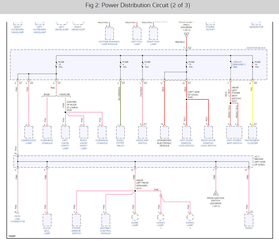

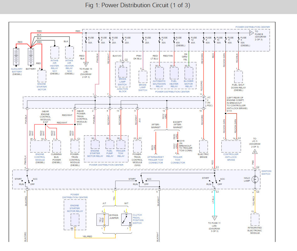

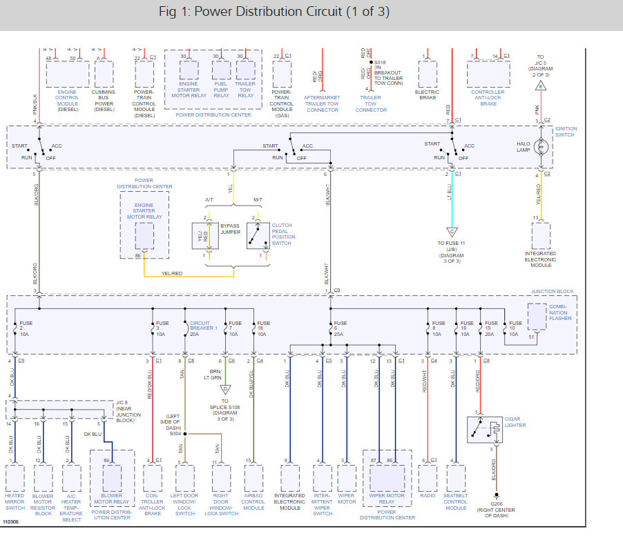

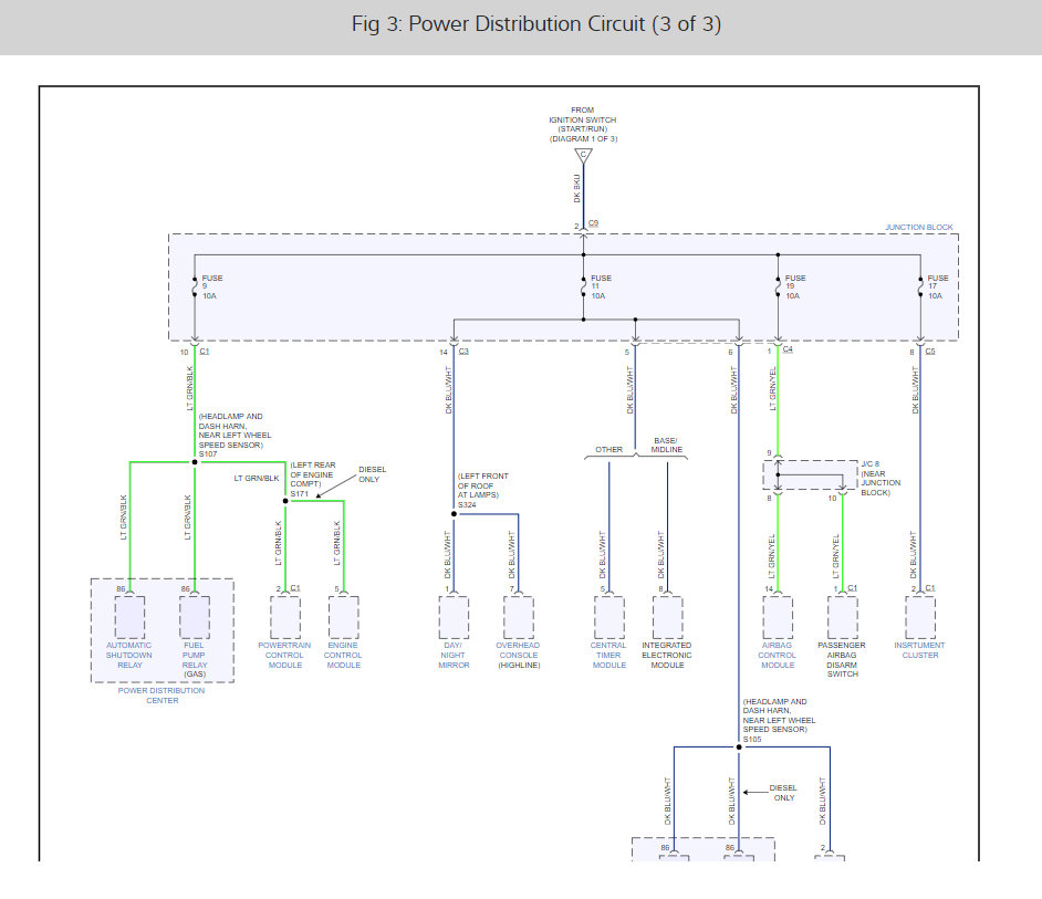

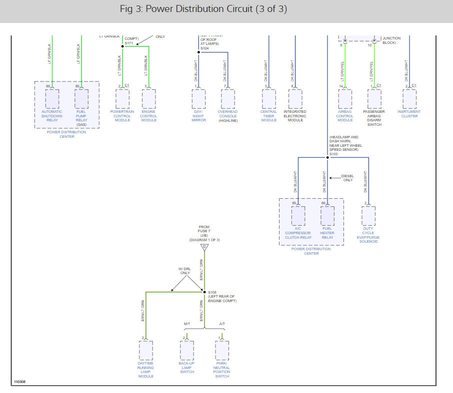

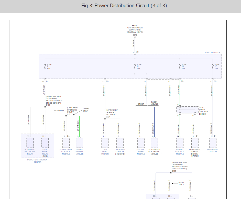

Fuse panel wiring diagrams please?
1999 DODGE RAM
230,000 MILES • 5.2L • V8 • 4WD • MANUAL
318TJ

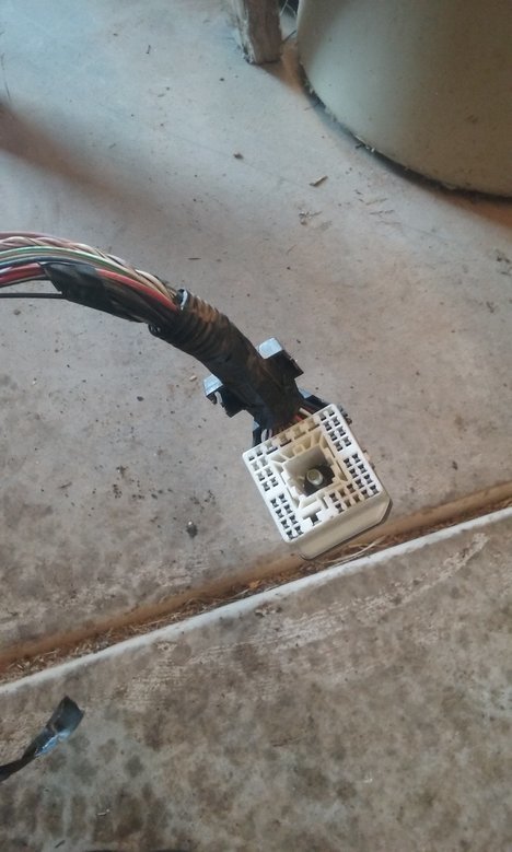

I looked through the field service manual and could not find a connector pin out for the engine-inline junction. Currently swapping a 5.2 V8 into my 2001 Jeep. Donor vehicle is a 1999 Ram 1500. The only thing that's holding me back is I have no idea where these wires go when they come out from the bottom of the fuse box. Any help would be appreciated.

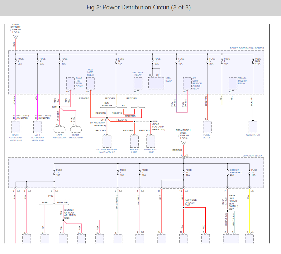

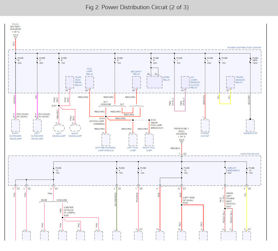

Here is the fuse panel wiring diagrams so you can make the necessary connections with a guide to help as well:
