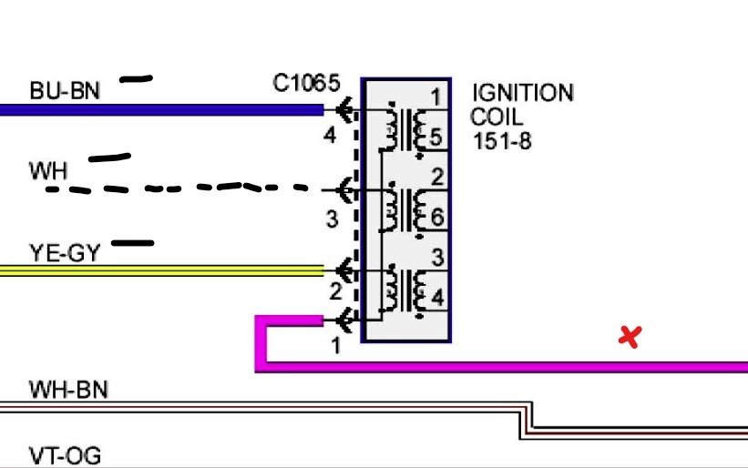

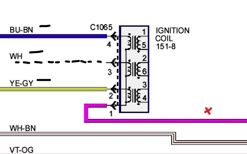

My 2007 Ford Ranger 4.0L automatic died with a code for ECM, replaced with a rebuilt, had keys programmed by mobile service, still would not start.
Found a thread that said to hook battery to a charger and turn key to on for 20-30 minutes, then do the same with the second key.
After doing so, the engine started but with a miss and coded P3501 coil A circuit open.
I replaced the coil with the same result.

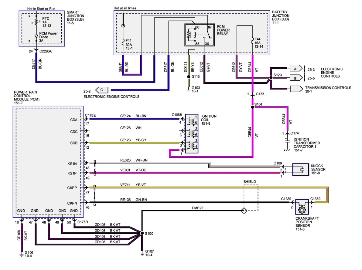

I noticed the coil wiring connecter if 4 wire, I assume 1 power wire and three ground trigger wires controlled by the ECM?
Assuming that the trigger fires two coils at a time, one cyl on power stroke one on exhaust stroke, assuming as code is for cyl A only? looking for PCM pinout and diag procedure are node lights available for testing trigger signal?
Thanks for any and all guidance.

You are correct, the ignition uses one power feed (Purple wire) and three trigger wires Yellow/gray, White and a Blue/brown. In your case the Blue/brown wire is the trigger for the 1-5 coil. The ECM is programmed to read the current ramp that fires the coils and monitors it based on each cylinder firing. So when it fires the 1-5 coil it looks at which cylinder should be in position to fire and produce power and reads the return pulse to determine if the coils fired. If the coil returns a pulse different than expected you get the P0351 code because on that engine that code covers both primary and secondary ignition. That can be caused if there is an internal cylinder issue (lowered compression or poor fuel mix) or if something like the plug wire or plug are not firing because of a failure, like carbon tracking on a cracked plug or a damaged plug wire. Very rare for it to be the coil itself unless the tower for a wire is damaged. Because the system is waste spark and you are not seeing anything about cylinder 5 as well, it isn't the PCM or the wiring to the coils that is the issue, or you would have a 2 cylinder misfire (1 and 5). As you only have the code for cylinder one then I would look at the plug wire and plug for that cylinder. See if there is some damage to either one. I have seen this code for plugs that were gapped improperly or if they were damaged (commonly carbon tracking)
