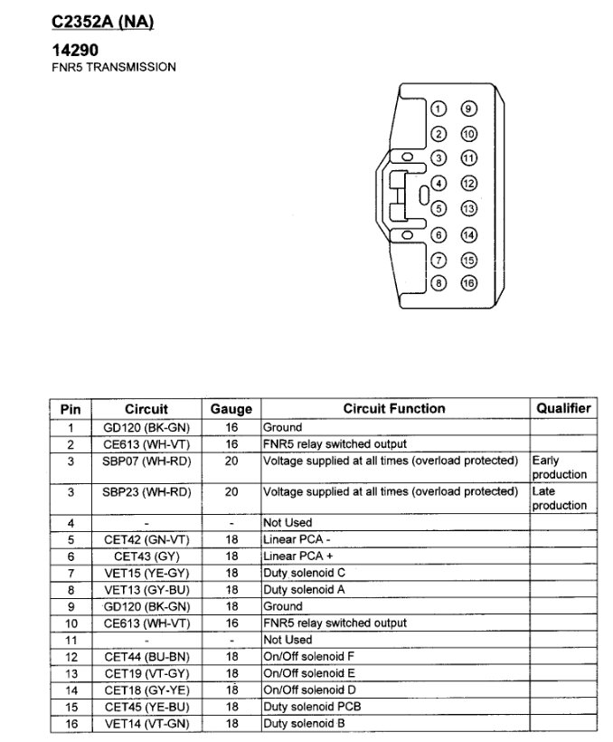

i need the pin description for transmission control module?
149,000 MILES • 3.5L • 6 CYL • 4WD • AUTOMATIC
GREG GARCIA
The female connector is damaged and i pulled the wires out of the female without getting a picture of it.
Mar 10, 2025 at 12:13 AM
  • 55,710 POSTS
There is no transmission control module, I assume you are talking about the main wiring connector for the transmission, correct? If so, here is the pinout and wiring locations for the electrical connector. Check out the images (below). Let us know if you need anything else.
