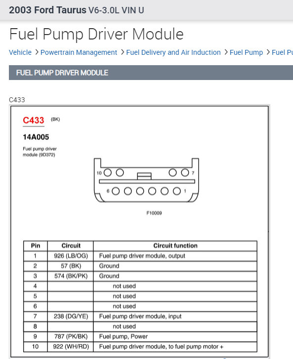

Pin for fuel pump module needed
160,000 MILES • 3.0L • AUTOMATIC
4MRPERKINS
Color code for fuel pump module.
Dec 24, 2021 at 3:23 PM
SQM
  • 6,383 POSTS

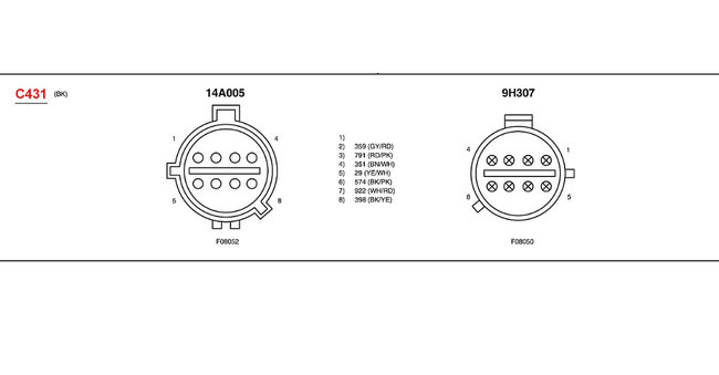

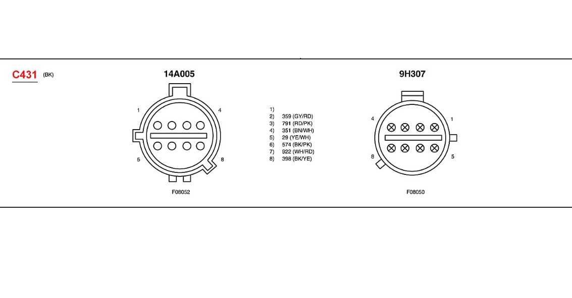

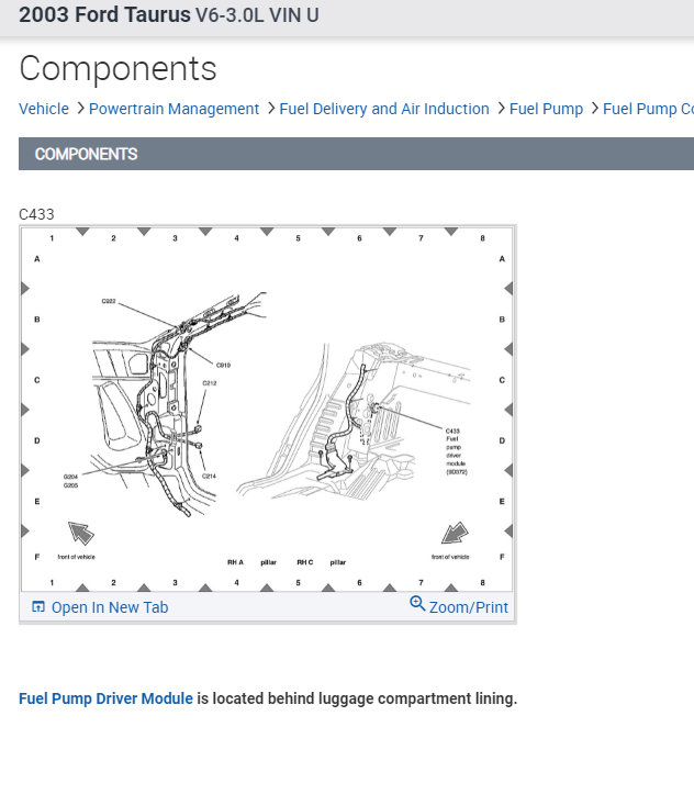

I have attached the fuel pump drive module pinout as well as the fuel pump pinout below (not sure which one you are looking for).
The fuel pump drive module is located under the cargo area lining.
