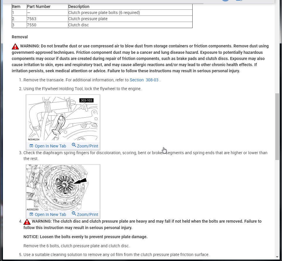

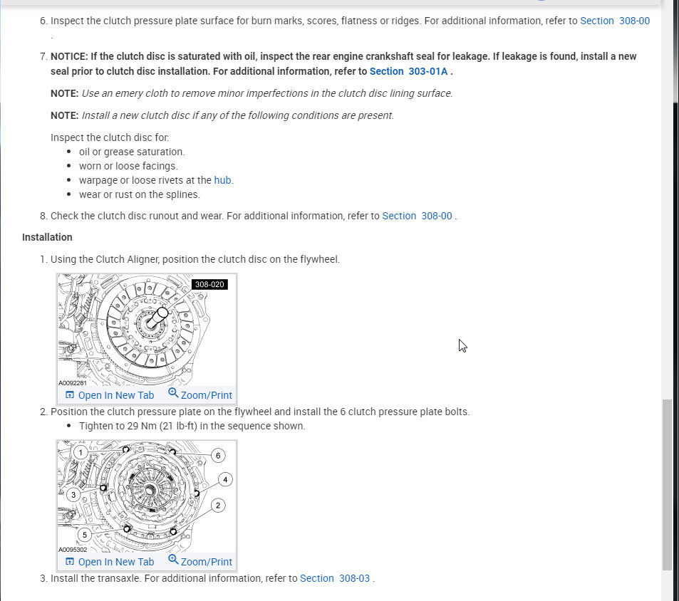

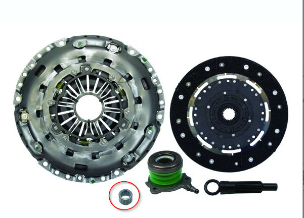

Yes. There is a pilot bearing. Here is a link to a parts website and as you can see in the clutch kit, the pilot bearing is included:
https://www.rockauto.com/en/catalog/ford,2011,escape,2.5l+l4,1446839,transmission-manual,clutch+kit,1993
I also included the process that shows when you line up the clutch you can see the bearing is installed.
Let us know if you need more info. Thanks

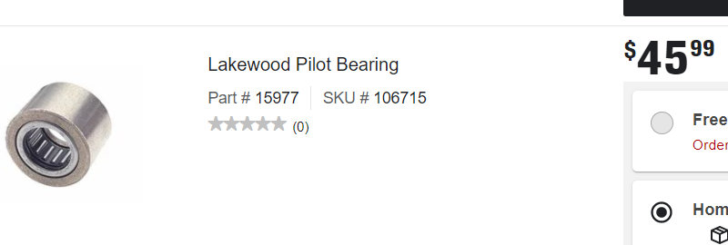

Yes, to answer your question there is a pilot bearing that is in the crankshaft the transmission input shaft fits into. I've attached a picture below of one that is available from the parts store AutoZone. Let us know if you need any repair guides for clutch replacement. Hope this helps and thanks for using 2CarPros.

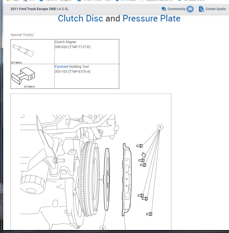

Hello, thanks but it doesn't tell me that there's supposed to be a pilot bearing in the end of the crankshaft for the transmission input shaft in specifically my vehicle.
Oct 11, 2020 at 10:11 AM
Can you explain a little bit more why you think there may not be? Danny and I separately confirmed and found the same info. There is a pilot bearing there because if there were not you would have the input and crank going metal to metal and it would wear out in less then 100 miles.
Have you taken it apart and not found the pilot bearing? Just trying to better understand the issue so we can assist. Thanks.

Hello, I did some looking at Ford dealership schematic they have shows no pilot bearing in my Escape! I can't believe it but there wasn't one to begin with so I'm not using it. Thanks for your help everyone!
