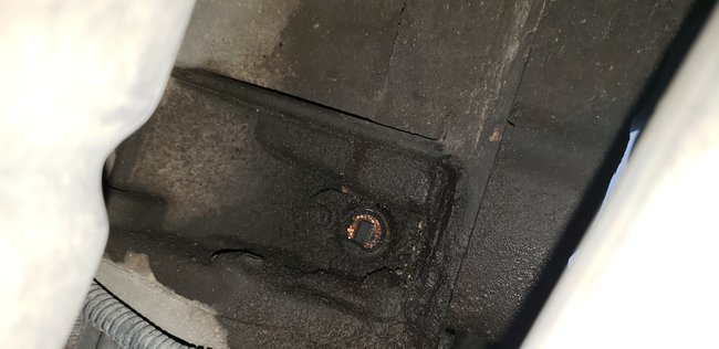

Okay, I recently discovered a hole in my transmission on the passenger side. It is right up by the exhaust with the exhaust coming through to the back of the vehicle. so, it's hard to see but I did get a picture of it there is a circuit board it looks like on the inside of it. I am wondering what is supposed to be plugged into here and there's also a pigtail harness just dangling there since about the vehicle, and I've always wondered what that was to plug into, and I am guessing that is where it's supposed to be plugged into, I just don't know what it plugs into. Any information would be great, and my vehicle has been running very rough lately my output speed sensor is running a code and so is my O2 sensor because I have that unplugged. I don't know if this photo will help but this is on the passenger side of transmission.

That is what is left of the output speed sensor. The bolt next to it comes out and the sensor gets removed and replaced with a new one, Spray around it with some brake cleaner to remove the crud then spray on some penetrant. Be gentle while removing it you want to get the entire thing out and the O-Ring on it tends to stick and you can break it inside the transmission. Then plug the wire back into it and the error code should go away.
Then reconnect the O2 sensor as that is likely the cause of the rough running and left disconnected can destroy the converter as well as cause a lot of extra wear in the engine due to it running rich.

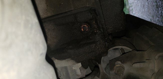

Here is the braided ground cable I am seeing on the passenger side by the transfer case.

Don't see a braided cable. I see what looks like wire loom which is likely for the sensor that is missing in the middle. Once you replace the speed sensor and plug it in see if that code goes away.

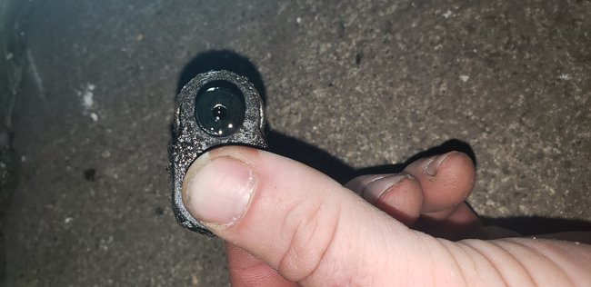

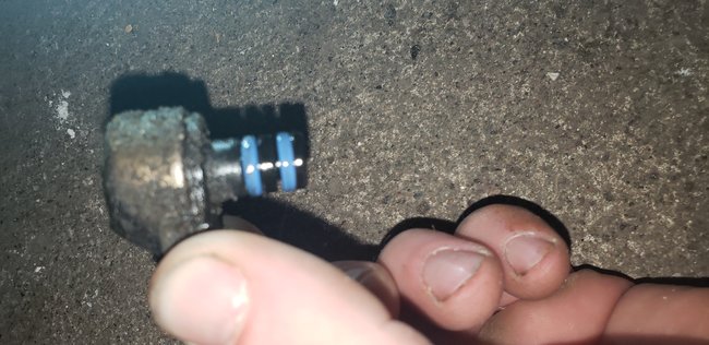

Okay, well, got the sensor and took out the old. The sensor doesn't fit into the harness that is unplugged. The harness on the Jeep has four holes to plug into it and the speed sensor only two prongs. I am not so sure if this is a transmission speed sensor that broke off. I'll send you a picture of what is left of it after we had taken it out of the right side of the transfer case.

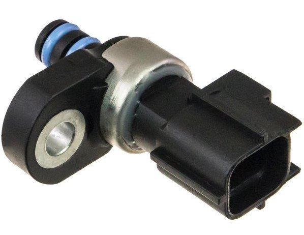

Okay, that looks like the pressure transducer, should be three wires from the plug. Mopar part 4799758AF

Yes, I found it on this webpage:
https://cardiagn.com/jeep-parts-list-1999-wj/

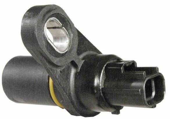

My scanner is reading a code for the output speed sensor so got that part and just need to put on and then the pressure sensor will be next when I get paid. Thanks for all of your help!

If you are looking for parts and want to buy, online take a look at rock auto. The output speed sensor is on the opposite side from the pressure transducer. That will be the part you already have.
