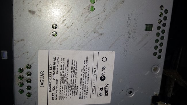

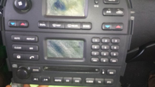

Good morning, can you please tell me which number is the correct serial number on the radio? Please see image number 1.In addition image number 2 shows how the radio looks.Thanks in advance.

Hello, I'm Danny.
If you're looking to get the radio code I would need the VIN number. Hope this helps and thanks for using 2CarPros.

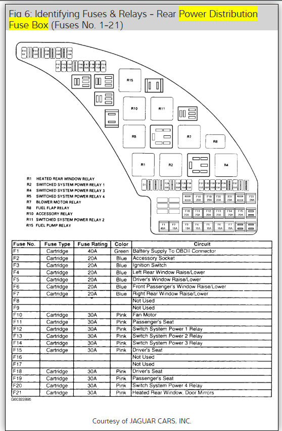

Hello Danny, I tried but it didn't work. Do you know any other method? I wonder if it needs programming because there is no sound coming from it and I cannot see the display screen clearly.
Jul 10, 2019 at 7:12 AM
DANNY L
  • 5,648 POSTS
What was the original reason for the disruption? Disconnected battery, Replacement stereo, etc?
Danny-
Jul 10, 2019 at 7:43 AM
AUSTINO
  • 228 POSTS
okay sir,the vehicle was crashed and from that happen, the radio stop working.
Jul 10, 2019 at 8:11 AM
  • 55,423 POSTS

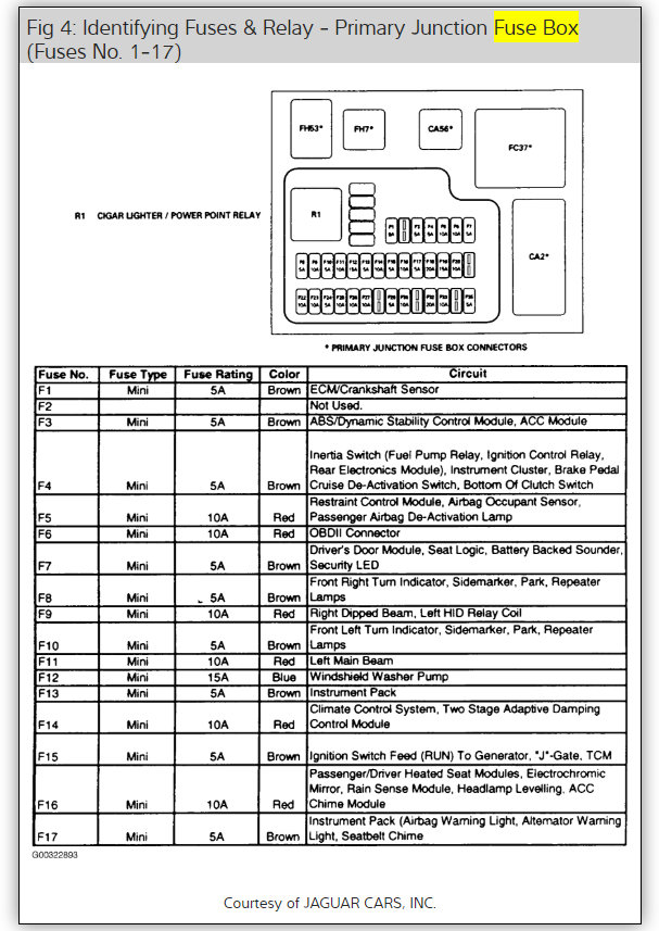

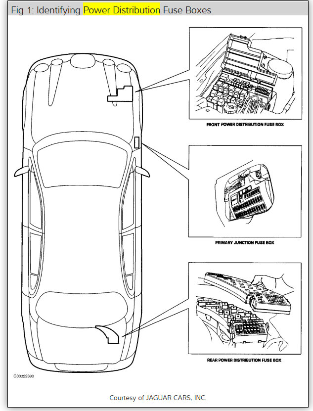

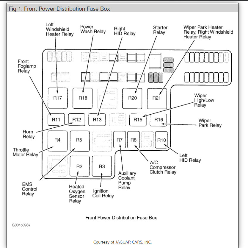

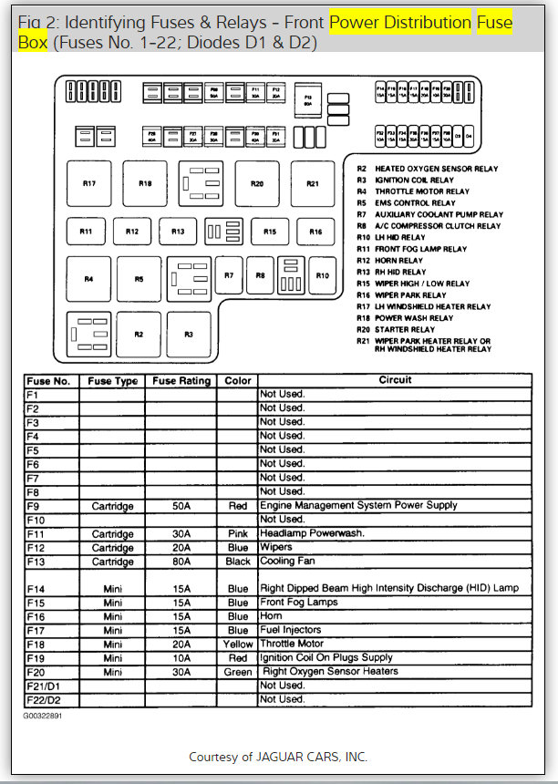

Did you check foe power at the fuses. here is guide and the fuse locations as well:
Jul 13, 2019 at 6:46 AM
AUSTINO
  • 228 POSTS
Thank you for that sir.I forget to tell you that the battery was disconnected.Could that also cause a problem?
Jul 13, 2019 at 7:10 AM
  • 55,423 POSTS
Yes, you can have a voltage spike that causes this issue. Did you change the fuses?
Jul 15, 2019 at 4:06 AM
AUSTINO
  • 228 POSTS
Thank you Sir, and no I did not change the fuses.Can you please tell me where to find this fuse for the radio and show me an image of what it looks like.Thanks
Jul 15, 2019 at 5:15 AM
  • 55,423 POSTS
Yep, check the images in the post above it shows all fuses and the radio system fuses as well.
