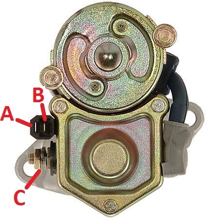

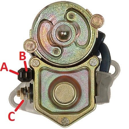

Sorry for not replying I haven't had a chance to work on it. I checked the grounds and they all seem good. I did however find out that there is power going to both connections on the starter, the big connection that goes straight from the positive on the battery and the solenoid connection from the starter. Both of them have 12.62 volts, but when I turn the key to start the volts on the solenoid connection drop to 1. Is it supposed to do that? Is there supposed to be power going to both connections all the time?

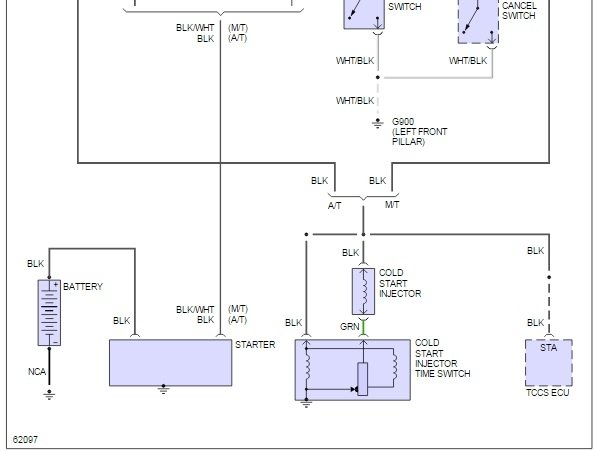

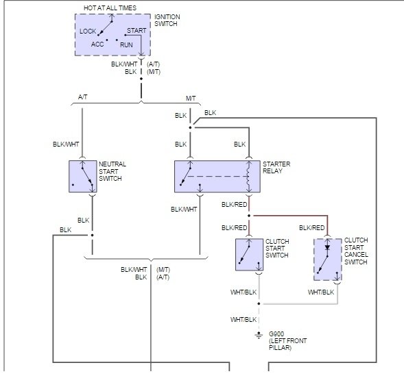

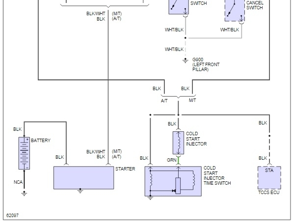

ANY PROGRESS ON YOURS?
I GRABBED A STARTING SYSTEM DIAGRAM FOR YOUR RIG FROM "PRODEMAND". KINDA A FLOW CHART "M/T" IS MANUAL TRANNY, "A/T" IS AUTOMATIC TRANNY
I HAD TO MAKE SCREENSHOTS, AS IT WOULD NOT ALLOW ME COPYING IT.
DIAGRAM 1, IS THE TOP HALF/ DIAGRAM 2 IS THE BOTTOM HALF (THEY OVERLAP)
I MADE PIC 3 SO YOU MIGHT SHOW WHAT VOLTAGES WERE WHERE

I TRY AGAIN
KINDA SOUNDING LIKE THE IGNITION SWITCH
LOOK THE DIAGRAM OVER, IT'S PRETTY SIMPLE
PIC 1 IS THE TOP HALF (THEY OVERLAP) ALSO LOOKS LIKE THE 2nd ONE POSTED LARGER THAN THE 1st
