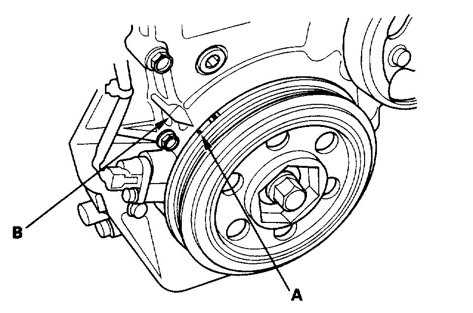

1. Remove the front wheels.
2. Remove the splash shield and the engine undercover.
3. Remove the drive belt.
4. Turn the crankshaft pulley so its top dead center (TDC) mark (A) lines up with the pointer (B).
pic 1

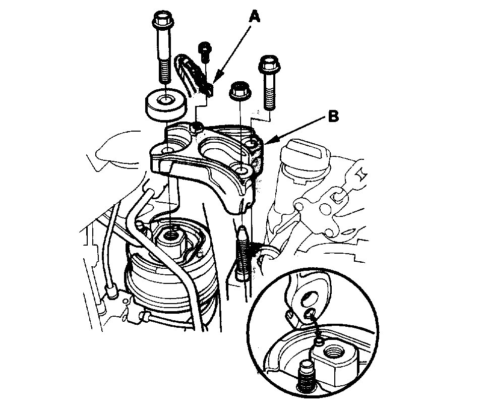

10. Remove the ground cable; (A), then remove the side engine mount bracket (B).
pic 2

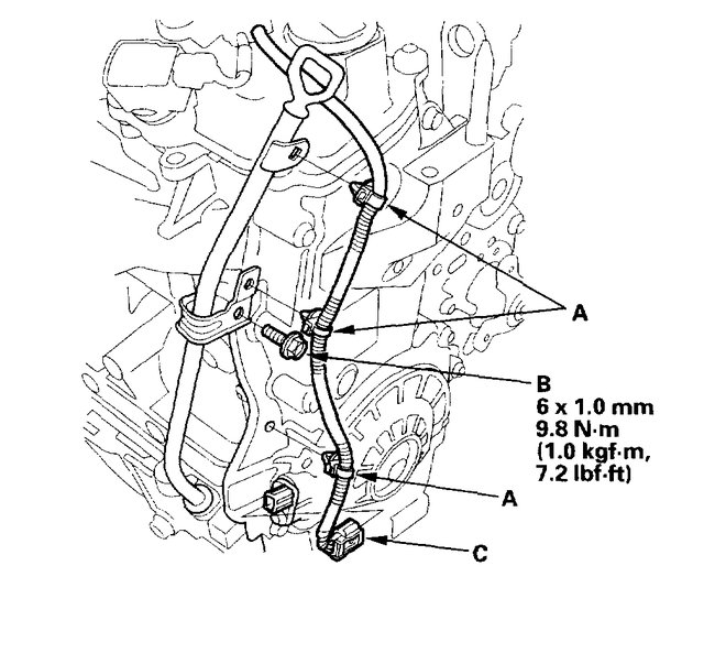

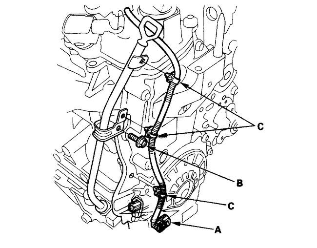

11. Disconnect the crankshaft position (CKP) sensor connector (A), then remove the dipstick tube mounting bolt (B) and the harness clamps (C).
pic 3

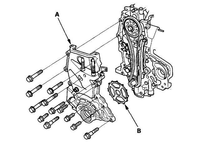

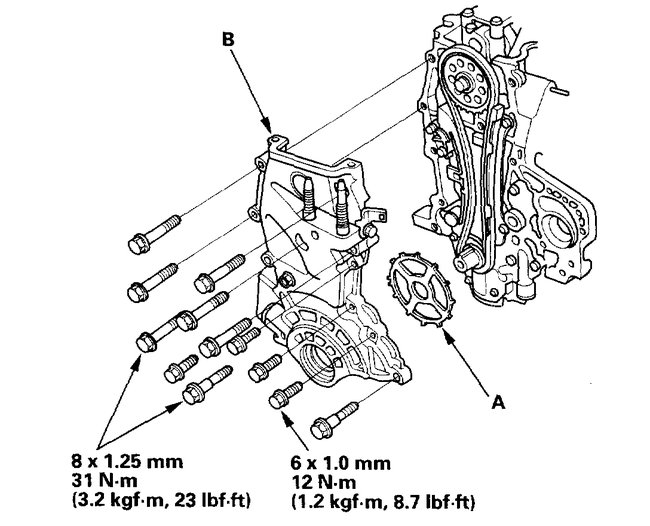

12. Remove the chain case (A), then remove the pulse plate (B).
pic 4

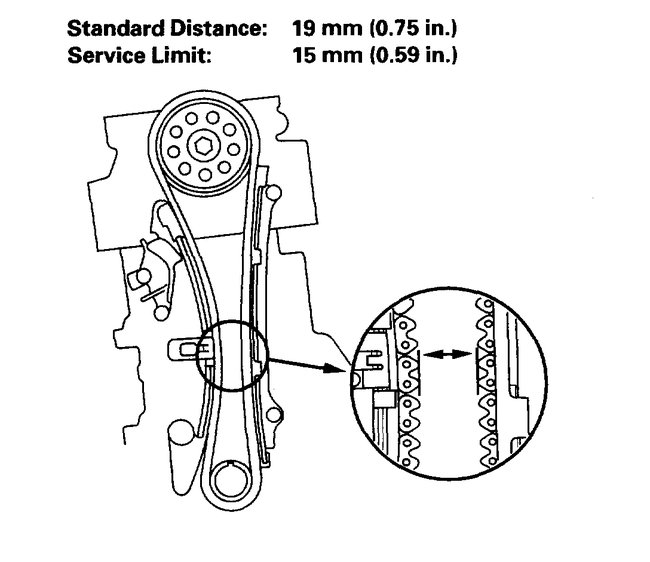

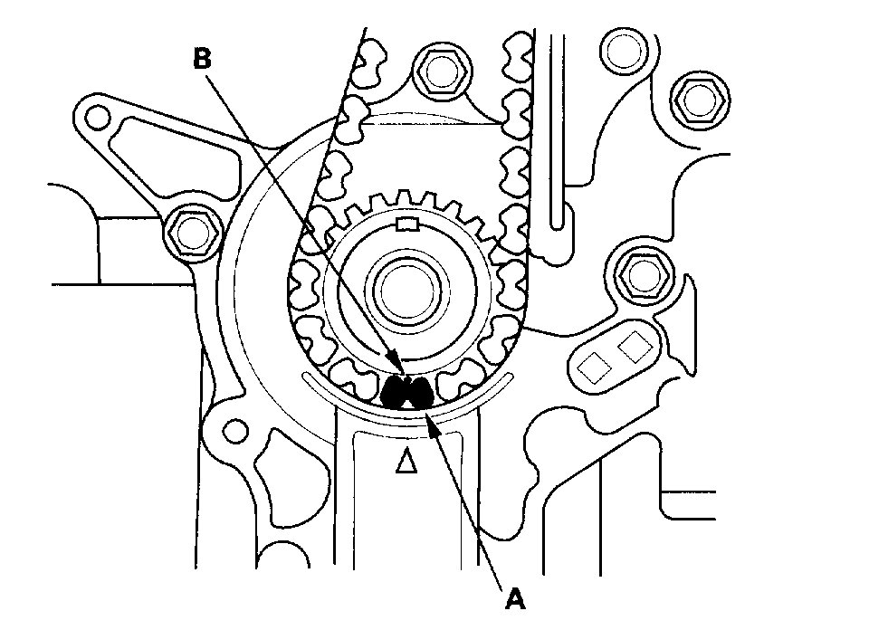

13. Measure the cam chain separation. If the distance is less than the service limit, replace the cam chain and the cam chain tensioner.
pic 5

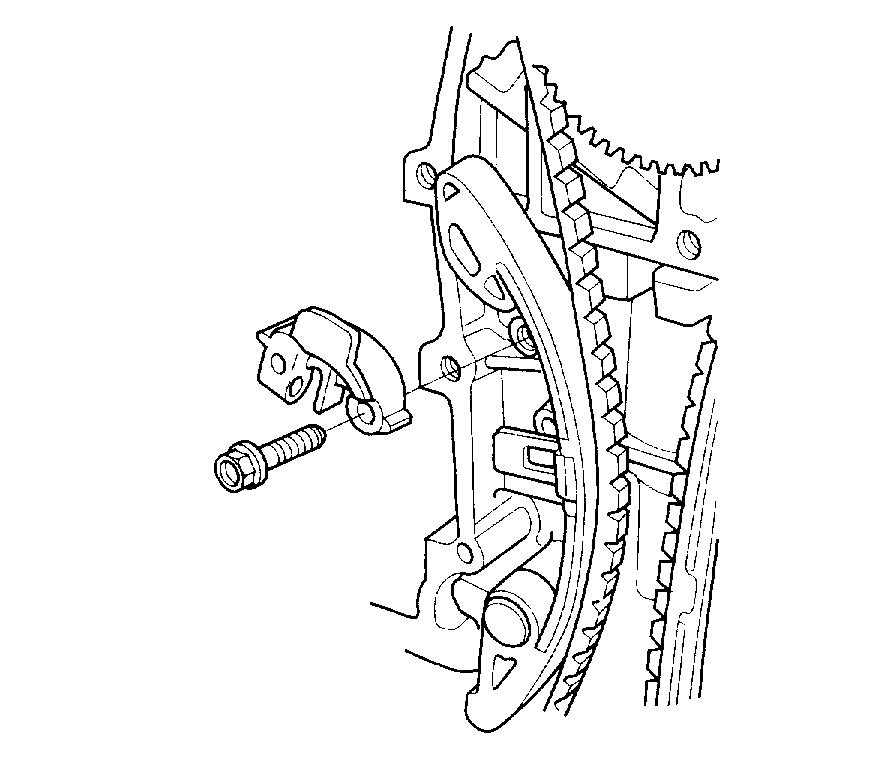

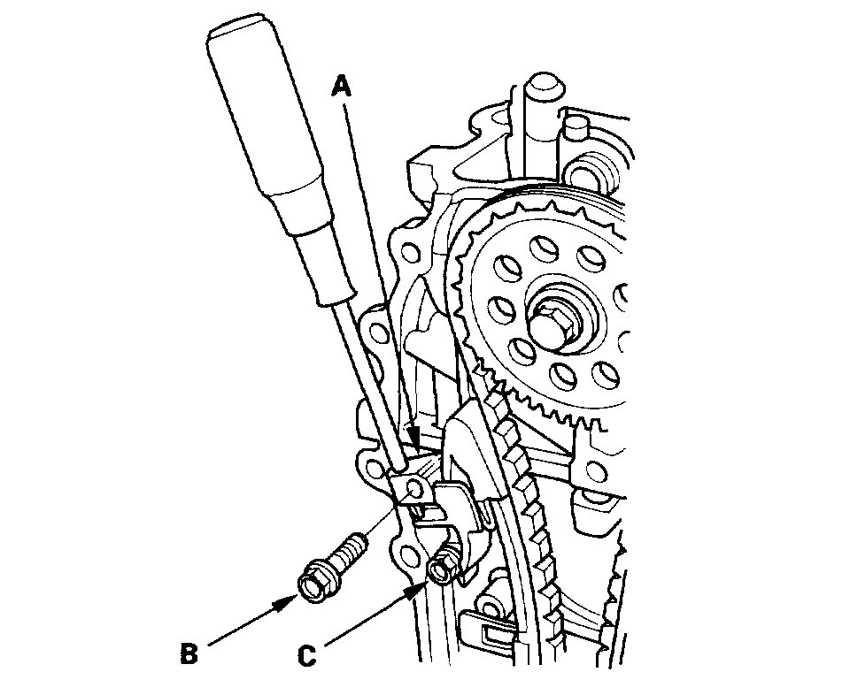

14. Apply new engine oil to the sliding surface of the cam chain tensioner slider (A).
pic 6

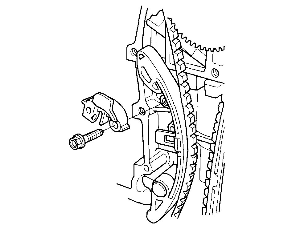

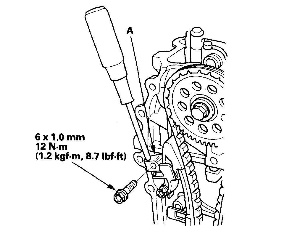

15. Hold the cam chain tensioner slider with a screwdriver, then remove the bolt (B), and loosen the bolt (C).
16. Remove the cam chain tensioner slider.
pic 7

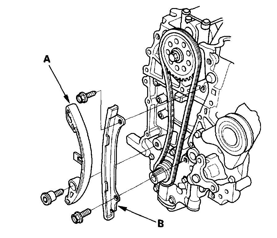

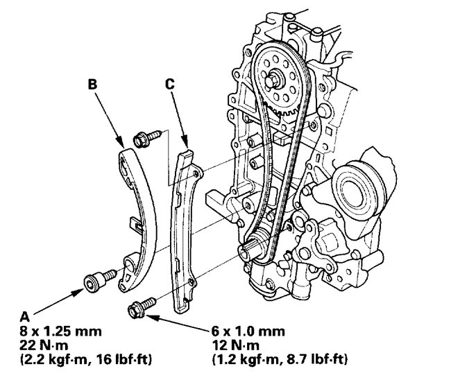

17. Remove the cam chain tensioner (A) and the cam chain guide (B).
pic 8

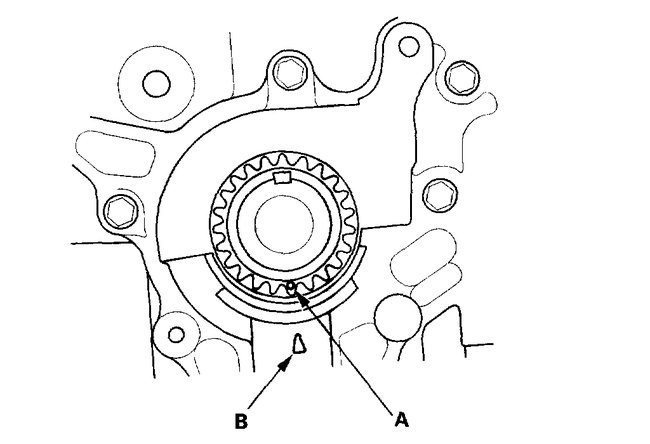

1. Set the crankshaft to top dead center (TDC). Align the TDC mark (A) on the crankshaft sprocket with the pointer (B) on the oil pump.
pic 9

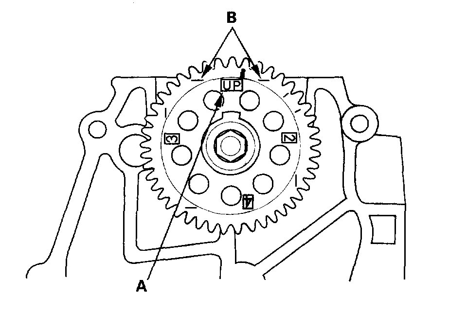

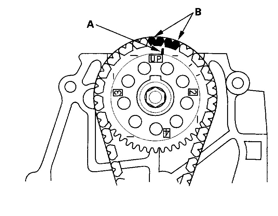

2. Set the No. 1 piston at TDC. The "UP" mark (A) on the camshaft sprocket should be at the top, and the TDC grooves (B) on the camshaft sprocket should line up with the top edge of the cylinder head.
pic 10

4. Install the cam chain on the camshaft sprocket with the pointer (A) aligned with the center of the two colored pieces (B).
pic 12

6. Install the cam chain tensioner (B) and the cam chain guide (C).
7. Install the cam chain tensioner slider, and tighten the lower side bolt loosely.
pic 14

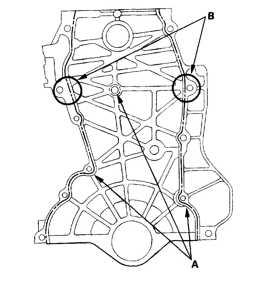

13. Apply liquid gasket, P/N 08717-0004, 08718-0001, 08718-0002, 08718-0003, or 08718-0009, to the cylinder head and engine block mating surface of the chain case.
NOTE:
^ Apply a 1.5 mm wide bead of liquid gasket along the broken lines (A).
^ Apply a 3.0 mm wide bead of liquid gasket to the engine block upper surface contact areas (B) on the chain case.
^ Do not install components if too much time has passed after applying the1iquid gasket (for P/N 08718-0002, no more than 4 minutes, for all others, no more than 5 minutes). Instead, remove the old residue and reapply the liquid gasket.
pic 16
14. Install the crankshaft position (CKP) pulse plate (A) and the chain case (B).
NOTE:
^ Wait at least 30 minutes before filling the engine with oil.
^ Do not run the engine for at least 3 hours after installing the chain case.

15. Install the harness clamps (A) and the dipstick tube mounting bolt (B), then connect the CKP sensor connector (C).
pic 18

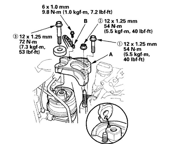

16. Install the side engine mount bracket (A), then tighten the mounting bolts and nut in the numbered sequence shown.
pic 19
