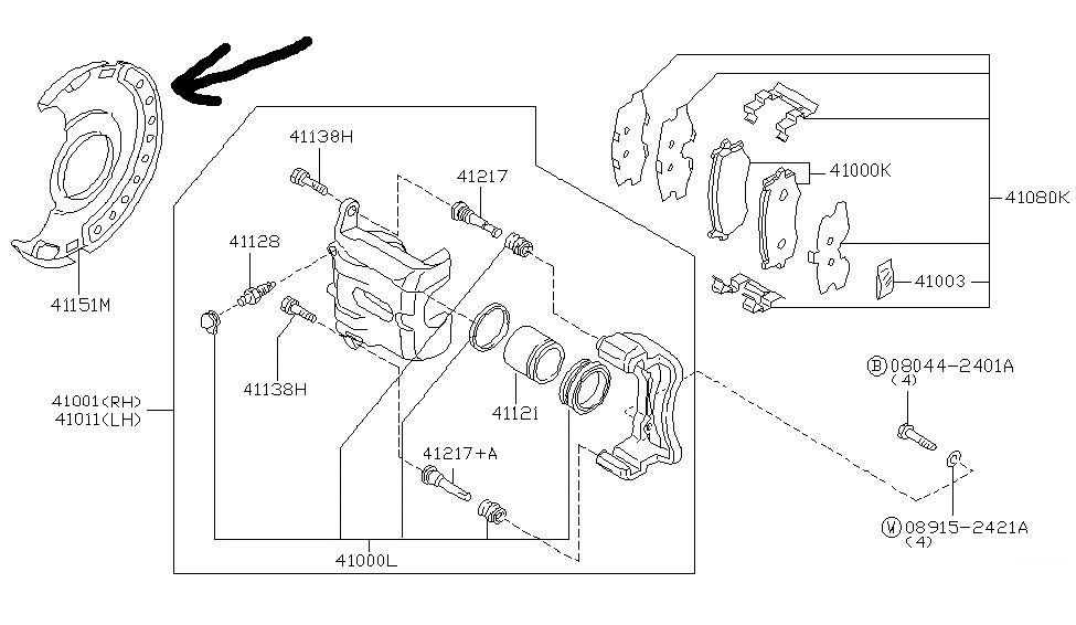

Since given this car three years ago, there has been this ratcheting, dragging sort of noise coming from inside the driver side front wheel. Had brake pads, rotors, and right front axle replaced eighteen months ago-with no effect on this noise. Have now been told by a mechanic that the left axle, and the brake pads need replacing, and that it is this axle problem that affected my newish brake pads, and, most significantly, is causing the noise that I have described. Yet, how can this be when I have been hearing this noise before getting new brakes and the new axle, and the actions had no effect on this noise. Do not hear the clicking, upon turning, nor do I perceive any vibrating, shaking or shuddering. Only if I go over seventy five mph, there is some mild shuddering. This noise begins as soon as I start driving forward and continues until I reach about forty mph, or above, at which point it completely stops, until I slow down again. The noise occurs during turning and when driving straight. Recently, I have noticed it seems louder, and also now has a sort of echoing, it hollow quality to it. Any thoughts on this? Would be so very grateful to hear them.

Jerry, the manager at Meineke, called around 9:30 am to say that the work on my car. Was completed, and that I could pick it up. Since he had told me yesterday that he would call me today once he positively identified the cause of that noise, I assume so that he could tell me the cost, and verify that I wanted him to do that repair, I was somewhat surprised when he did not mention it at all. So, of course, I asked him about it. He replied, "Oh, that is just the baseplate occasionally scraping the rotor (exactly what he guessed, right after hearing the noise). He then implied that some sort of adjusting was done, as he specifically said that "You can barely hear it anymore.". He did not mention any charge for this. Also, yesterday, he had told me that the diagnostic work done to identify the cause of that noise would not cost me anything.". I asked him, during that call today, if that meant that it would not be problematic to drive the car with the baseplate? Scraping the rotor? He said "No.". My question for you is does that sound "right" to you, or do you think that this scraping could potentially shorten the longevity of the rotor? I have to wonder if this could explain why the brake pads and rotors had needed replacement twice within 2 years. Do you have any idea, without seeing my car, if the baseplate is something with only limited adjustability? Yes, the car is almost 19 years old, but for the most part, it runs great, and actually passes Emissions. However, I can appreciate the age of the car possibly influencing the outcome of reasonable options. I know nothing, at this point, about baseplates, although I am sure I will be doing some research prior to picking up my car. For the most part, I feel like I should just accept this, and be grateful I only have to pay for the axle replacement. Your thoughts on this would be most appreciated, Steve. Thank you.

He means the backing plate, basically the tin shield that keeps rocks and junk from beating on the rotor. Adjustment basically means "We took a pry bar and hammer and bent it so it doesn't rub now" Probably sometime in the past a brake job was done or a rock/tree/whatever hit it enough to bend it. It's the part with the arrow pointing at it.
Not a part to lose sleep over. I've had rocks get stuck in there and it makes a sound like you are dragging an iron safe down the road!

So, I picked it up, and I did not hear the noise at all all the way home! Funny that you mentioned that "it makes a sound like you are dragging an iron safe." Because the word dragging was my word of choice up until recently (I even included it in my 1st post about this. Many times I described it as "it sounds like something metal is dragging, but I can't see anything when I look under the car!" Unfortunately, that didn't seem to "ring any bells" with anyone, so I hoped expanding my description would get better results.
Anyway, the total cost for everything was $279.12 (includes tax and the inevitable shop supplies). I am pretty happy about that. So, thank you again Steve. You made this so much easier, and I really appreciate all your help. Take care! Michelle
