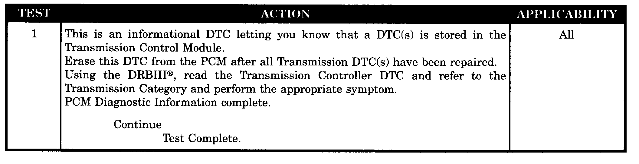

Vehicle responds to throttle in neutral and park. When in drive and reverse it will crawl at 3 mph tops with no ability to move uphill. Very unresponsive to throttle. No slipping or revving.

The code you have is a generic transmission code. You need to get a scanner that can read transmission codes to determine the problem. Take a look at the attached picture.
Once you do this, let me know what you find.

Please understand, this is a guess. Most often, the TCM is the problem or there is a ground issue. Inspect the wiring to make sure something has not rubbed through. Before I would arbitrarily replace the TCM, I would retrieve all codes hidden behind the 700.
Let me know what you find.
