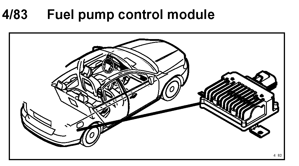

Two months ago my car broke down, engine stalled at could not start. Eventually, after changing the in-tank fuel pump, the problem was resolved by replacing the fuel pressure sensor. Now the same problem recurred, but this time it seems to be the PEM, since all other related parts have been replaced.
The authorized Volvo workshop has discontinued permanently. Does anyone know where the PEM located? I head it was located somewhere around the fuel tank, but could not find it.

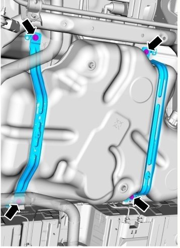

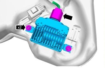

It is located in the right (passenger side) rear of the vehicle. The fuel tank needs removed to access it. See attached picture.
Here are the directions for removal and replacement:
FUEL PUMP DRIVER MODULE
Fuel pump driver module
Operation number: 28411-2
Removal
Note! Removal steps in this procedure may contain installation details.
Remove fuel tank. See: Fuel Tank > Removal and Replacement
Torque: M6, 10 Nm
Installation
To install, reverse the removal procedure.

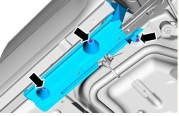

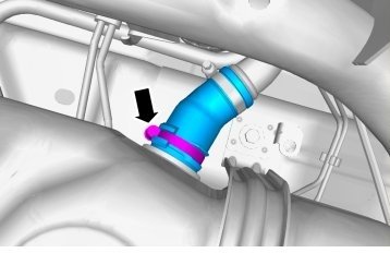

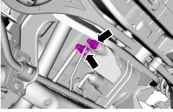

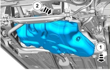

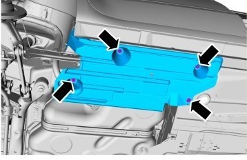

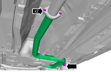

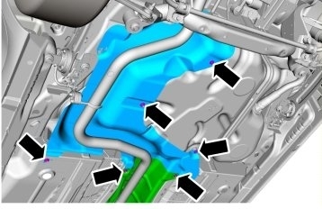

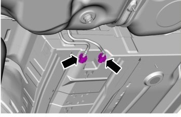

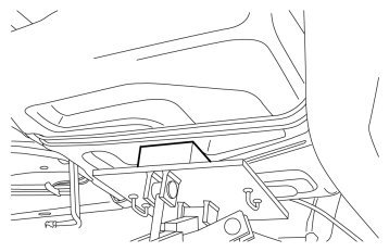

Here are the directions for removal of the fuel tank. Starting with pic 3, all remaining pictures correlate with these directions.
Fuel tank
Operation number: 23412-2
Removal
Follow instructions about safety information gasoline-fuel system Refer to: Safety information gasoline - fuel system, B6304T2, B6324S, B8444S See: Fuel Delivery and Air Induction > Technician Safety Information > Safety Information Gasoline - Fuel System
Perform depressurizing fuel system Refer to: Fuel system pressure release See: Fuel Pressure Release > Procedures > Fuel System Pressure Release
Perform fuel tank draining Refer to: Fuel tank draining, B6324S, TF-80SC See: Fuel Delivery and Air Induction > Procedures > Fuel Tank Draining
Remove rear wheel Refer to: Wheels See: Wheels > Removal and Replacement
Torque: M6, 10 Nm
Torque: M6, 10 Nm
Note! Note the position of the component before removal.
Perform flange joint, assembly Refer to: Flanged joint, assembling See: Exhaust Pipe > Removal and Replacement > Flanged Joint, Assembling
Torque: M8, 24 Nm
Warning! Fuel may still be present in the fuel tank after draining.
Warning! Be prepared to collect escaping fluid.
Caution! Use suitable packing material to prevent damage to the component.
Caution! Make sure that no strain is placed on the fuel lines and wiring harnesses.
Use: Transmission jack.
Torque: M8, 24 Nm
Note! This step requires the aid of another technician.
Installation
