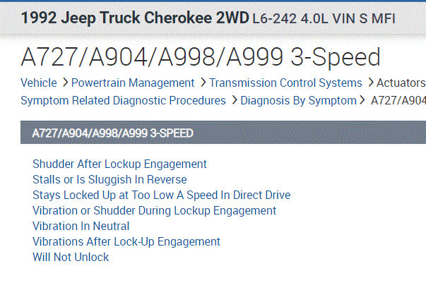

As far as the transmission, in 1992, they didn't. Do me a favor. Take a look at the pic below and let me know what you feel best describes what you experience. Then, I'll take a look into the specifics.
Also, when in drive, does it ever stall, or is it only reverse? I remember an issue where the transmission cooler lines were partially plugged and causing a stall or issues with reverse. It's a thought at this time. Is the transmission fluid clean and full?
See pic below.

Stalls and sluggish in reverse, is the one I would pick.
