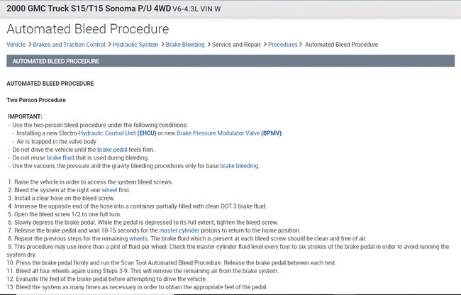

Changed master cylinder, replaced brake lines. Bench bled master cylinder and bled the brakes pedal still goes to the floor.
Sep 5, 2021 at 9:03 AM
  • 110,244 POSTS

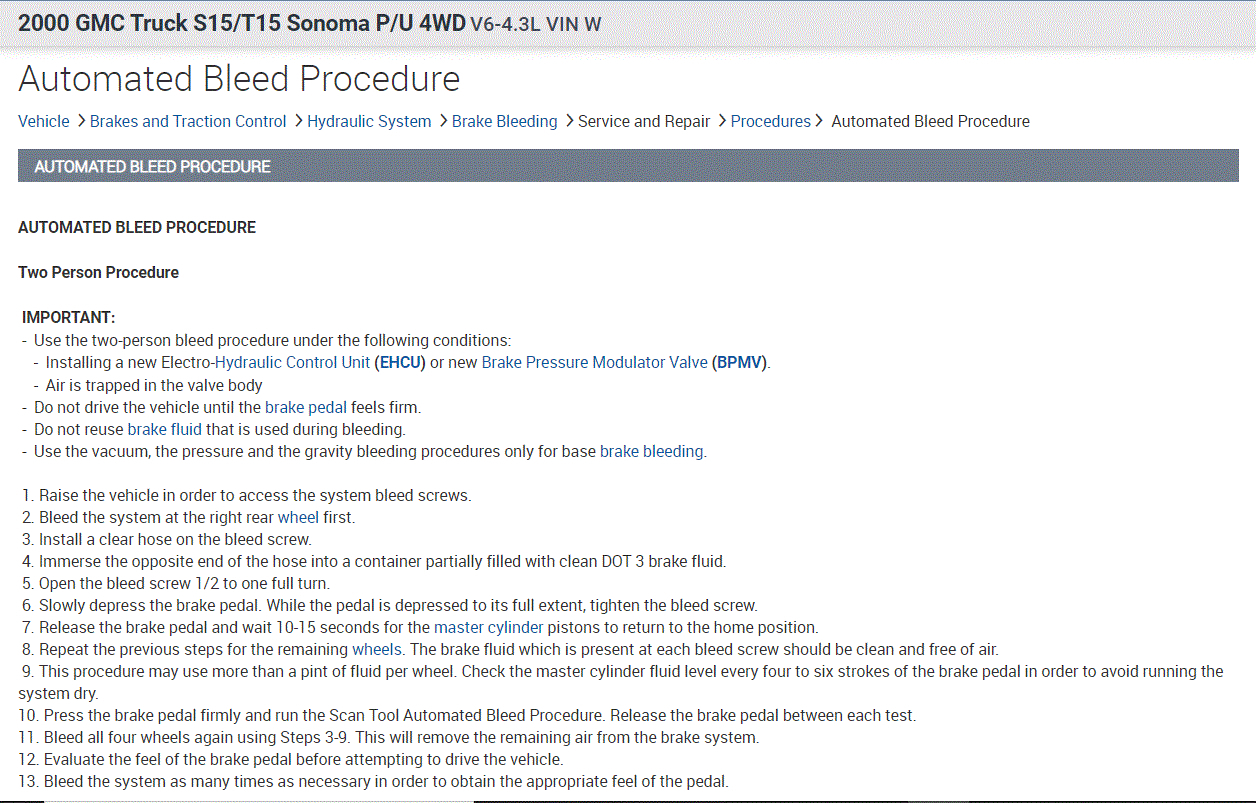

If you bench-bled the new master cylinder and all wheels, chances are air got into the ABS module. What you likely need to do is perform an automated bleed. You will need a scan tool that can perform this procedure.
I attached the directions below. The first part explains to do what you have already done, bleed the brakes. The second part is the automated bleed procedure.
Take a look through this and let me know if you have other questions.
See pic below.
