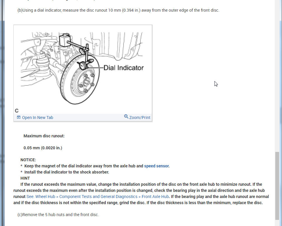

It's not the same pulsation you usually get when the rotors are bad. i have seen this on many Toyotas and Lexus and cannot figure it out. i installed new rotors and brakes and same results. This one here when applying the brakes at the lights to a stop you feel a pulse in the front, steering does not shake, rear brakes also new. i also regreased all the pins and they move freely.
Apr 11, 2021 at 2:55 AM
Just to be clear, the pulsation is felt in the brake pedal or in the floor board?
If the pulsation is in the pedal then I suspect you have excess runout in the hub or rotor.
I attached the process from the manual on how to check this but when you put the rotors on, did you clean the hub with a friction disc of any rust?
If not, then this runout will cause pulsations similar to a warped rotor.
Please review this and let me know what questions you have. Thanks

I am sure it's felt in the brake pedal, and yes i cleaned the hub as much as i can, i always do. but with Toyotas it's almost always never the rotors that are bad. I will check the hub.
Apr 11, 2021 at 12:40 PM
Agreed. If you have a small amount of runout on the hub then that will be amplified as the surface diameter increases.
Let us know what you find. Thanks
