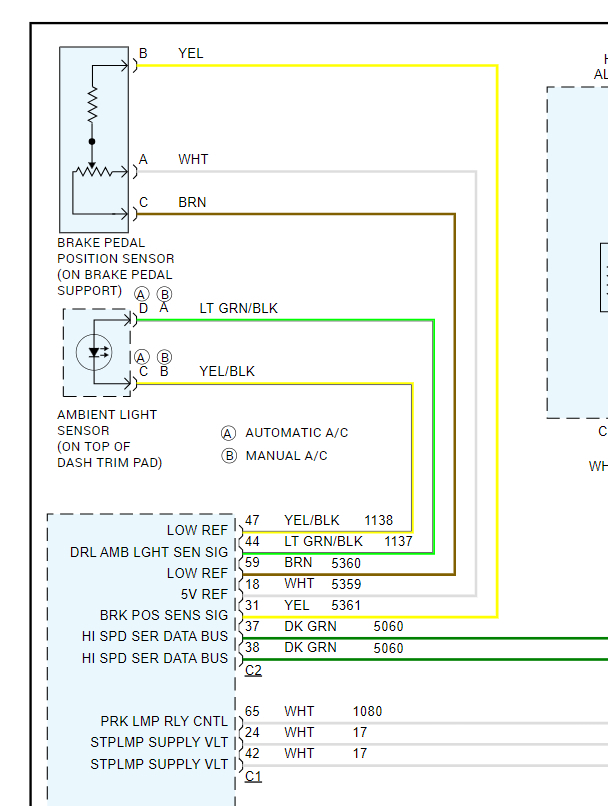

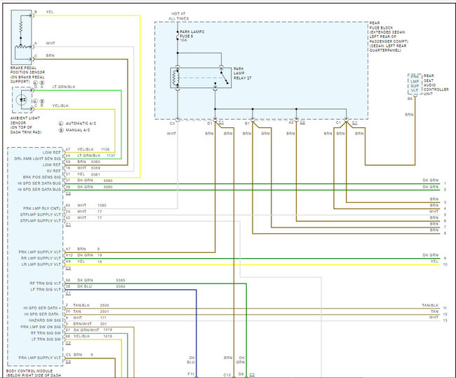

Hi, I need the wiring diagram for the brake light pedal position sensor in my car listed above please.
Apr 2, 2024 at 12:46 PM
  • 55,224 POSTS
Sure, here are the brake light switch wiring diagrams to the BCM. Check out the images (below). Let us know if you need anything else.

Okay, so I wired the switch, and my brake lights are still on when I turn off my head lights, they shut off but then I have none. I don't know what else to do or why that even happens.
Apr 2, 2024 at 9:11 PM
  • 55,224 POSTS
You might need to calibrate the brake light switch, here is how:
BRAKE PEDAL POSITION SENSOR CALIBRATION
CALIBRATION CRITERIA
The brake pedal position sensor (BPPS) receives a low reference signal and a 5-volt reference signal from the BCM. Whenever the brake pedal is applied, the BPPS applies a variable voltage signal to the BCM through the stop lamp switch signal circuit. The BPPS calibration must be performed after the BPPS or body control module (BCM) have been serviced. The calibration procedure will set BPPS home value. This value is used by the BCM to determine the action of the driver applying the brake system and to provide this information to the vehicle subsystems via the class 2 communication bus.
