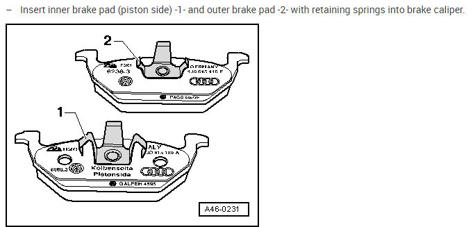

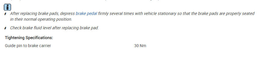

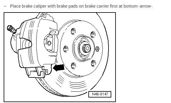

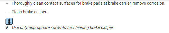

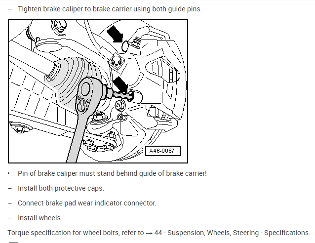

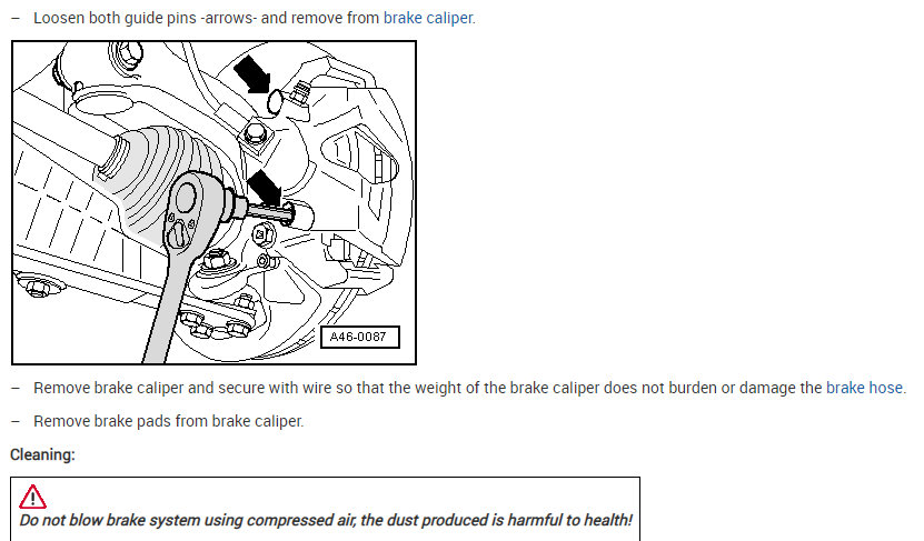

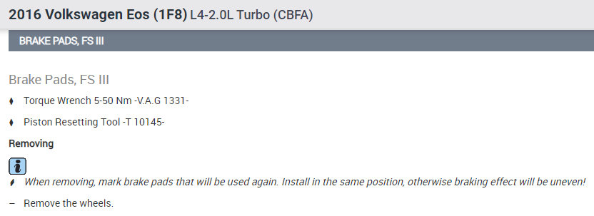

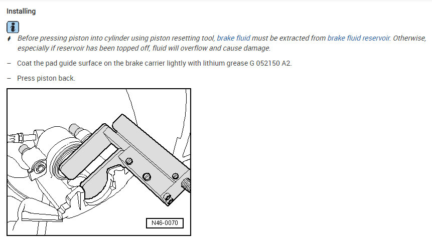

There is about a 1.5" pad protruding my car. That is to say I have no clue how this occurred but I need to replace the brakes
Oct 28, 2019 at 7:01 AM
DANNY L
Experienced Mechanic
5,648 POSTS

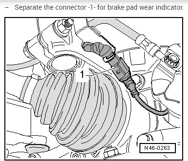

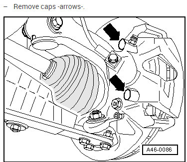

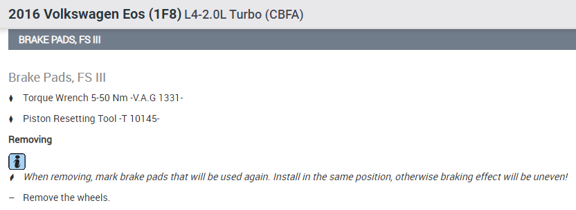

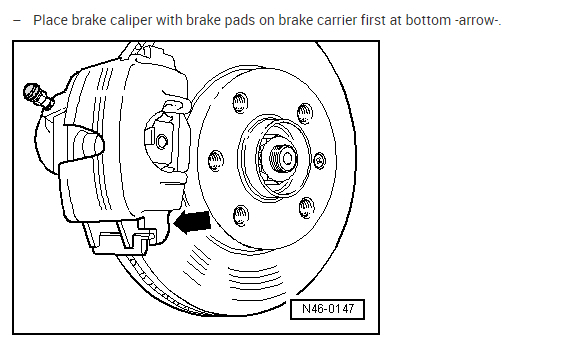

Hello, I'm Danny.
Here is a tutorial for you to view on how to change front brake pads and rotors:
I've attached picture steps below on how to change the front brake pads your vehicle. Hope this helps and thanks for using 2CarPros.
