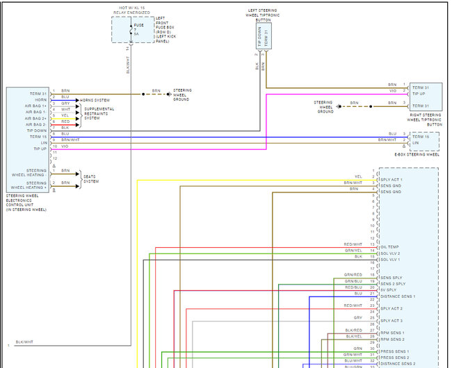

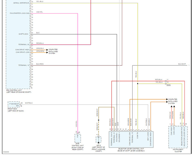

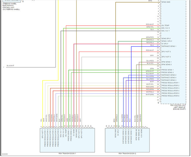

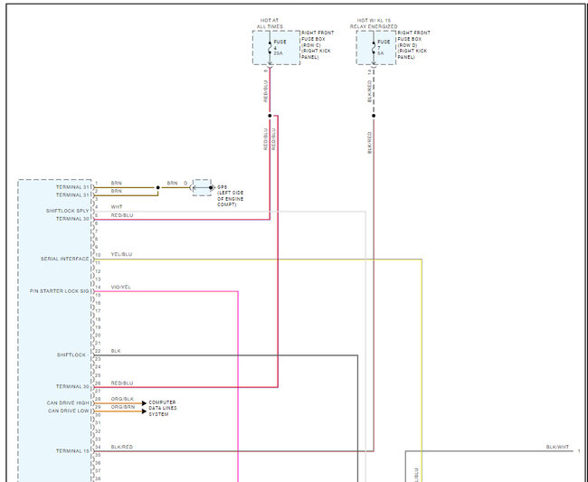

To me it sounds like you have a selector lever control unit that got wet or is shorted out which have seen before. Here is the transmission wiring diagrams so you can see how the system works. Check out the images (below). Please upload pictures or videos in your response of any problems so we can see what to help you with.

I tried using those wire diagrams to test for short circuiting wire coming to the Transmission Control Module (TCM). However, it seems like those diagrams are incorrect.

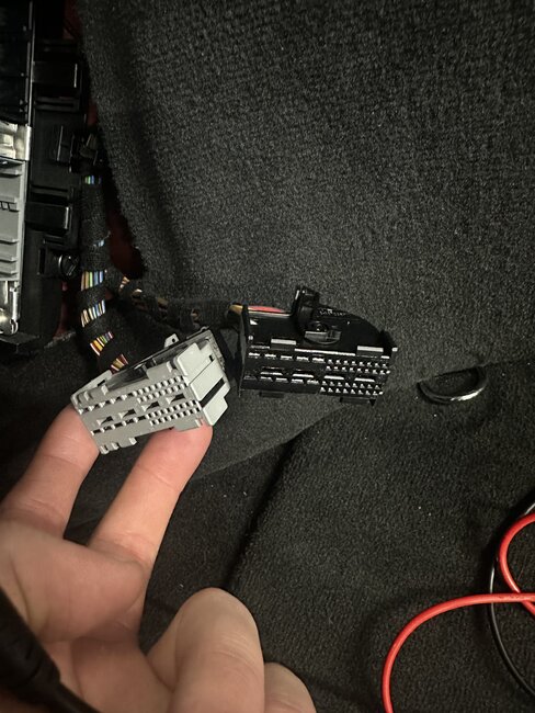

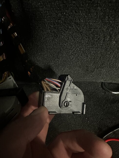

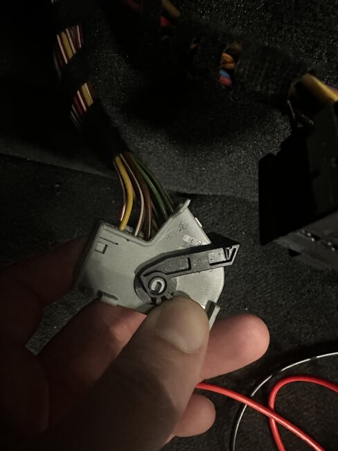

I have 2 plugs that go into the TCM, grey and black one. I'll attach some images of them.
The grey plug has no pins with any active voltage.
The black plug has:
pin 14 w/ 4.8v
pin 26 w/ 12v
pin 28 w/ 2.3v
pin 29 w/ 2.8v
According to those diagrams, there should be 5v in pin 13, and 8.5v in pin 3. At least that's how I'm understanding it. Could you double check that the diagram is for a 2018 Cayman S please?

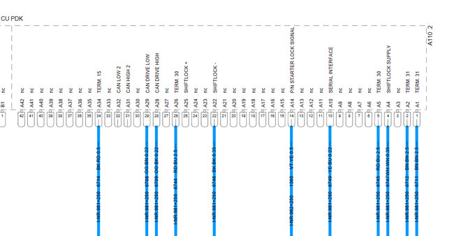

The wiring provided by my colleague seems correct, below is the pin out for the black connector.
You appear to be missing 12V ignition feed at pin A34, black/red wire.
This is fed by fuse F7(5A) in front right fuse block, row D.
Your voltage readings:
The black plug has:
pin 14 w/ 4.8v - starter lock signal from DME, violet/yellow wire
pin 26 w/ 12v - constant 12V, red/blue wire, should also supply pin A5. Supply from fuse F4(25A) in front right fuse block, row C
pin 28 w/ 2.3v - CAN bus low, correct
pin 29 w/ 2.8v - CAN bus high, correct
The grey connector supplies the transmission valves/solenoids.
Disconnected there will be no voltage feedback as the supply is missing from pins B2, B18 and B25.
Cheers, Boris
