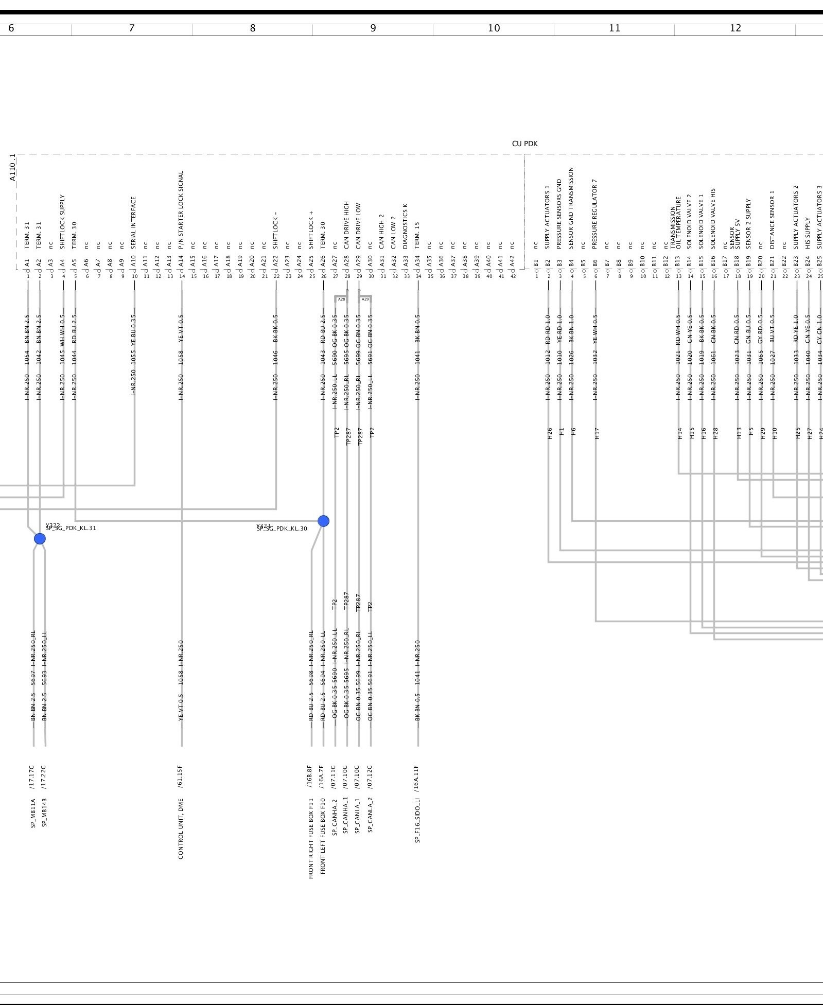

I have the car listed above 4S. One morning I got my car not moving and a failure alert of gearbox (PDK) then I took the car to my mechanical and after diagnosing the car using PIWIS we found the default P1731 and P1732. Now after buying another gearbox we got again the same default even after re-setting it and adapting the new gearbox. Please can you help me with any advice ?
Thanks
Mar 15, 2018 at 5:07 AM
STEVE W.
  • 15,344 POSTS
You changed the actual gearbox itself, not the PDK control unit under the dash, correct?
Having two sensor codes at the same time I would check the harness from the control unit out to the gearbox. They use a low voltage and it wouldn't take much corrosion or pin fitment to cause a failure. I would also verify the signal from both displacement (1 & 2 as you have codes for both) sensors outside the gearbox. This should help you locate the correct wires. Also be sure the shop is using the latest version (or at least version 2) of PIWIS, the older versions don't work well on the newer vehicles.
Mar 15, 2018 at 8:40 AM
YACINE
  • 10 POSTS
Hello Steve, thank you for your answer.
Actually we changed only the pdk gearbox not its Control Unit.
Because before bying the new gearbox we have checked the Control unit and it was dry and clean. We also checked and cleaned the harness.
We thought that the sensors p1731 and p1732 are inside the gearbox and we couldn't reach them. Where can we find the two sensors ?
Do you think that it can be related to the control unit ? Should I change it ?
Thank you a lot

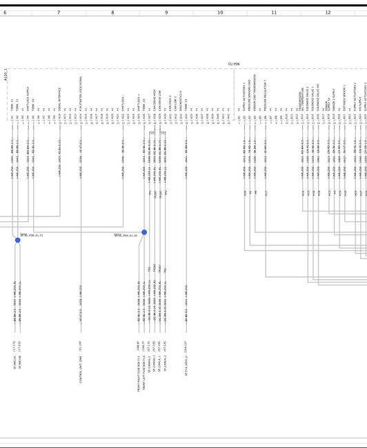

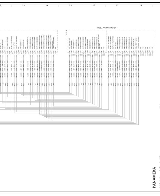

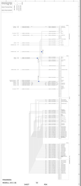

Kindly send me again the image in good resolution because it’s too small and not clear. Thank you very much
Mar 16, 2018 at 2:00 AM
STEVE W.
  • 15,344 POSTS

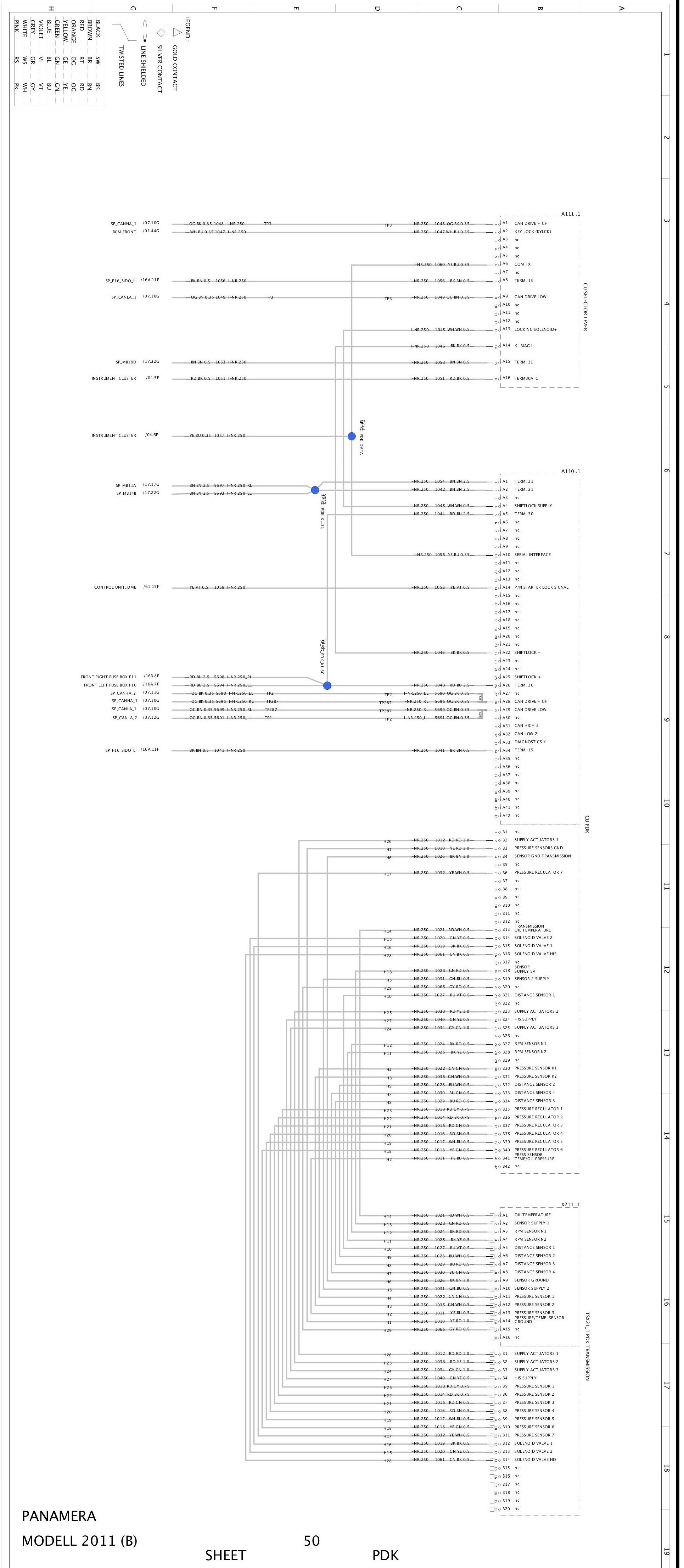

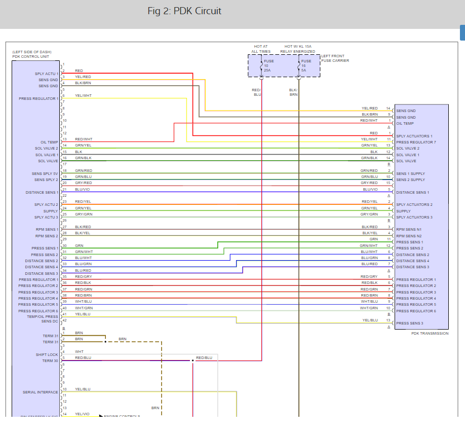

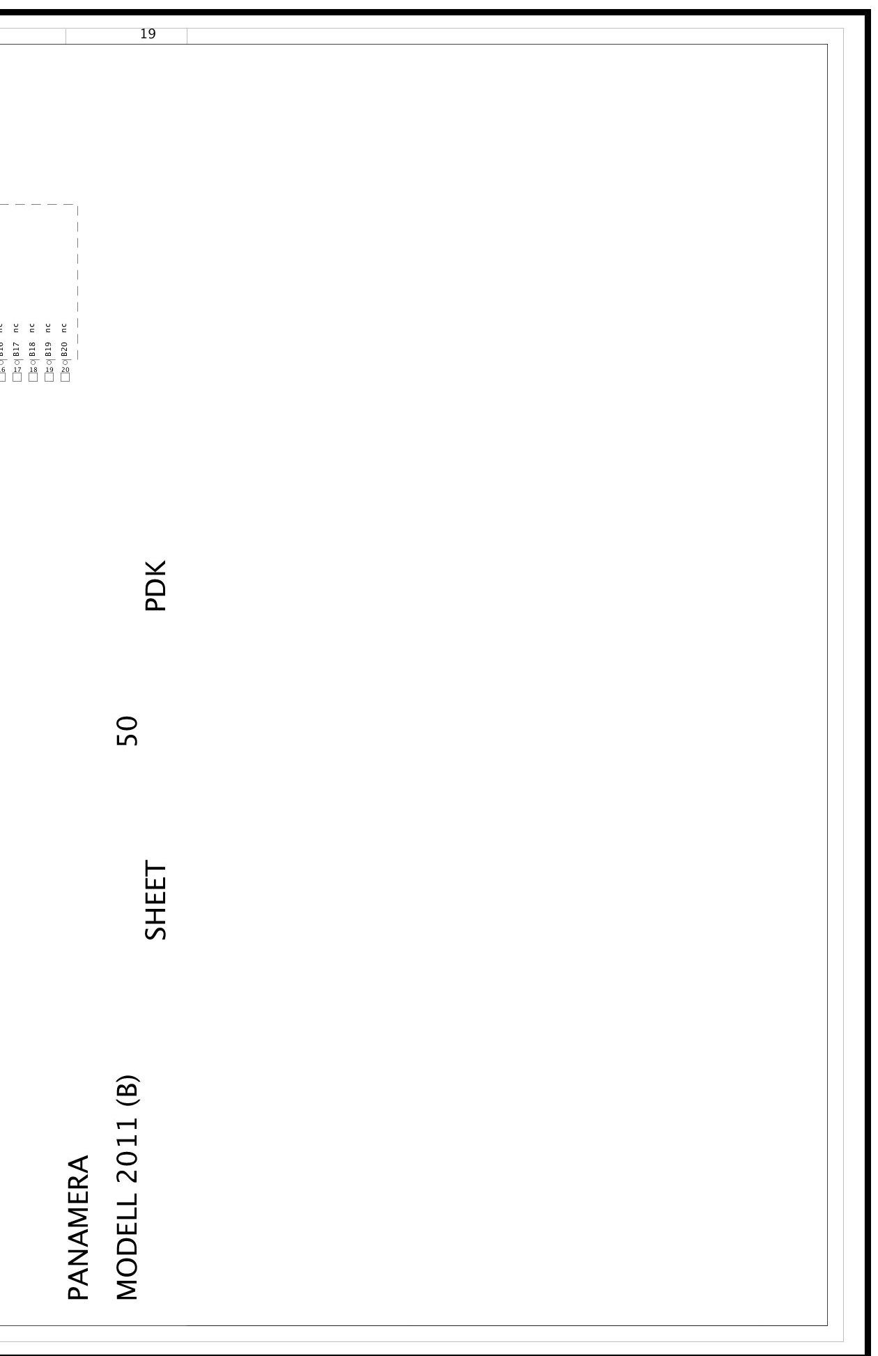

HMM, that should have been a large diagram. Something must have messed up the upload. Try these.
Mar 16, 2018 at 2:20 AM
YACINE
  • 10 POSTS
Thank you sir. I ordered the pdk control unit today. I hope it will fix the issue.

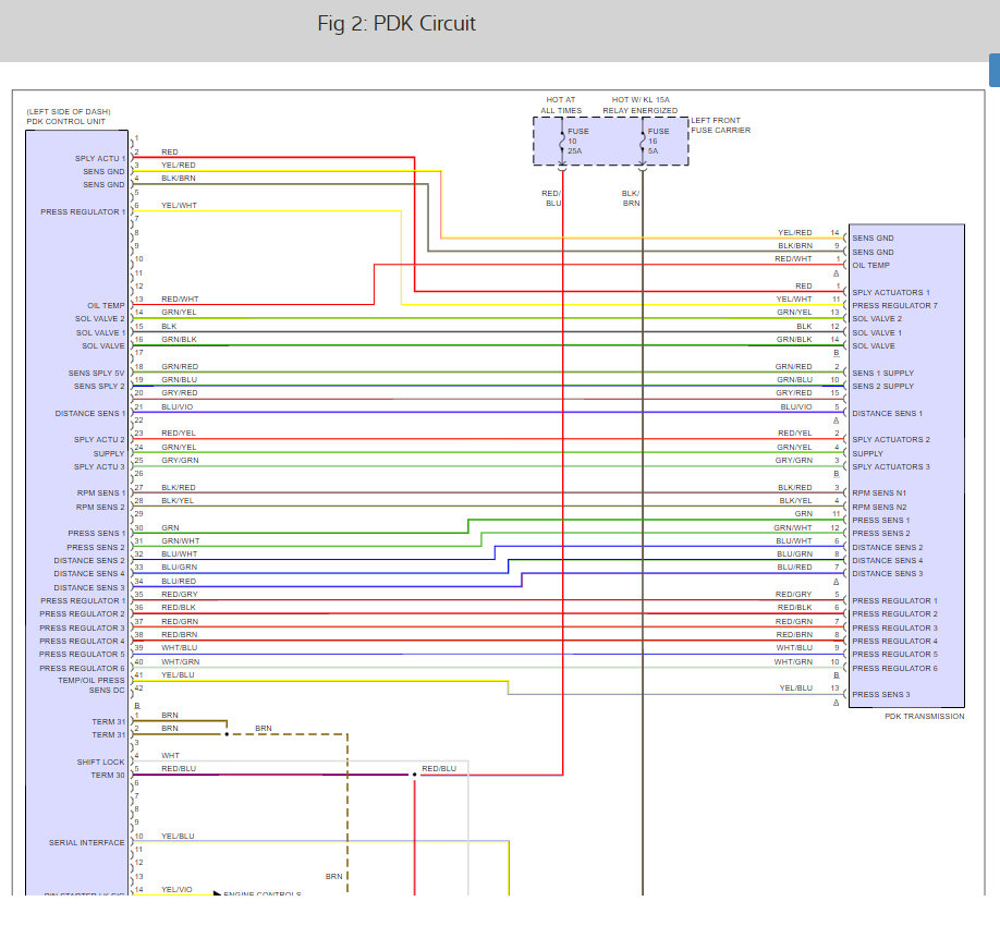

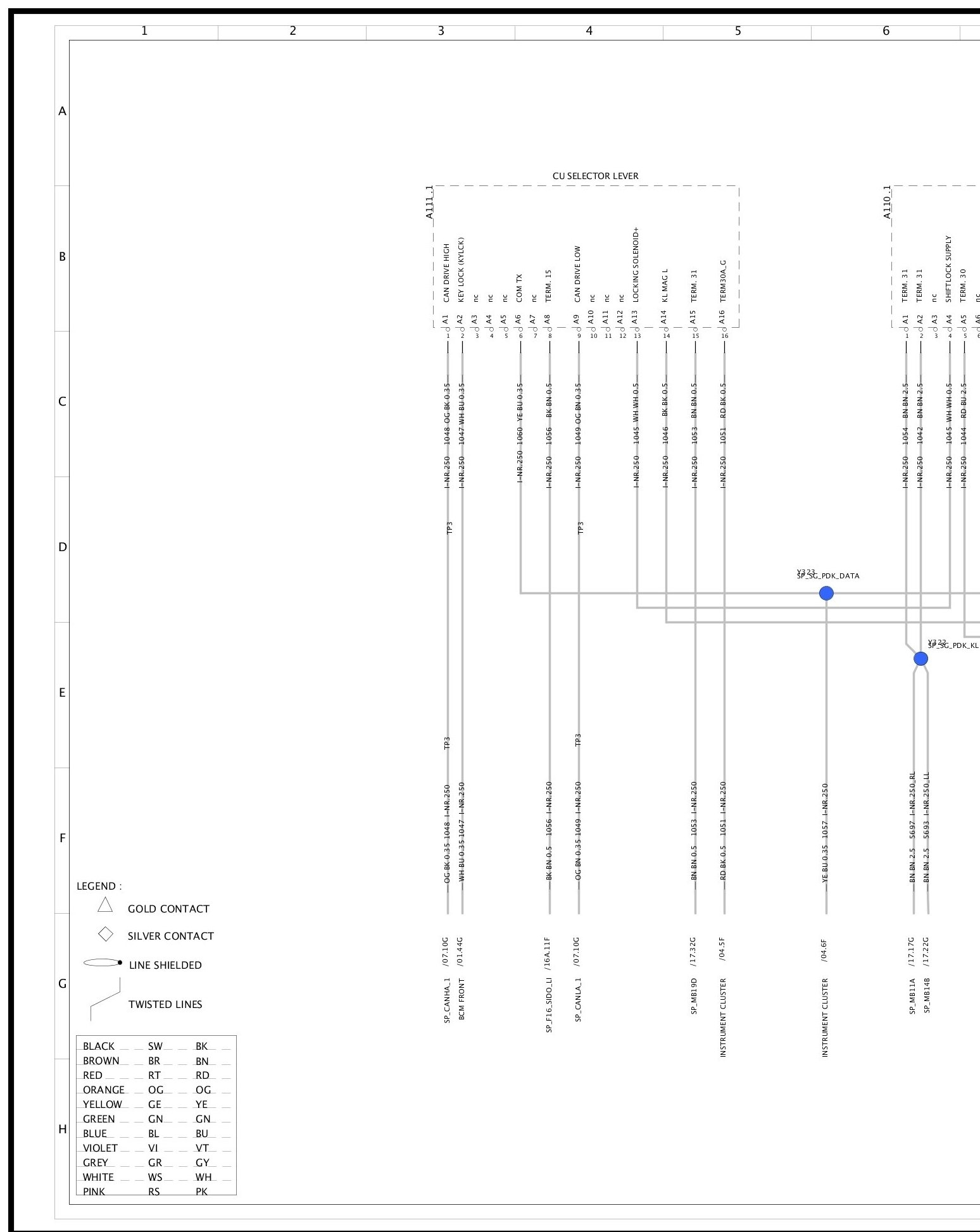

I found these wiring diagrams and wanted to help.
Check out the transmission wiring diagrams (Below)
Mar 19, 2018 at 5:18 AM

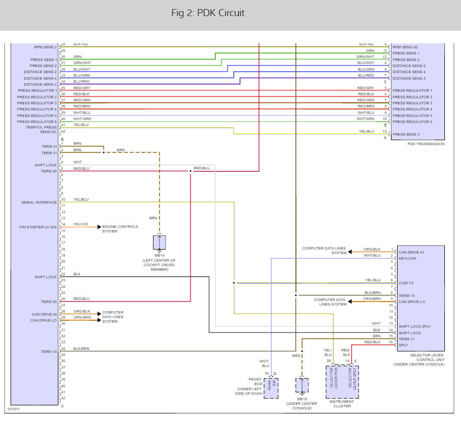

Now after changing the pdk control unit the error p1731 and p1732 have been fixed but we have new errors that we never got : P0846, U0446 and U0456. Guys, help me by any advice please thanks.
Apr 10, 2018 at 8:02 PM
STEVE W.
  • 15,344 POSTS
P0846 - Pressure sensor clutch 2, signal implausible - Shorted to bat + That would be the Green/White wire on pin 12 from the transmission to the PDK unit. It is reading above 4 volts. Either the wire is shorted to another power wire or the sensor itself is bad.
The U codes are CAN related
U0446 - Body control module - invalid data
U0456 - Coolant temperature control module - invalid data
I would clear the U codes and see if they return. Both could be caused by having the battery disconnected. Or the coolant temp sensor is disconnected.

Steve, is the sensor changeable ?
Apr 12, 2018 at 2:51 AM
STEVE W.
  • 15,344 POSTS
Both information sources say they can be, BUT you will want to test the wiring first. The internal harness in the trans connecting the pressure sensors to the plug may be the problem. Says you pull the pan and the pressure sensors are inside screwed into the trans. You still have the old unit right? Maybe pull it open and check.

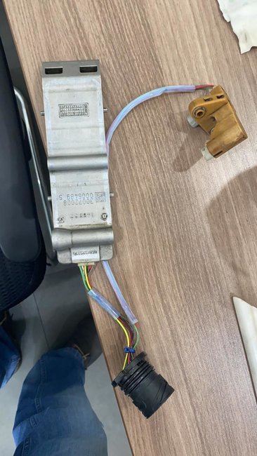

Dear Steve and all. Thank you for all of your input. I have a 2010 Panamera 4s with 37 K Kilometers. As I was cruising down the highway I switched to Sports mode and got the "Fault Transmission" , "Check Engine" appeared on the dash. The car would not shift out of 2nd gear and had it towed to the dealership. It's been there for over 2-weeks and they are saying that they will start by replacing the pressure sensor of the transmission. If that does not work they will replace the gear box casing, and if that does not work then they will replace the gear box. I am out of warranty and extremely frustrated. Please advise if I should proceed in replacing the pressure sensor. Thanks for your feedback.
Apr 5, 2020 at 10:58 PM
STEVE W.
  • 15,344 POSTS
Do you know what the codes that were stored are? The lights indicate that there are codes stored. That would give an idea of what the computer thinks is wrong.

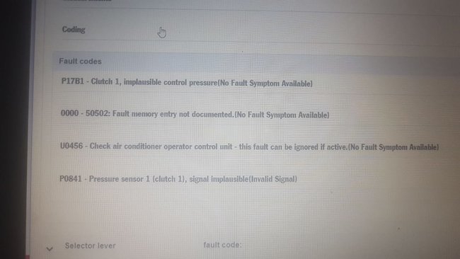

Thanks for your support. I have attached the error codes as sent to me through the Porsche Dealership. I went ahead and ordered a new pressure sensor that should arrive today. I look forward to your feedback. Thanks again.
Apr 12, 2020 at 10:37 PM
STEVE W.
  • 15,344 POSTS
With those codes it could be the sensor giving a bad reading easy enough. Testing is to see if the wiring is shorted to ground or if it's open. If neither of those is the issue then it is most likely the sensor.

Hi Steve. The dealership have replaced the pressure sensor and have tested it for 65 kilometers. So far the error did not reappear. I am cautiously optimistic that the problem has been resolved. Thanks again for yours and Ken's support you guided me to be on the right track. Much appreciated.
Apr 13, 2020 at 9:28 PM
STEVE W.
  • 15,344 POSTS
Good to hear. The test for that sensor runs when you turn on the key and is a continuous monitor with the engine running. I would say it should be fixed if it didn't set the code really quick.

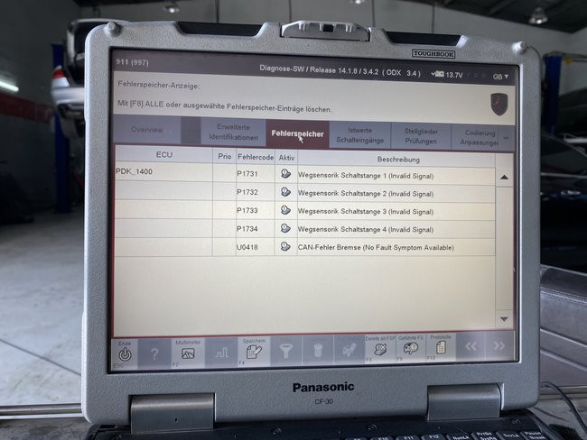

I am really tired from this car / Porsche Carrera s 2009 ( 997 )
I have the fault P1731,P1732,P1733 and P1734.
I replaced the pdk control unit brand new.
The distance sensors.
And I tried also to replace the full transmission from another car which is was working fine but nothing was useful!
I made test for the signals from the pdk and the gear .
And from the pdk control to the engine control unit and everything is fine.
I don’t know what I have to do. please help me.
Jul 22, 2020 at 8:38 PM
  • 55,399 POSTS
The u4018 code concerns me. lets do a CAN scan to see what comes up. Here is a video to show you how:
