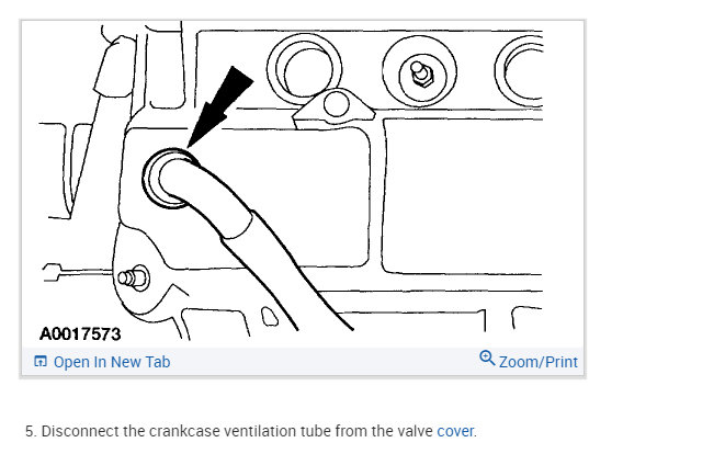

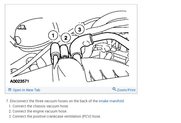

You will have a tube coming off each valve cover that should be routed to the back of the manifold. I attached the pictures for this. Take a look at this and let me know if you have questions.

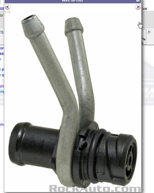

To replace them, you simply pull the tube out and you will have the valve. I attached the picture of the valve which shows that it twists into it mount so you will need to twist this to remove it.
