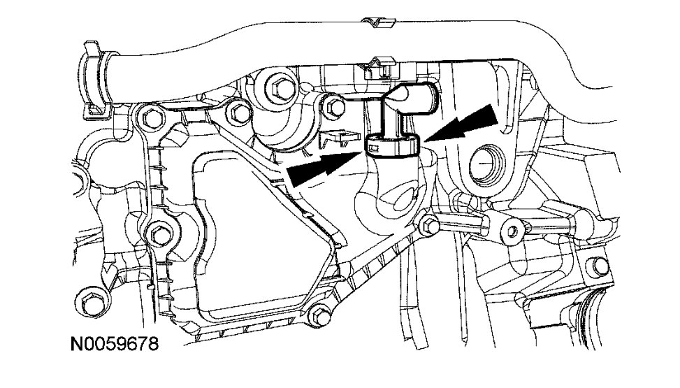

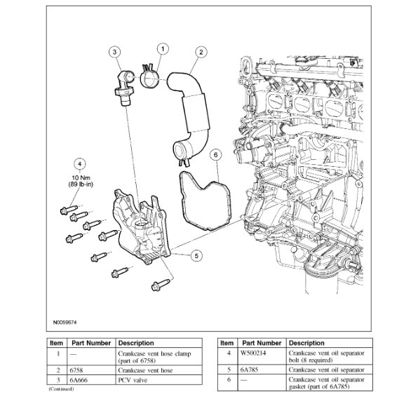

My Haynes manual states to follow directions for removing the intake manifold. I know that is where the PCV valve is located on this vehicle, but my question is, the first step to taking off the intake manifold is to depressurize the fuel system, is this necessary since I will remove the fuel rail, pressure regulator, and injectors as a single assembly?
Feb 19, 2019 at 8:36 PM
Good morning,
Yes, the intake has to be removed.
My question is, why are you replacing the PCV? This is not a normal failure.
Removal and Installation
1. Remove the intake manifold.
2. Depress the 2 release tabs and remove the PCV valve.
