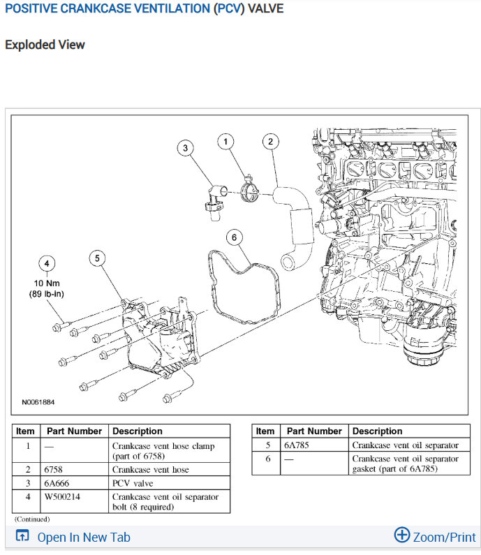

Hi, where is my PCV valve located? Ford Escape/Mercury Mariner Hybrid.
Thanks in advance.
Jun 17, 2025 at 4:12 AM
  • 54,837 POSTS
The PCV valve is below the coolant pipe on the right side on the engine, check out the images (below). Let us know if you need anything else.
