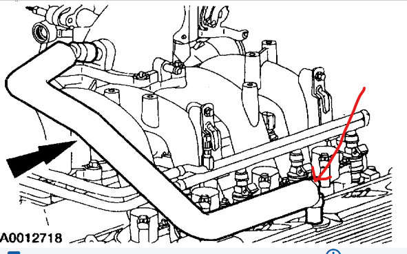

I need to change the PCV valve on my car. I have no idea where it's at. I have found videos saying its on one side and others saying its on the other side. could you please help me with a diagram of my engine and where the piece is. Pretty please

Sure, I am here to help you, the PCV valve is on the right valve cover. Check out the images (below). Let us know if you need anything else.
