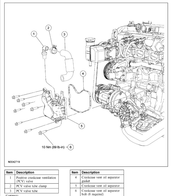

Pcv Valve location and replacement
Aug 1, 2025 at 4:49 AM
Experienced Mechanic
55,580 POSTS
Yes, the PCV is a little bit difficult to get to, it is on the left side of the engine below the manifold. Check out the images (below). Let us know if you need anything else.
