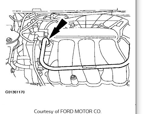

I need to change the PCV valve on my car, unfortunately I'm not able to find it. I am not a pro.

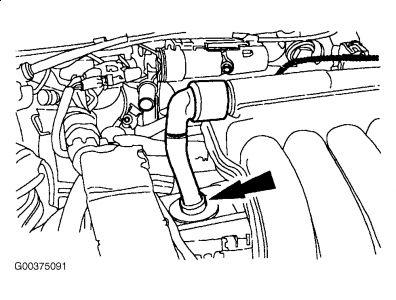

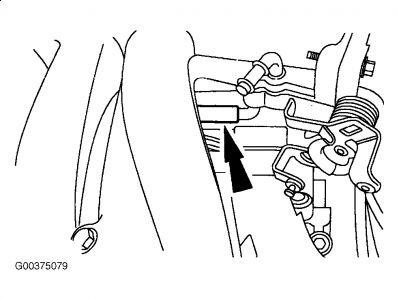

The PCV valve is located in the valve cover. Check out the diagrams (below). Please let us know if you need anything else to get the problem fixed.
Image (Click to enlarge)

Where is the PCV valve located on a 3.0L V6?

Where is the PCV Valve located?

Top middle of the engine towards the firewall.
