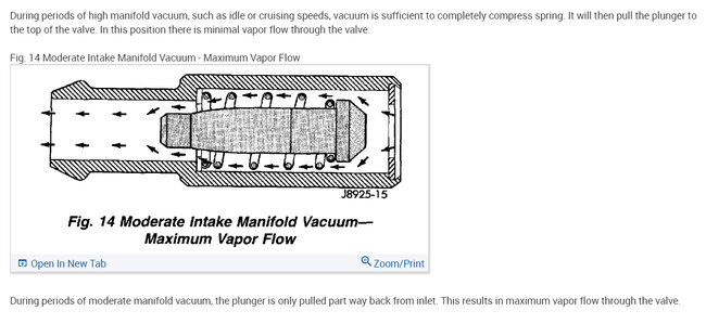

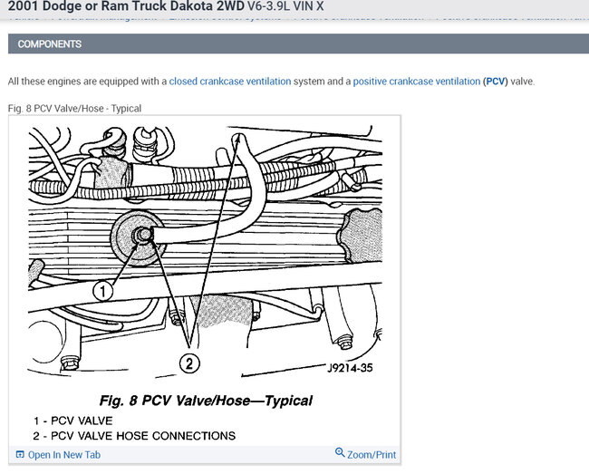

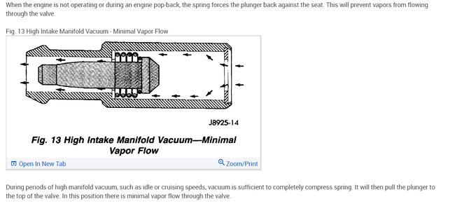

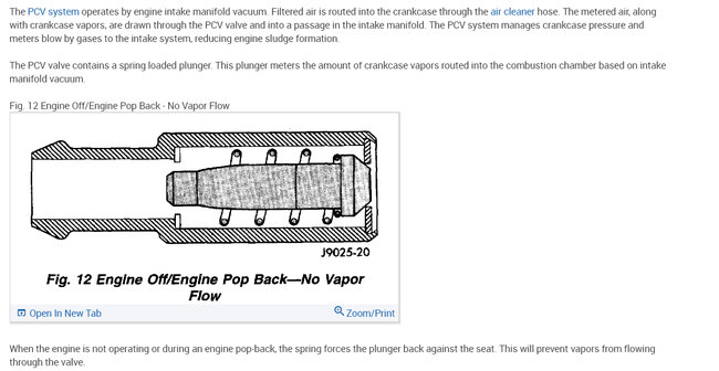

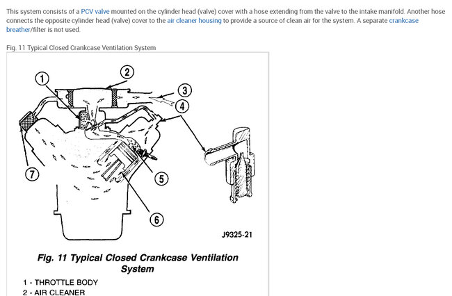

Yes, the PCV valve can stick open and the engine to burn oil. I believe the second part you mentioned will work, I would match the parts up and if they look the same you should be okay. Here is the location of the PCV and how it works. Check out the images below. Let us know if you need anything else, please.
